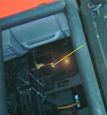

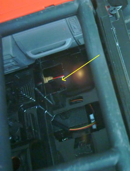

After some brainstorming, I thought I'd take a stab at rear dig. I am currently running stock electronics, there for I do not have any way to put a servo in operation, but I followed yaleforscale's advice and made my own rear dig. I began by removing the body, then proceeded to cut the brown wire and strip it. I had a 20amp automotive on/off switch out in the garage but the same switch at Auto Zone is $4.00. Make sure you don't grab a momentary switch. I knew I might want to be able to remove this switch so instead of soldering straight to the blade terminals on the switch, I also had some female type wire connectors in the garage that fit well on the terminals. I proceeded to solder these on both ends of the brown wire. (Just a quick note, these connectors were for larger gauge wire so I had to crimp them down on the wire instead of just twist in.) I then decided to mount the switch on the outside of the truck but not to detract from the overall look and appearance. I drilled a hole in the fender well, placed the switch in the hole, and tightened the plastic nut that came with the switch on the outside. I had to flip the switch over because I wanted the "On" or rear motor running to be in the up position and when I engage rear dig to be in the down or rear motor "Off". The installation was not hard at all and took me close to an hour, but that's because I suck at soldering. To truly see if I had accomplished anything, I placed the truck in my living room with juice to both motors, cut the wheel and hit the gas. I didn't measure it, but it's probably about an 8 foot circle to get this thing turned all the way around, which by the way required me to back up twice because of furniture. Round two, I flipped the switch down to engage the rear dig and pretty much cut my turning radius in half. Overall, I am am totally satisfied with this modification. The downside is not being able to control it from a distance but actually having to touch the truck to actuate it and the fact that the front motor has to work that much harder to pull the trucks weight on flat ground. As I said before, I am not running hobby grade hardware, so I am not able to work with a servo yet; but the upgrade is on my list. Here are a few photos to go with this modification: First, what you will need, then the wired switch followed by the installed switch in the up position and in the down position with the body installed. Enjoy, there will be more to come on my mods!

Sorry for the glare/blur. I never claimed to be good at taking phographs.

Creepy Crawler ..
Good work on this switch ..
It is true that an ESC system would be preferable to control the switch, at a distance ..
But this is a good start ..
I have the same problem with the switch / winch .. I activated manually ..
The wire is ready for (( ESC ))
Thank for the pics ..
