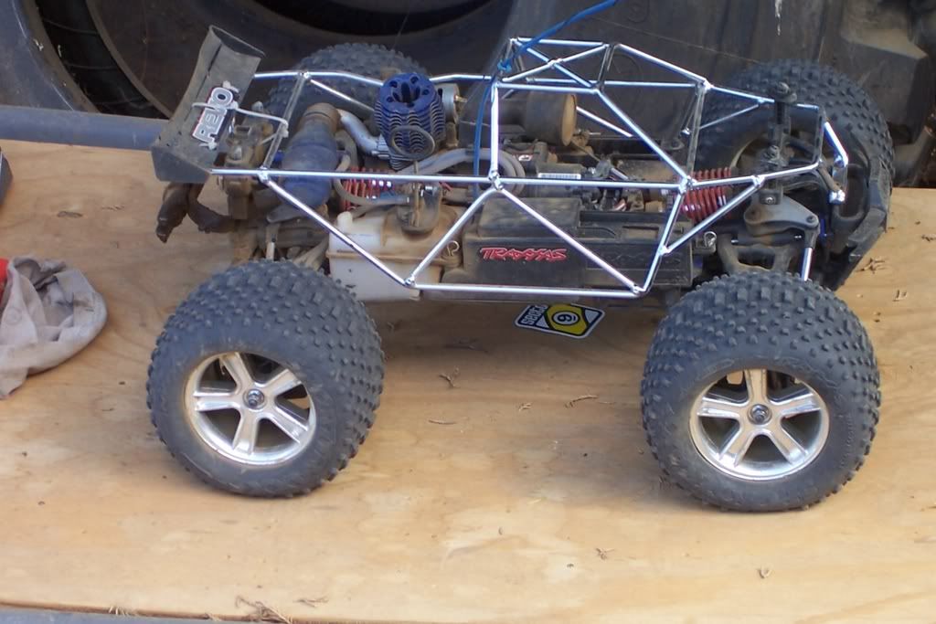

heres an old pic:

in that last pic i cannot see wires for the ez start? whats up with that? How much was the roolcage, and do you like/reccomend it? I'm off to work now (Underwater ceramics technician. aka Dishwasher at mum's cafe) I'll be back on later
RE: OFFICIAL REVO THREAD- EVERYTHING REVO
The e-z start isnt so e-z any more. The female end on the little want thingy that you use to start it got all messed up, so instead of spending 15 bux on a new one i just ripped all the wires off(not literally ripped but just removed) and took the tamya end off my stick pack and touch the two battery ends to the motor, i have a glow igniter for my x-cellerator so i just use that to ignite the glow plug and blam! Im runnun' my revo. As for the cage they are 70 bux. But i got mine on sale for 40. if i hadnt found it on sale i still would have bought it. It gets the car a little more dirty with no body but who cares its a monster truck. Also i go through a body a month so i saved money in the long run. I put in a FOC in it, not a huge power gain but a little more bottom end grunt. I also installed a close ratio gear kit, that gives it alot of bottom end and gets it up to top speed very guickly. As for suspention i have 80 wt shock oil front and rear, and LT springs. The sprttraxx tires work wonders in the dirt, pro line bow ties are better but i traded a xtm .18 starter shaft for them, who could beat that? As for radio gear its stock. I plan on going to single steering servos and a better radio system. LOL i got asked about my cage and starter and went onm about the whole truck. oh well now theres not as many questions to be asked. Enjoy.
