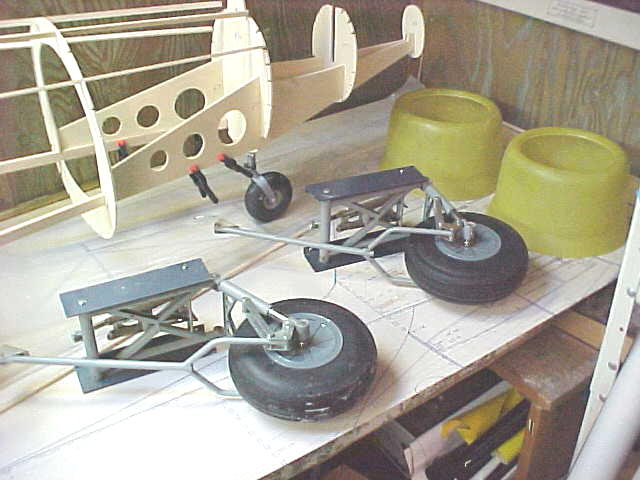

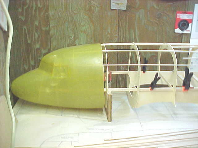

It takes up all my building table space at 99".This is from a Precision Cut kit which fits together nicely.At this stage I have'nt glued any parts yet.

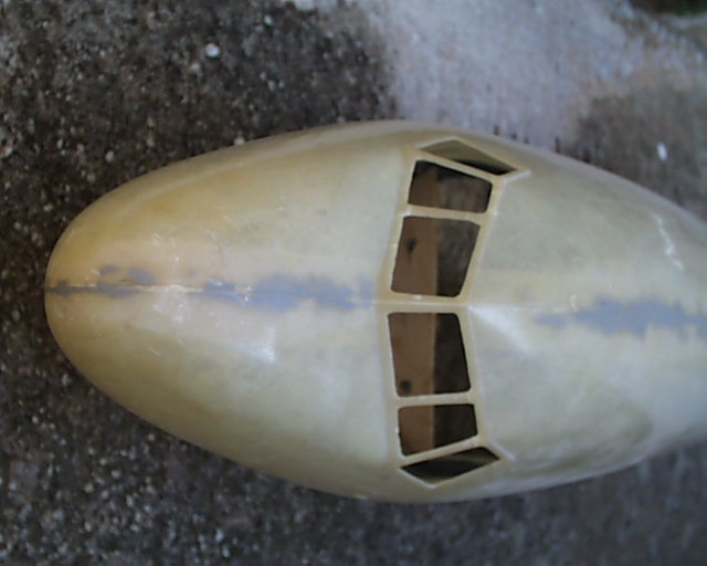

Now I am enclosing some photos of the fiberglass fuse I have.

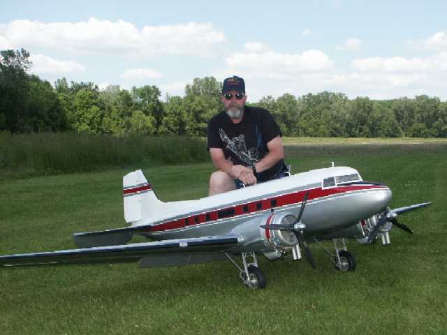

Here is a picture of my good buddies recently finished and flown DC3. Power is a pair of BME 44s - weight is 44 pounds, including 4 pounds of nose weight. The BMEs are wonderful - I will use a pair of 50s when I build my big B25. This picture is before he finished the graphics - the plane is modeled after the Classic Express N103NA. If you do a search, you can find several pictures of the full scale - and it looks exactly like Larry's finished plane.
Dan

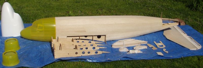

I have a semi completed DC-3 hanging in the garage that I would love to finish, but not sure if that will happen... Course, if someone needs it more than me, I could be persuaded!!!!
Here's how it looks...
