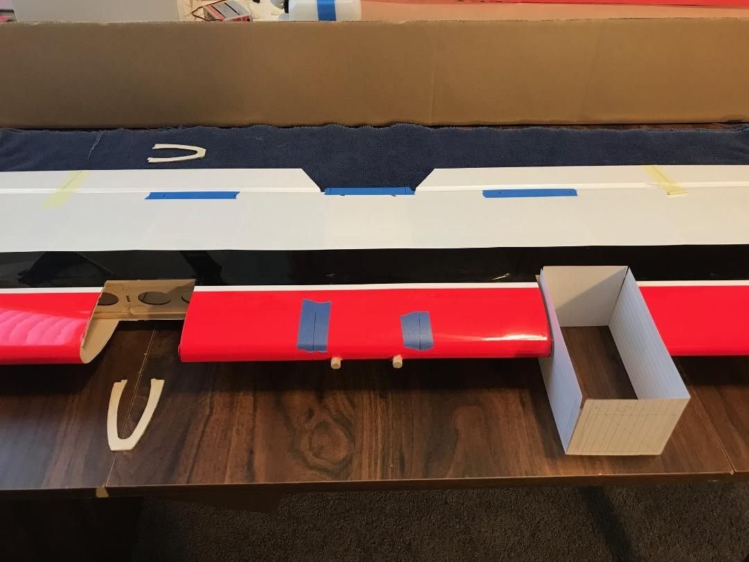

I have been reading this forum for a while, Thank You all for the posts and information.
I had started my Top Flite DC-3 a couple years ago, but it has continually been delayed due to Life.. However, I realized there is sage advice here with starting on a sport plane before I try to fly my scale twin.
Therefore, I'm taking the two Saito FA-40a's I have ready for the future C-53 and putting them onto a sport airplane. Since the Twin Stick is gone from the books, I went looking for another ARF to bash. Thought about the HobbiStar 60 Sport Utility Twin bash and also looked into the Big Stick 60, but you cannot find those any longer.
Then I saw the Ultra Stick Lite bash by ExperimentalAviator and decided to jump on into my own bash.
The 'new' Ultra Stick 10 cc has a little shorter wing than the Big Stick did and it is set up as a taildragger, where I do know that good advice has been offered to start with tricycle gear. However, It had a couple of benefits such as split flaps and a larger rudder already built into the airframe. Since I want to use this as my step into the DC-3 project, I wanted to have the flaps and taildragger as part of the setup, so we're giving this a try.
I broke the Saito engines in on test stands the last couple of weeks. I did get the chance to run them side-by-side and boy do they sound sweet together. I'm using 11X5 props on them and they each peaked around 10K RPM. I'm planning that my operating max will be right around 9,500 rpm.
Then I went ahead and made the final commitment to bashing the ARF - I measured and marked the wing for the cutouts.
Marked up and sheeting removed.
Cutouts complete, Rib tip salvaged and the paper box for planning.
I decided not to go between two ribs because that was going to push the nacelles too far out on the wing for my comfort. The second photo shows the rib tip I saved. I'll install that tip back into the final cutout and just have to make one more rib tip out of balsa for the other side; just to provide some support for the sheeting and a little more 'grab' for the nacelles.
The paper box was based on my firewall size and the length adjusted to fit the fuel tanks. They are a little longer and place the engines a little farther forward then I wanted, but I decided that keeping the spars in tact and mounting everything forward just fit better than trying to hang the nacelle under the wing (which I also drew out).
Hope to have a few more things completed this weekend.

The photos below include a quick catch up on the final location of the electronics for balance at the recommended 4-1/2 inches. The switch was not mounted yet, because I put her on the balance/CG machine one more time before I drilled the hole through the fuselage.
I spent the rest if the evening outside with the twin on a run-up table working on checking the high-speed needles and setting the low-speed needles. I got everything close, but was having some bubbles show up in the right engine. So I called it a day and replaced the internal fuel pickup line in that tank.
The next morning I spent about two hours setting up the throttle curves to match. Idle at 2,500, mid-stick at 6,000 and full about 9,500-9,700. I also went through the curve and matched the remaining points/rpm (7-point curves) through the stick movement.
The maiden flight went pretty well.. I had someone there to help hold the plane for startup, checking the throttle setting/rpm and to check the engines holding the plane straight up. No lean run aiming straight up, but I did end up seeing some bubbles in that orientation.. I think there is possibly some vibration or cavitation going on at the max throttle. I don't see any bubbles before full throttle. And, I don't see bubbles when the plane is level at full throttle (most of the time).. I'll keep looking at that.
taking off she did not track straight by any means.. I definitely had to keep working the rudder both directions to keep the plane going close to the center of the runway.. Ok, I was actually using more like 2/3 of the runway width for my take off runs [laugh].. In flight only took a couple clicks of aileron to keep the wings level.. However it did take several clicks of up elevator..
She is NOT overpowered by any means [laugh].. She will fly, but it is going to be a very "scale" flying plane.. Most of the flight is at 3/4 throttle and she will loop from level at full throttle.. Definitely a little heavy; the loop looks more like a 'Figure 9'...
Back on the ground I adjusted the control linkages to re-center the servos. The elevator sits up about 3/16-inch to provide level flight. However, inverted it just needs a little down elevator to fly level.. Not too bad for a 'scale' flying airplane..
After the three flights; I'm pretty happy with how the plane is flying. It was meant to teach me how to fly the future DC-3 (C-53) project; and it should do that well.
The last couple of photos are at the flying site After the first flight was done - Proof of Life [laugh]..

I've been flying the Twin Stick for a while.. Still want to add a gyro onto the rudder just to figure out how it will work on the DC-3 project.
I can't say this is my "favorite" flying plane. It definitely takes a different touch.
Into a turn and she starts to drop the nose very fast, you must be ready on the elevator right away.
The plane seems very 'pitchy' in flight. I'm slightly nose heavy and have just a little up elevator to keep it flying level at 3/4 throttle. However, it just feels sensitive on the elevator.
I was originally planning to hang the engines under the wing with the nacelles, but went with the direct mount instead.
I wonder if moving the engine thrust line up to the center of the wing has changed the aerodynamics across the horizontal stab and elevator. For example; the Sweet-N-Low Stik moves the horizontal stab to on top of the fuselage when the wing is on the bottom (compared to the regular Sweet Stik). Therefore, I'm wondering if I'm getting bad air from the wing and the lower position of the stab is not optimal.
I'm not planning to modify this plane just for the feel. I'll keep flying her until the DC-3 is ready for the engines.
But, if someone wants to try this in the future - you may want to hang the engines back down to the original thrust line.
