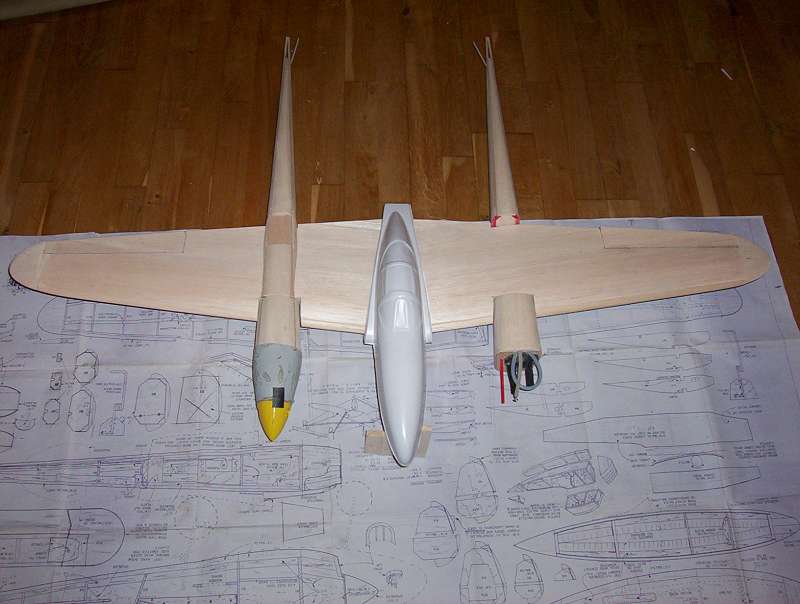

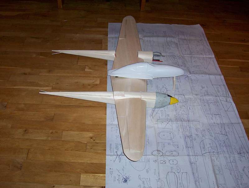

Hi, i'am scratch building a p-38 from Model World plans.
The p-38 will get 52 inch span foam balsa sheeted wings, and retracts.
I still do not know what the engine size will be, .15 ore .25.
The retract are made in Italy by the Eurokit factory, and looking good.
The wheels will retract for half inside the booms and centerpod.
I use also a few parts from the GP p-38 profile, like the top canopy and the radiators.
I will use Waypoint servo's (new brand for me), for the controls.
I hope more people are building the same size p-38, so we can share some tips and hints.
Regards, Kees.

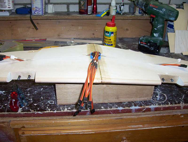

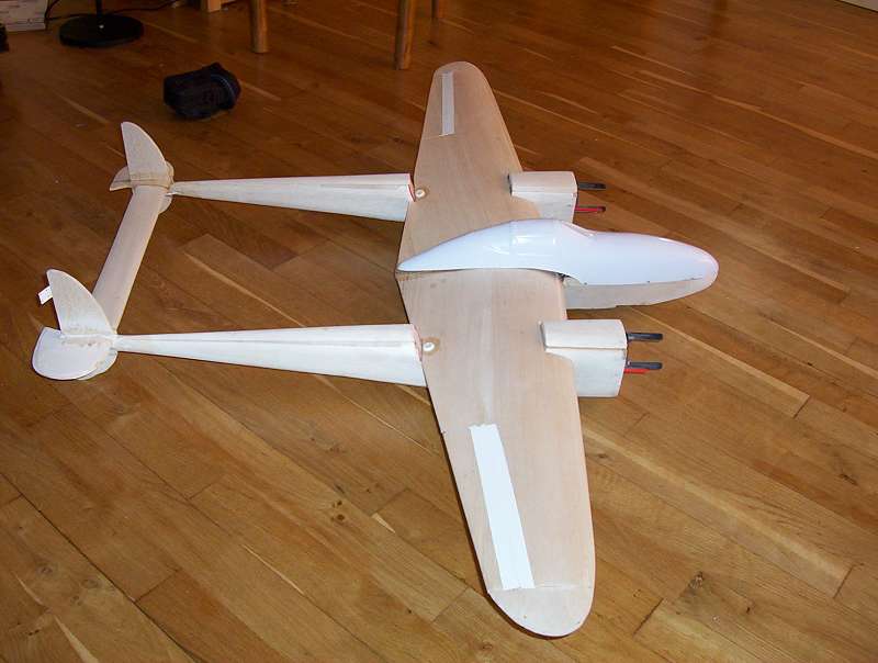

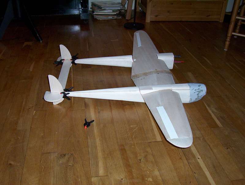

imTime for a update of the project.
Aileron servo,s are installed (maker Waypoint) and I aligned the tail and rudders.
It starts to look like a Fork Tailed Devil!
Regards Kees.

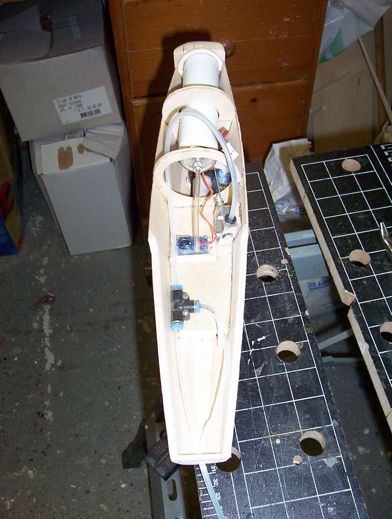

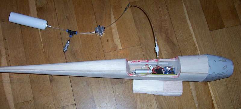

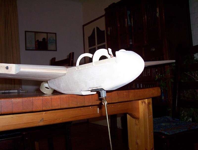

Now I'am building the centerpod. It will be a puzzle to give all equipment a good place.
Speciale the steeringservo for the retractable frontwheel...
Has somebody some pics from the steering servo's for retracts?

As for servo installation for the nose retract, it kind of depends upon the linkage requirement of the retracts themselves. Some use a steering arm and others require a pull, pull arrangement that folds the wires upon retraction.
Twinman

mine will get the pull pull system. But i still have to figure out what is the best position for the servo.
The wheel will come also very close to the position off the servo.
After a night sleep i will find a solution, but a few examples will help.

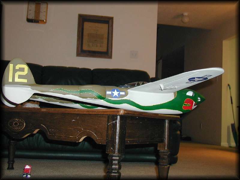

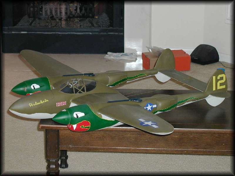

OMG this is an impressive little project...Good luck with it and keep updating this thread.
I built the P-38 from K&A Models last year. It's fiberglass pod and booms with sheeted and glassed foam wing. It's powered by 2xspeed 480 geared motors and a 10 cell cp1700 pack. It's about 1/12 scale, 50" wingspan, 350 in sq.
Flying weight is a hefty 64 oz (yes, that's 4 lbs)....I've flown it a total of three times, at that weight and hand launched, I just can't get motiviated to fly it. After seeing your project, you got me thinking about it again.......
Here are some pics...

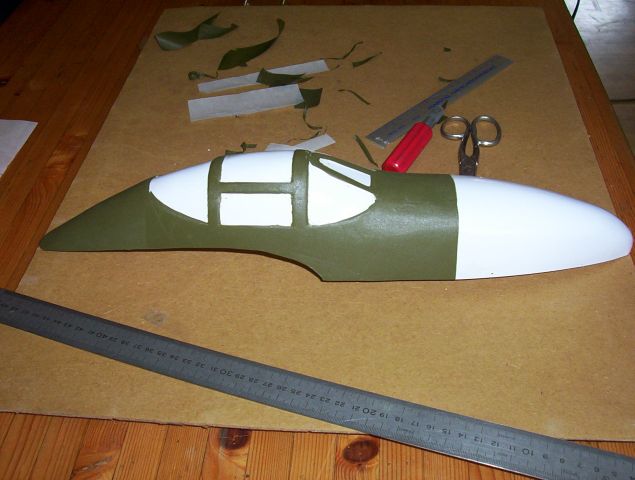

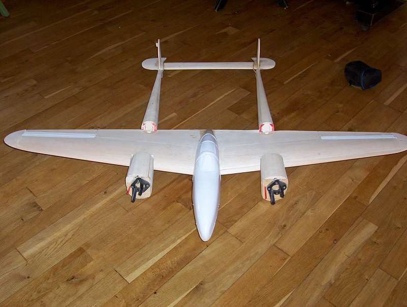

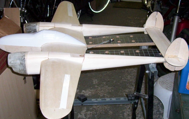

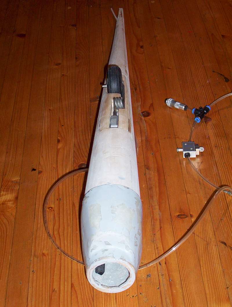

Here a new update from my P-38 project.
I'am now buzzy with the centerpod and it starts to look like the P-38 know.
The top canopy from the GP profile 38 fits almost, the gaps on the wing i will fill up with some scrap pieces.
It gets a bit crowded inside the centerpod, but so fare i can give all equipment a good place.
The connection's are all fitted underneath the wing and (with fingers crossed) i hope they stay
there without leaking.
Regards, Kees.

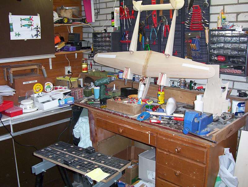

The workshop after a few days working.

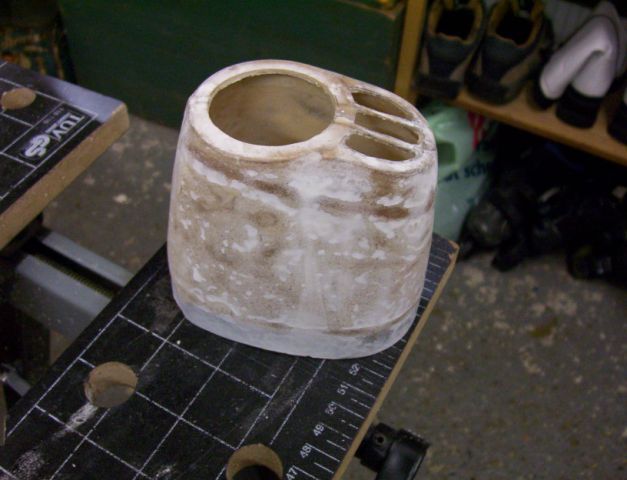

Here a update from my p-38 project.

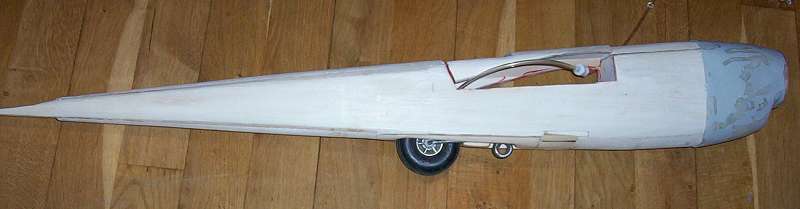

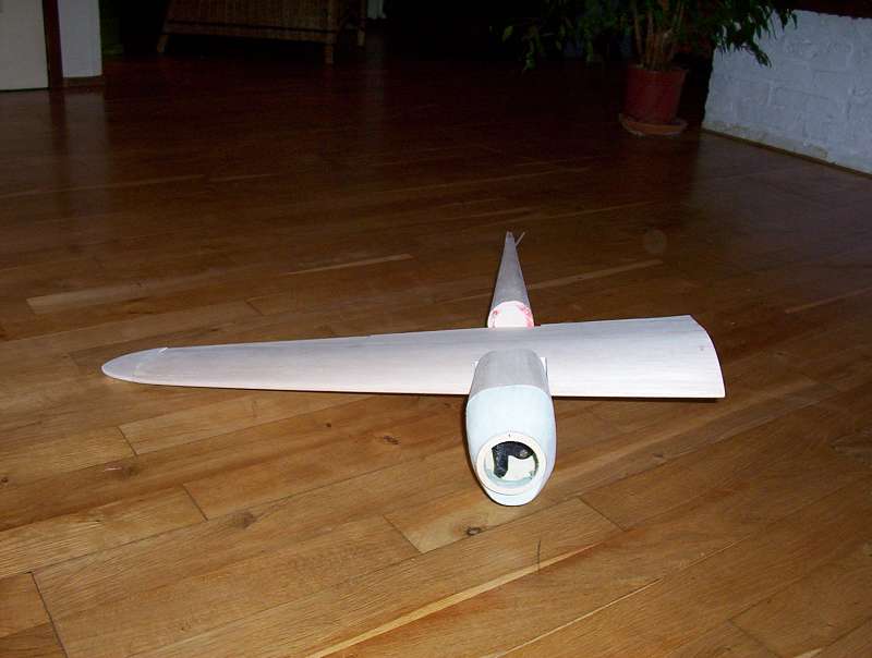

i made two cowls with the lost foam method, and a old panty as glass. with 3 layers epoxy and sanding/filling etc this is the final result.

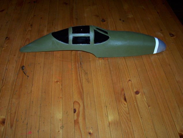

ref : clear canopy,
I made a mould from the GP canopy with gietgips (dutch). Maybe you call it white modelling cement.
From this mould they will make the clear canopy in my local Hobbyshop.
Then i cut out the ABS canopy and replace it with the clear canopy.
Regards, Kees.

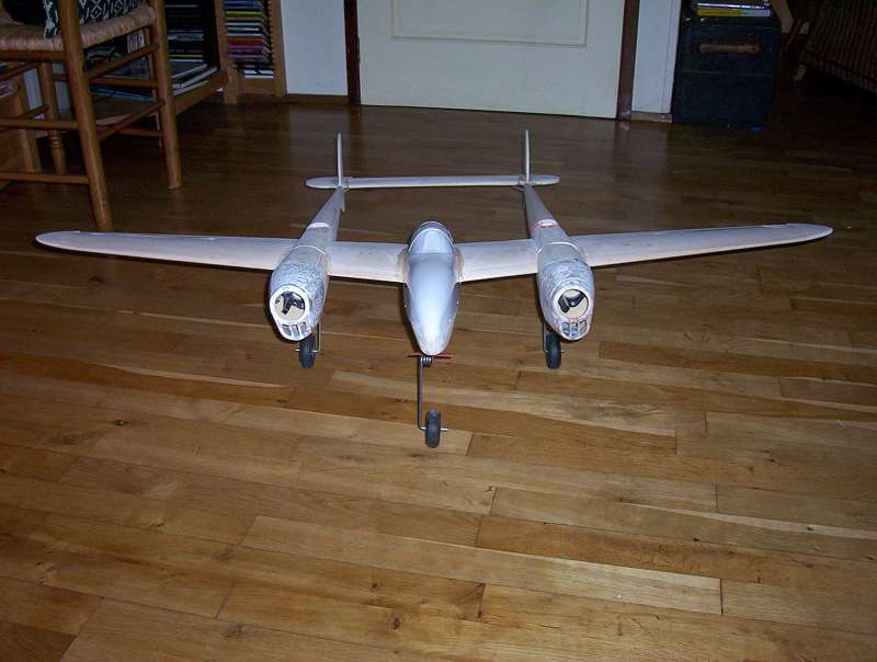

Standing on the wheels for the first time.

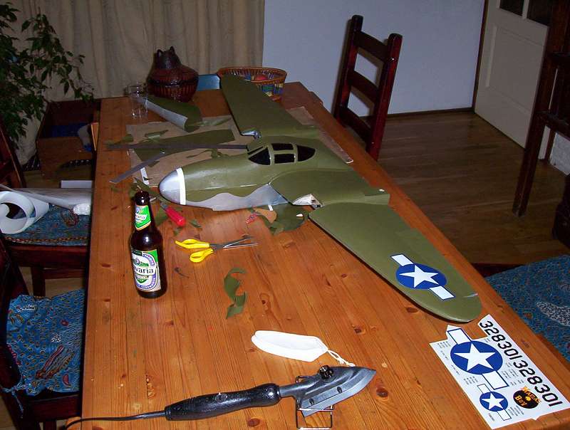

Covering is started.

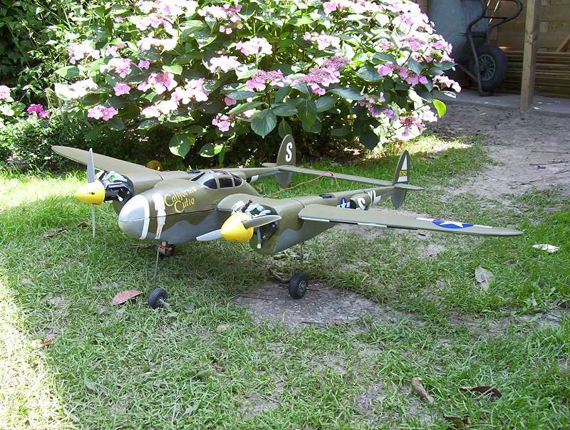

The California Cutie is ready to go!!
2 .15 Magnums with 8x6 props have to pull the 2450 gr into the air.
During taxie on long grass the plane showed to have anough power.
