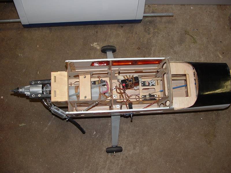

You can see in the pics I've got the inside of the fuselage set up except for the front fuel tank and windshield. I'm anticipating the plane being tail-heavy from what I've read and observed building it, so I put the battery up front under the place for the fuel tank. Therefore, I'm waiting until I balance before I go to all the trouble of installing the tank and hoses. I'll fit and mount the windshield after I mount the wing.

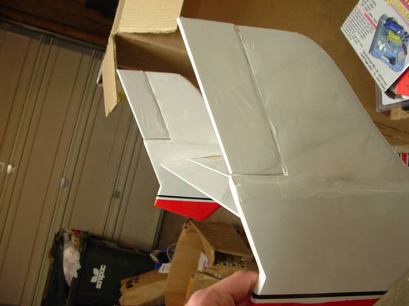

I glued the horizontal stab into the tail booms. I used CA for this and I'm not at all worried about it coming apart. I flowed some medium in there, (after cutting away some covering) and it feels nice and solid. Not to mention the tail booms aren't going to let it go anywhere regardless.

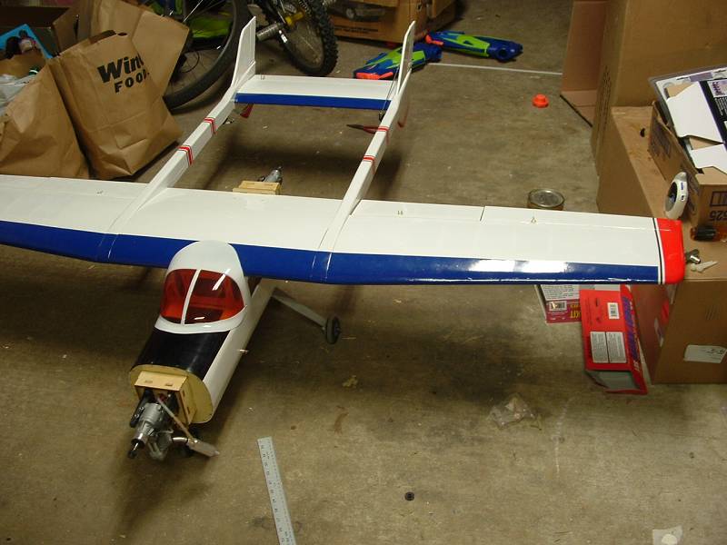

The vertical stabs are in place. As you can see, I tore the original covering off and I have one re-covered. It turns out that the balsa is closer to 3/8" than 1/4" as my ol' buddy Spydermonkey said... No matter, I'm not too concerned with a little "rib" effect. At this point, I want to get it done and fly the darn thing!!

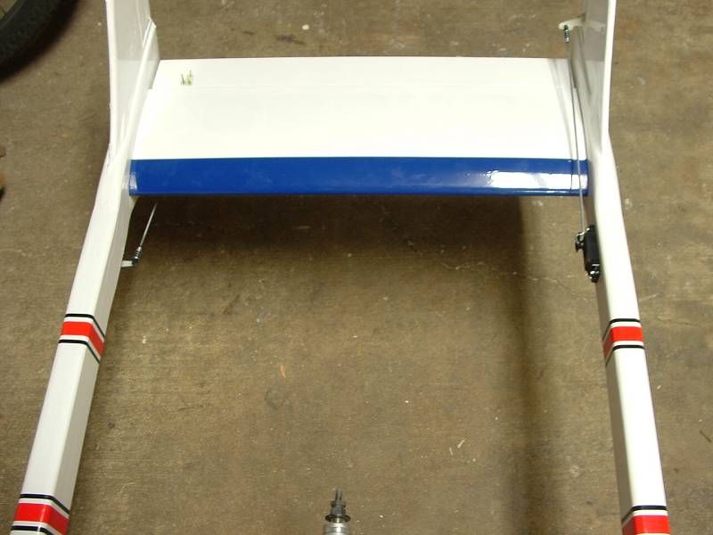

Today I finished covering the new vertical stabs and rudders. I then hinged the rudders and elevator. After that, I epoxied the wing tubes to the main wing panel and tail booms, making the airplane a total of four pieces to transport to and from the field, (fuse, booms/main wing panel, & 2 outer wing panels). I also epoxied small pieces of hardwood into the exposed ends of the aluminum wing tubes for screw retention.
I went against my better judgement and installed the front fuel tank and fuel lines while the glue was drying. I was going to save it until the end since the tank will rest above the battery and I'm not sure where it's final resting place will be. But, I'm trying to shorten my to-do list.

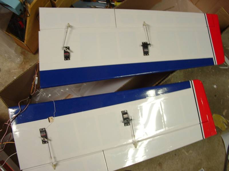

I also set up the linkages on the wings today.

I deliberated long and hard about the wings and, eventually, decided that it would simplify everything if I just epoxied the whole wing into one piece. One problem I'm seeing with this aircraft's design is that in order to take the main wing panel off, you have to take off the rear cowl. That, to me, is a big hassle. I will most likely transport it in one piece.
I discovered, after I epoxied the wings onto the tubes, that the left wing sits about 2 1/2 inches higher than the right. It looks like it may actually have more dihedral built into it. It is also possible that it's the landing gear not being completely symmetrical. I was too tired and I ran out of time to delve deeper into the mystery.
I installed the elevator and rudder servos. I decided to use one servo for the elevator, since I'm using a digital on 6 volts, and one for both rudders. They will be linked by a rod between them when all is said and done. That's actually one of the few tasks I have left.

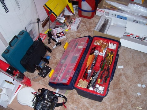

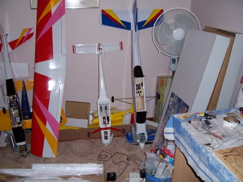

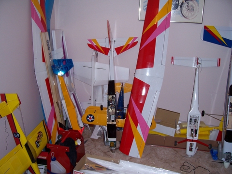

In the pictures, please ignore the mess in my garage. I'm running out of space in there with all the airplanes!!

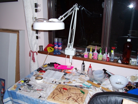

Hi PD, "mess in my garage".You must be joking .You've got a long way to go before you can equal my "mess"

Hey Fearless, at least your "mess" consists mostly of airplanes. Seriously, look in the background, my garage is overflowing with all sorts of things! Before I start on my next airplane project, I'm going to clean so that I have a workspace to build on.

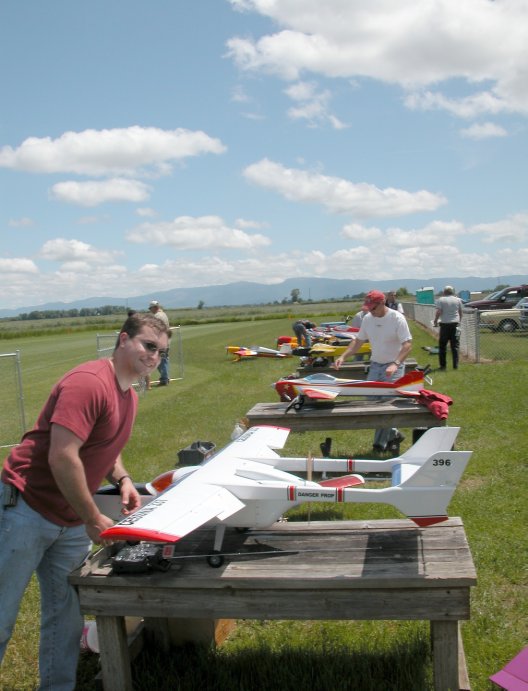

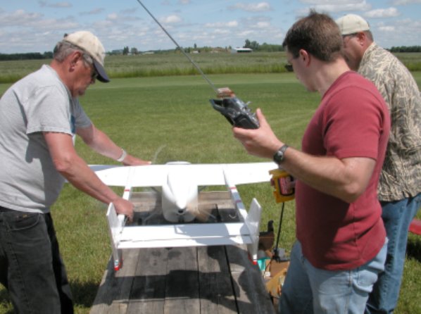

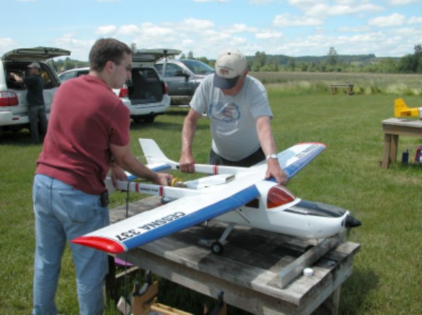

I went out to the flying field yesterday, Memorial Day, and had a lot of good company since a lot of our club members had the same ideas for the holiday. In the back of my pick-up, in its custom-made PVC carrier was my Nitro Models Cessna 337 Skymaster, out for its maiden voyage into the wild blue.
There was no wind. The runway needed to be mowed, but with two 4-strokes, I anticipated that to be a non-issue. After firing up the Magnum for the first time, and it started right way, I started the O.S., which had about 1 hour of run-time on it in a different aircraft. Both fired up with no problem, although the O.S. seemed a little rich on the low-end. I ran the Magnum rich all around since it was new.
With two helpers, one on each wing, the 337 was lifted off the bench and set down on the edge of the runway. A little engine run-up, a little high-end adjustment, and I ran out of excuses to keep her on the ground. I put the controls on low-rates, conducted one final surface check, and taxied onto the runway. I wasted no time and put the throttle to the firewall. The Magnum came to life instantly while the O.S. lagged behind but slowly gained RPM's. The 337 lumbered in the tall grass but, at about 25 MPH, began to lift off with some elevator coaxing. It sailed gently into the air and needed only slight aileron trim and moderate elevator trim. On the downwind leg, I felt confident, and the 337 looked great! I decided to tempt fate with an aileron roll and watched as it rolled much more on the axis than I had ever imagined. I heard people talking about it immediately: "Look at the way it rolls!!" No one could believe it.
The rudders showed to be near useless, but better than nothing.
I landed with the nose up, flaps down, and it was absolutely beautiful. Here are some pictures of us at the field...

On that note, I just got back from the field. There was about a 5-8 mph crosswind, but I took off without fear knowing that the Skymaster can handle it. Let me tell you, it was a fun time. The O.S. FL-70 actually started the day running pretty well. I can't seem to get it to lean out on the low end and still run even a little bit reliably. The tank is below the needle by about 1/2", so it really shouldn't be flooding. I'm pondering sending that engine back. I landed twice today with it having quit. The Magnum, on the other hand, is a freakin' powerhouse! That thing is just barely breaking in, and its power just keeps getting better. It is louder than the O.S. by quite a bit, but it's worth it considering how much better it runs. It idles very reliably, mid-range is smooth to run in and transition through, and the high end is significantly more powerful than the O.S. Now, it does consume quite a bit more fuel, but I'm okay trading that fuel for a decent run.
I had some excitement today when, on the first flight, both engines were running great and I was doing touch-and-go's, one after another, with flaps and without. I took off on the last one and the Magnum got some air bubbles due to the fuel level getting low and stopped when I was climbing out at a high attitude, about 30' in the air. I nosed forward to level flight and circled around, with the flaps down, still able to climb slightly! I landed without incident and fueled it up for the next flight =)
Seriously, this airplane is a heck of a lot of fun. Sure, it can't fly inverted for very long and it won't do any 3D maneuvers, but it is a fantastic sight to see in the air... and it has a VERY UNIQUE sound, (when both engines are running).
I really love this airplane!!
