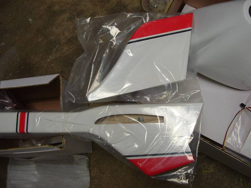

As I had heard, the vertical fins have no rudders built into them. I have not yet decided if I will perform some surgery and put them in before the maiden flight. I like to do hammerheads, spins, etc., so the idea of NOT having rudders just bothers me. If I had heard about that issue before I ordered the plane, (the website actually notes that two servos are needed for rudder) it may have made me hesitate to buy this one in particular.

RE: Nitro Models Cessna 337 - Build Thread

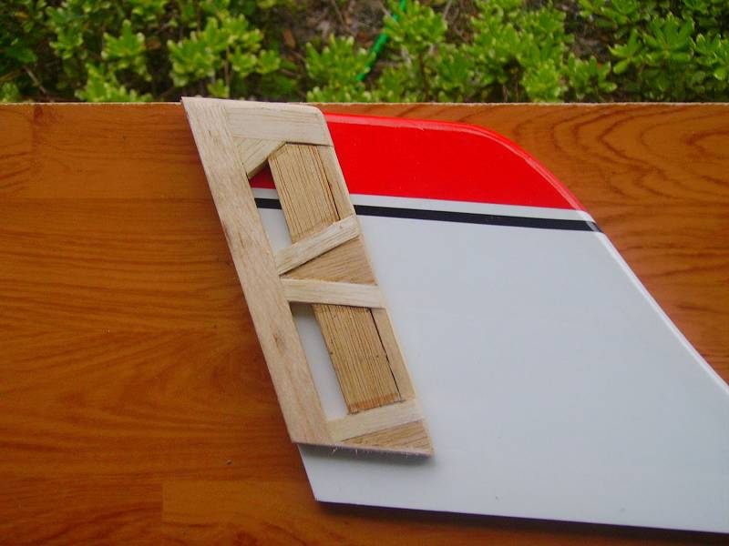

I've invested about 4.5 hours into the project, much of which I've spent planning the set-up, inspecting the parts, etc. So far, I have finished the main wing panels and I've started on the fuselage. I've installed the main gear and nose gear. I have also installed one of the fuel tanks with the other ready to set in place tomorrow when I continue.
I heard from a fellow RCU member who cut out the rudders about 2" into the vertical fins. His design looked very natural, as if it were how the manufacturer had sent the plane. I may go with a similar approach, or, perhaps easier, would be to just attach the rudders to the trailing edge of the vertical fins since they are not tapered. I've attached pics of the tail boom and fin.

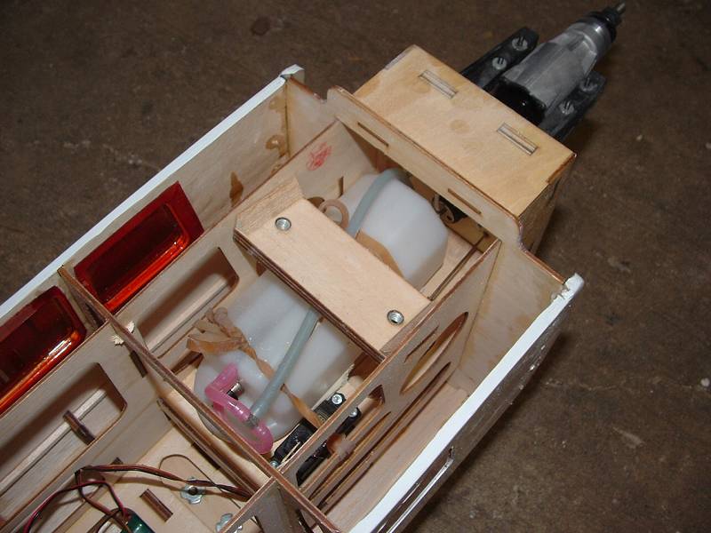

If the tank you show in the pics is the rear tank, you will need to turn it around, or find some way to get the clunk to stay at the back of the tank.
Would look better to cut the rudders from the fins and then hinge. Just adding on , will look, well, "added-on".
As Terry noted,, the rear tank is going to be a problem in the
current configuration...
Would be easy to just run a longer brass pipe for the clunk
line and the put a 180 radius bend in it so the clunk is to the
rear so it will always have fuel.. [8D]

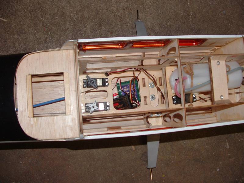

You know, I knew ahead of time about the fuel tank set-up needing to be facing forward/away from the rear engine, and yet I installed it wrong anyway. I'm certainly glad I started this thread!! I will probably just turn the tank around entirely.

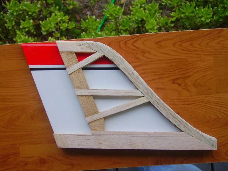

Okay, these pictures are from the other RCU member who did the modifications to his vertical fin:
Terry also has a good point about the rudder add-on. However, there may be a way to make it look good if I can just make the shape/lines match and then put on matching covering. I don't know, yet, if I'll go through all the trouble, but it certainly is going to be an issue for me when I want to do hammerheads and spins and such... I asked on another thread if anyone had thought about mixing with the ailerons and flaps to simulate rudder control. I'm wondering if I can mix it so that when I apply, for example, right rudder, the right flap goes down and the ailerons input slightly to the right to keep from rolling. But, at slower speeds, with lots of power, this could have a very different, maybe even opposite direction sort of effect. I'm not worried about coordinating turns so much as I just don't want to get bored with loops and aileron rolls. I don't want to 3D in it, naturally, but I want to be able to do the basics, at least.
*sigh*
That looks like really good way to do the rudders. I just can't imagine flying a bird this size without rudder. And with the style of ailerons you have, you may need to coordinate with rudder in the turns to keep the tail from dropping. But I think you will also need it on take off to control the model, as it rotates, and the nose wheel leaves the ground. They will be worth any amount of time and trouble needed.

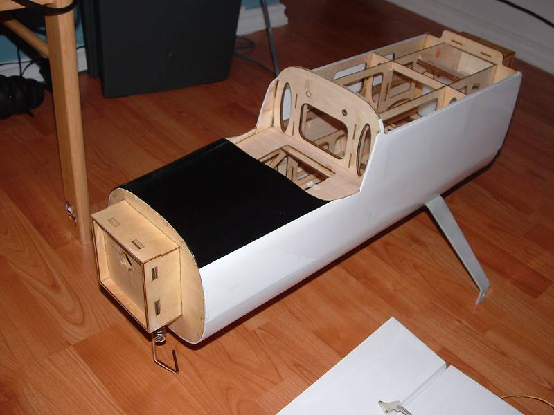

Yeah, I'm actually pretty impressed with the integrity of the structure itself. The covering job is decent, not great, but good enough. Obviously, one can expect wrinkles upon arrival, and that's easily remedied with a heat gun or hot iron. However, some of the lines are not the straightest. At least all the lines with the control surfaces match up so far, so that's a bonus.
I ended up taking the tank out and I plan on just turning it around. I set up a long piece of brass on the inside of the tank and made a 180 bend and attached the fuel line and clunk. Then, I found that the clunk was getting tangled up in the brass tube and could end up getting stuck, leaving about 1/2 tank of fuel inaccessible to it. So, mine will just be turned around...

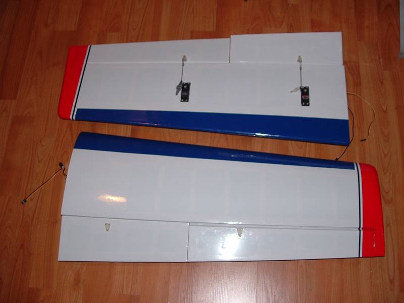

PROGRESS BEING MADE - about 8 1/2 hours total so far invested in project. I have mounted the rear engine and have begun mounting the front engine, which arrived in the mail today. The servos for the throttles and nose gear are mounted in the fuselage. I received two Hobbico mini servos for the rudder today. With the 6V battery I'm using, it is supposed to have around 53 oz. of torque, so that should be plenty for each wimpy little rudder.

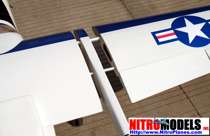

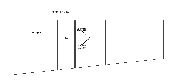

Now, here's an issue that I'm seeing: The wings mount using two aluminum tubes per panel, but they have no retention screw set up! There are wing struts included that seem pretty durable, but since they are at a downward angle, they may allow the wing to slide a little bit on that tube.
I thought about just epoxying the tubes in place and making it a two-piece airplane, but that really is not convenient for transport at all!! I also thought about epoxying the tubes into the center wing panel and tail booms and then doing some surgery on the wing halves. I was thinking about putting a hardwood block on top of the tube route inside the wing and then having a screw go through the tube and into the block to hold the wing on laterally.
Anyone have experience with these plug-in style wings that could shed some light on this for me? Am I missing something? I've included a pic from Nitromodels showing how the wings plug in.

Rear cowl has been trimmed and front engine mounted. I'm playing around with the fuel tank locations a little bit to keep them from interfering with the throttle pushrods.
So, I still really need some advice on what to do about the wing plug-in issue!
For easier transportation, I would glue the tubes into the outboard sections and screw them into the center section, but I can't tell from the photos whether the structure would allow that. You don't want to screw them into both sides because aligning them each time you assemble the airplane would be a b***h.
Spydermonkey,
I have a pick-up as well, and I actually had not thought about the possibility of the wingtips just hanging over the sides like that, it may work just fine!
Jrf,
I'm having a hard time imagining what the end product looks like, but it sounds perfect. Can you provide photos of a similar aircraft with that set-up or can you draw it?

Excellent drawing!
As luck would have it, I found a piece of hardwood under the balsa about 1/4" from where the tube stops inside the outer wing panel. The cardboard tube sleeve goes through this hardwood block. So, using your idea, I will be installing a screw that goes from under the wing, through the block, through the tube, and then through the block on the other side, where it will fit snugly to stay in place during flight.
Should I be putting one in the smaller rear tube as well?

I did not check the center section for the blocks. Besides, I think I want to epoxy the tube inside the center section and tail booms to keep them together. I can't see any benefit to having the booms unattached to the center. In fact, I think they would be more likely to get damaged from travel and handling without something holding them in place at the leading ends.
I didn't have time to check for the blocks in the little/rear tubes, but I will check. I would certainly prefer to have 2 screws holding the panel on rather than one, just in case.

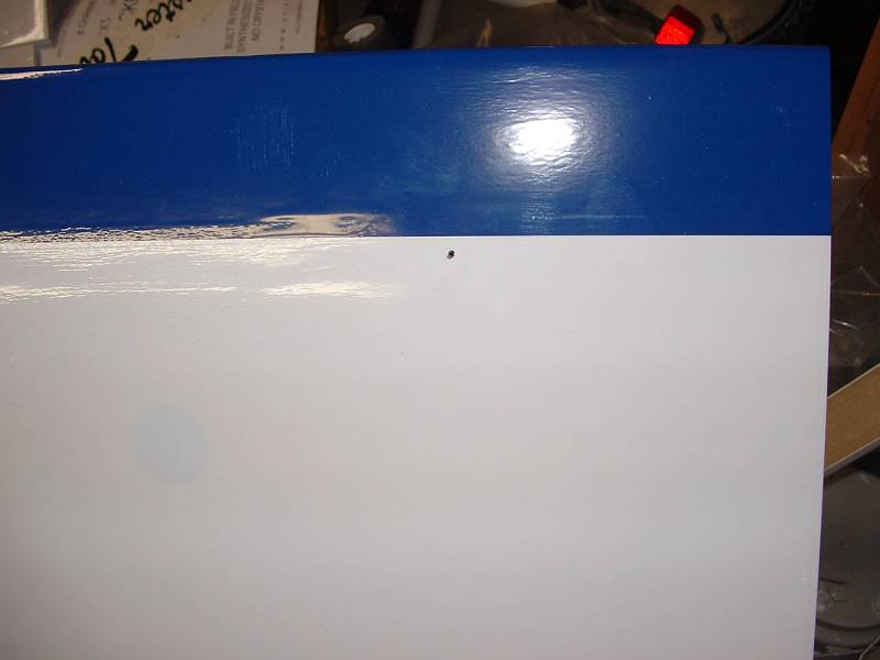

There ended up being two little holes drilled out under the covering on the main wing panel just in front of where the aluminum tubes end. Naturally, I was a little put off by this since the instructions have no pictures, no text, nothing indicating what to do and there is no hardware for attaching the wing. So, I'm either going to go with jrf's idea for install, along with the blocks already installed in the outer wing, or I'm going to epoxy the whole thing together and call it good. Here's a picture of where the holes are.

Just finished framing the "new" rudders. Next I will sand, re-cover, and hinge them. Then, I will be attaching the vertical fins to the tail booms and installing the horizontal stabilizer and hinging the elevator. After that comes installing the servos in the tail booms.

Well it's nice to know that they did put screw holes in the wing for removal! to bad I didn't find them sooner You're right about all the y harnesses though, I've seen less of a mess on a plate of speghetti! hope the build is going good, I plan to fly mine this weekend! will let you know how it does! B
