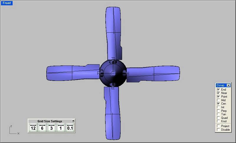

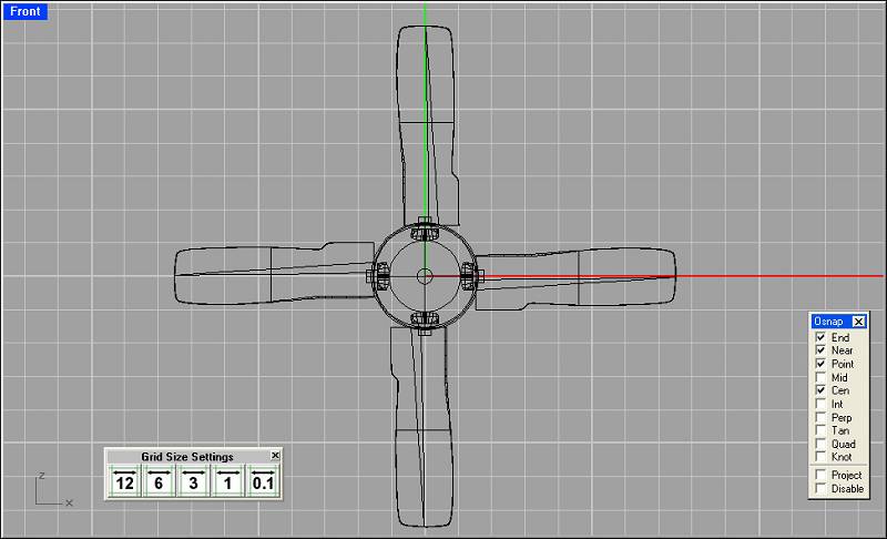

I've deceided to go with the RCV 90's for power. I'm having custom made 4 blade props made up for the Herc. The RCV's fit perfectly inside the cowl with only the carb sticking out. The exhaust will be run out through the rear as in the full scale. The props are still being made up. I wanted that wow factor when you walked up to the Herc. Also i did not want to switch from static props to flying props. The RCV 90 has a stump pulling amount of torque.

THose are really nice props. Have you received them yet? What diameter are the props going to be? I would be interested in buying a set when the time is right.

I have not recieved the props yet. It has been almost 3 yrs in the R & D. I beleive he has a set of props made up for destructive testing. A couple of months ago my hard drive crashed and i lost all my email transactions and info. He was even thinking of making them ground adjustable pitch. His main business is making UAV props and military orders. He is making these props on the side for me.
http://www.propellers.us/index.htm

15.5" for now but i would like to get it down to the proper scale of 13" Plus the size of the spinner will have to made smaller to fit the front of the nacelle.

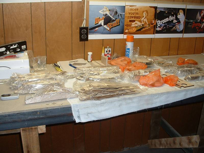

I recieved my PCKs Palmer 132.84" C-130 kit on Friday. I had ordered it on Friday night the week before. Since we're starting this from scratch I'll also start my comments from scratch.
PCK: Wow, heavy duty box, looked like it was full of just shreaded paper, but in reality nearly the entire box is full of airplane. The bundles of stringers, LEs, TEs and sheeting are ALL labeled, Bulkheads, ribs and well everything is labeled. As for the quality of the cuts, the edges of the bulkheads and ribs and formers are all crisp and clean. The huge fuse ribs over the cargo ramp anr even seperatly pacaked to protect them. The UPS label noted a weight of 17#, I haven't weighted it yet but I'd bet nearly all of that is wood.
I'll be inventorying the kit against the plans next so that will be my next post.
