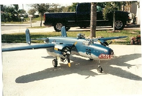

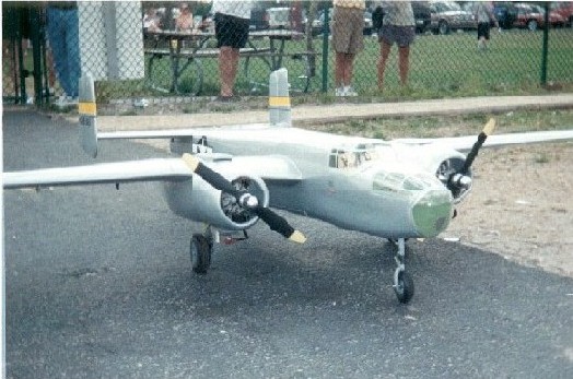

Twins and one engine....
Ok....I'll get the ball rolling...most of you know the story about B-25 #1.....so I'll make it short . "Z" B-25...102" WS....37 lbs....52 oz WL............on a rt shallow climbing turn @ 400 ft...# 1 eng failed and it was inverted Immediately(maybe sooner)......reduced power and continued roll back to straight and level.........pushed nose down to gain airspeed.........airplane became virtually non visible due to brush, etc.....bellied it in best I could slightly holding some up elevator when I "Guessed" it was close to the ground......Plane was severely damaged due to landing on a rockpile.......Lesson learned: when flying a "Twin"..make every effort to fly at a field with clear areas and good bailout places....not at a field where the only place to land is the runway........Bill....
