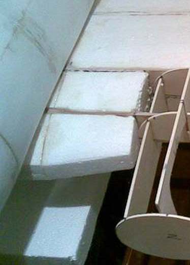

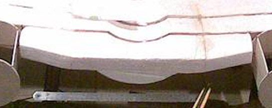

Well the only place on the wing i can think of installing tank is between fuse and IB nacelles and that is in front of CG point. I saw what happened to Mike's Hawkeye on his maiden flight and i don't want to repeat that with my model.
Here are the pictures from last year with wings separate from the fuselage sitting on the table. This tank could only be installed between LE and front and center spar between nacelles and fuselage.

Being more specific of the fuel tanks locations if incorporated into the wing.
1- Between both front and canter spar, between root rib and IB nacelles.
2- Between LE and Front spar at same between root rib and IB nacelles.
I think i might have to make custom fiberglass fuel tanks to fit int these location soon.

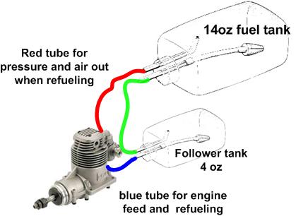

here is the draw of how the foloewr tank work , it is one system for one engine so you need 4 !!
cheers - cobi
hello sammy
cheers - cobi
Thanks for showing me the way Cobi, i will only need to add this system on my both IB engines as i can place main fanks in the fuselage and place 2 oz header tank in the nacelles with fueling dot.

well sammy you got it all wrong ...sorry
look good at the draw , the small tank ( 4 OZ ) is always in a full condition , only after the main ( big) tank is ampty the small tank start to drain , and you never get to it .
you will have right behind the firewall a small full fuel tank with no bubble's and with a good fule flow .
this is my 2 cent opinion

So basically what you are saying that i should have both of these tanks close to each other in the nacelles?
If that is the case then i have rig up something to keep these in the nacelles, at this time it can't be done, let see what i can come up with once i have retracts and struts made for the mains and installed.
