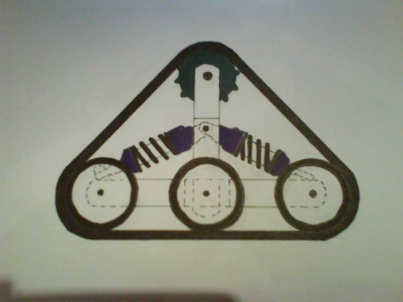

Hi Dakota its rickster,
I dont know about cflight, i have been testing the track and shock setup of my design, i tested the system with a 7.2v buggy motor running a marinc esc and 12v battery at full throttle it handled the speed and tracks stayed on and tight the shocks worked really well , this is under no load or with the weight of a truck but the system is only a plastic mockup for testing so made of aluminium as its meant to be will be more than strong enough.
I am still looking at what tracks and drive sprockets to go for, my final updated design has one drive sprocket and two idler wheels with a twin shock absorbing system, the big deal is quick fixing it to the trucks, thanks to cflight i solved that bit after alot of head scratching LOL.
Rickster3057.
Rickster3057.

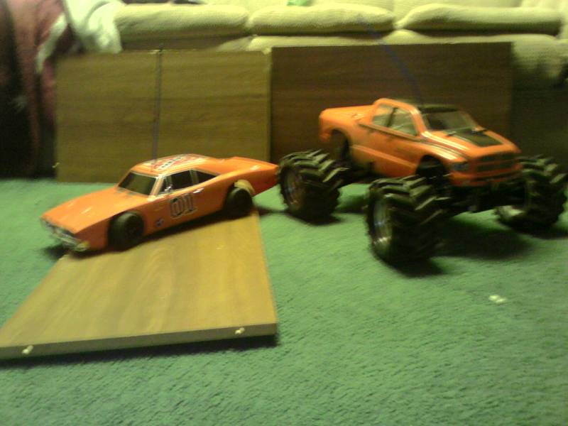

Could you post a pic of what it looks like?
ever since i read this posting it's had the gears in my head turning about how to Attach it to the T-maxx.
I seem to think the tracks are going to look like strings in comparison to the Truck or are your Tank tracks fairly Wide?
I dont know much about R/C just got into this hobby a year ago have 2 T-maxxes and a 4-Tec. like i said this thread got me thinking.
Heres my rides
Heres my rides

Hi dakota, if you type heng long into google it shows the sprocket ,tracks and idler wheels i have decided to use.
the tracks are about an inch and 3/4 wide and the wheels are about an inch if not bigger, so the unit will be quit substantial if you look at the full size mattracks my conversion will look on the same scale.
The attaching of the system is really simple just take the wheel off ,a slip on hub that goes over the hex nut and then the truck wheel lock nut tightens it ,then the sprocket /track system slips over the hub and is secured with a grub screw. the hubs can then be made for all and any truck and the track sytem is simpler to manufacture.
Once I have tested the full unit i am thinking of manufacturing and selling them, depends on demand really. mine will be the first truck fitted a savage 25.
rickater.
