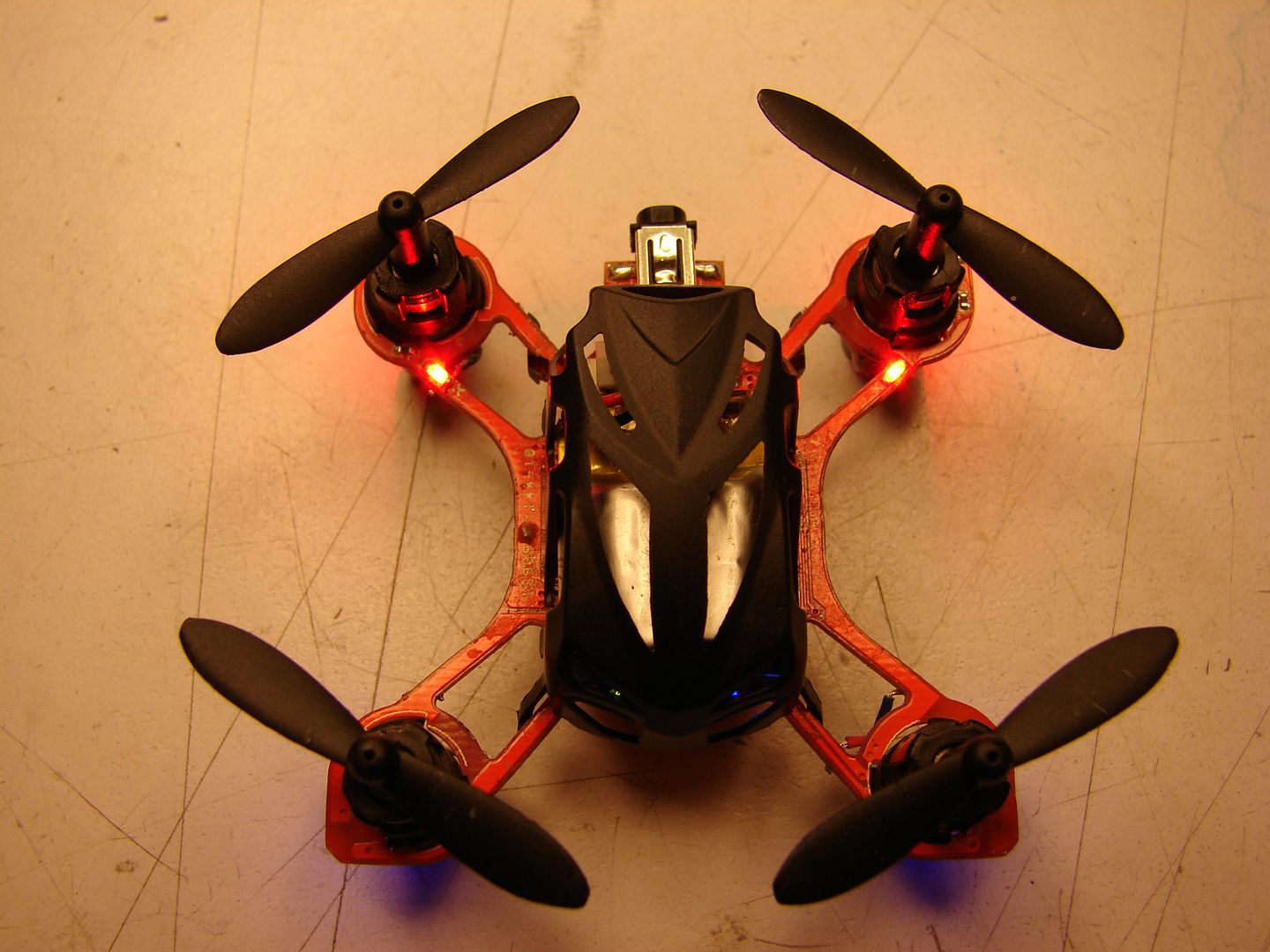

First, I weighed up the individual bits of the quad, then put it on to charge. Quad has charger port built-in; I have to imagine this is purely a matter of manufacturing cost, as they do ship with a second battery. This indicates to me they intend this quad to have batteries swapped out like real hobby-grade aircraft, not like the built-in battery in a Syma S107G. I imagine that by eliminating this and the power switch, you might be able to shave a whole gram off that AUW. w00t?
While it charged, I took some preliminary measurements:
Motor Track shaft-to-shaft: 50mm Diagonal
Props : 4.4 x 30mm
Motors: 6mm x 12mm - CW and CCW Timing
Frame: 65mm Diagonal
Rotor Plane: 80mm Diagonal
AUW: 12.75 Grams
Scarab Canopy: 0.45 Gram
Battery: 1S 100mAH LiPo, 2.65 Grams - 15.7mm W x 19.7mm L by 7.1mm H
Prop: 0.10 Gram x 4
Frame Less Battery & Canopy: 9.65 Grams

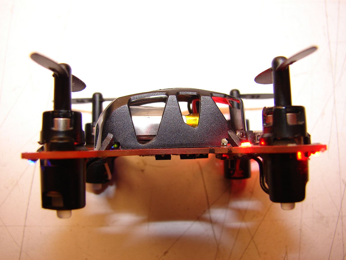

Up Close & Personal
Stripping away the canopy, we can start to see the basic layout.
Battery plug is JST-SH 1.25 mm pitch like the E-Flite micro BNFs use; (same as the V202 motor plugs)
Canopy is much larger than actual battery, but a lot of space taken up by the battery connector; if one put on a short pigtail instead, could fit a much larger LiPo inside. Inside dimensions are 16.9mm W x 26mm L x 10mm H, tapering approx 1-2mm narrower on all dimensions towards the top. Canopy is very flexible, so some wiggle room in size.
This wiggle room is in fact a bit of a problem; I found the quad reacted quite a bit to the battery shifting inside the canopy. I found it necessary to add a tiny bit of small bubble wrap like this to keep the battery snug:

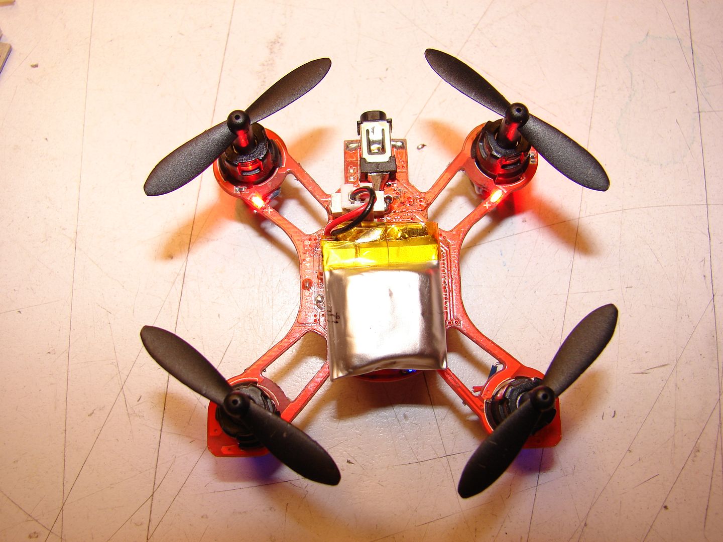

Nekkid Nano-Quad
A little wiping with alcohol revealed the core electronics; aside from a few discrete transistors for PWM motor and light switching, the chipset consists of:
Nuvoton MINI54ZAN 32-bit ARM Core 0 Processor 24MHZ Capable w/16MHZ Crystal; 4/8/16KB Flash & 2K SRAM:
Quite the capable little processor; I believe they've been working on some more sophisticated algorithms as this little beast is rock-solid in hover, although it does tend to bob quite a bit in any form of ground effect or even its own propwash from less than a meter or so. This leads us to our next puzzle piece:
Invensense MPU-6050 6-axis Gyro/Accelerometer:
Obviously they're not looking to reinvent the wheel here; they know this thing is rock solid and tough as nails. Now that the 9000 series is the hot ticket in higher-end stuff, the 6050 is dirt cheap. Perfect for a dirt-cheap tiny quad.
Beken BK2423 2.4GHZ RF Chip:
Yeah... I know. Nothing riveting to report here either; RF chips just aren't that exciting. Actually, that's a good thing; when we have excitement, it's usually in the form of implementation issues which cause random "Quad go Bye-Bye" events like its larger brother, the V202. We had a lot of gripes when WL Toys changed RF Protocols from FlySky to this family; but now that they've got the kinks worked out, this new protocol is proving to be a pretty good workhorse with a lot more available features (More buttons to push) than older gear could offer. I found no evidence of glitching; it stayed well under control indoors in the same room with my WiFi router and easily 40m across the street in the linked video. Viva la Evolucion!

The quad has a nice arrangement of lights; VERY BRIGHT red LEDS in front of the rear motors on top, and right at the corner of the frame on the bottom. Front end is slightly different; it has moderately bright blue LEDs at the corner of the frame on the bottom, and two more inboard on top located so they look like glowing eyes in the canopy which is reminiscent of a Scarab Beetle. Actually, the whole quad is sortof reminiscent of a flying Scarab Beetle; lets hope it never goes bad like the ones from "The Mummy"... :-O
