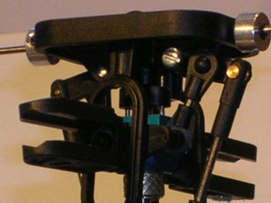

Also, after a nose dive into the deck the connection to the blades nip broke. I found that rather than gluing the connector back on, simply using a threaded 2mm hobby bolt generated a far strionger connection. (I'll post a photo if anyone's interested)

jdh nz- please do post some pics of your repairs. I love the whole "when it breaks, don't just fix it -improve it" thing [8D]

You can see the top of the bolt I've inserted just to the left of the stabilizer rod connection. All I did was get a 2mm bolt, drill a 1.5mm hole where the plastic welded connection use to be and screwed it in tight, then back off about half a turn. There's no friction with this, and to balance the head I did the same thing on the other side. This has worked perfectly so far.

JDH,
Nice repair job!
