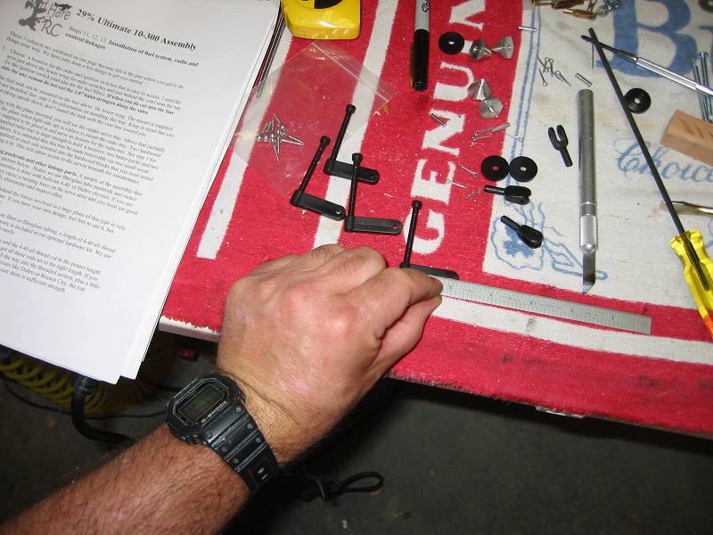

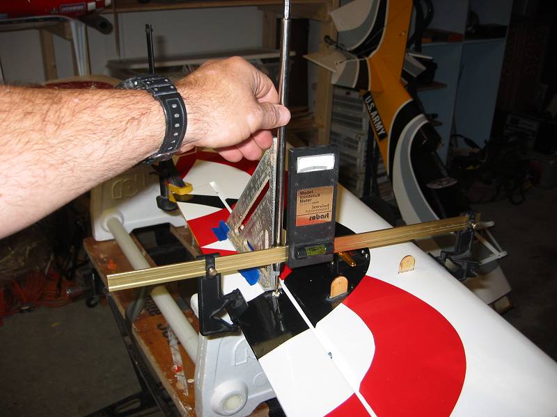

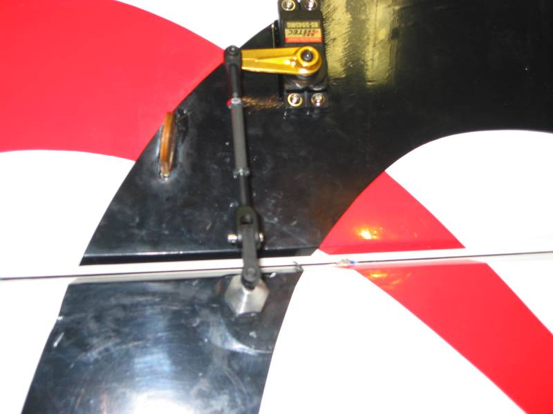

Anyway, back to building...I've been wondering how to get the aileron drilled reliably, so that the hole for the control horn is perpendicular to the wing. Then it hit me - use the incidendence meter to provide a guide! The way the Robart sets up, it will identify the line through the center of the wing - all I have to do is to stay relatively parallel to the edge of the incidence meter body!
Oh yah, use a clamp to hold the aileron in line with the rest of the wing.
I elected to drill by hand using the extension that I had on hand (that I also used to drill the wing strut tabs). The extension acted like a big pin drill - no problem at all.
I also used a speed square the first time...I did not use it on subsequent efforts as the incidence meter was good enough as a reference in both axes.
After drilling the holes for the Robart heavy duty control horns, I strengthened the holes with CA.
On the bright side, over the last week I had a great time seeing Mom and 3 brothers again in California...first time we have all been together since my Dad passed away in 2002.

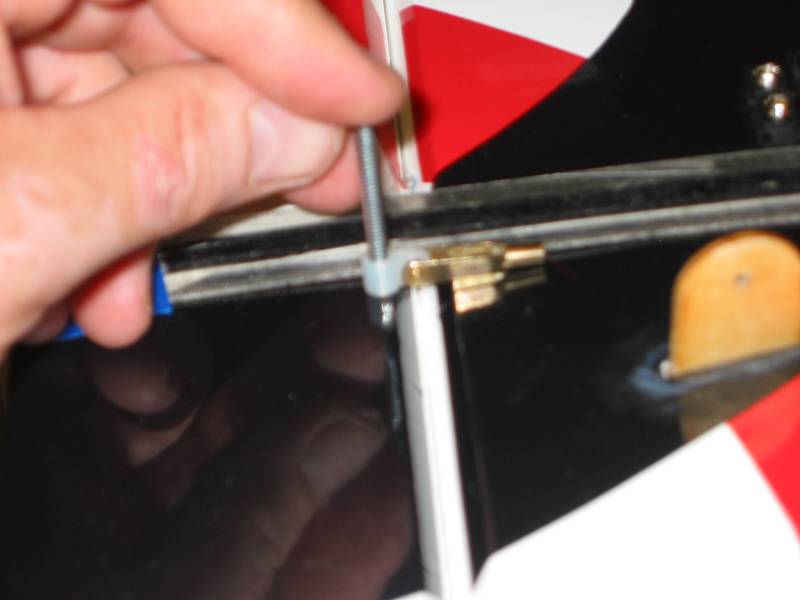

I looked at the hardware that I purchased with the kit, but it seemed to place the control stud too close to the hinge line for my liking. I elected to use Robart heavy duty control arms since they permitted me to adjust the hinge point by drilling and trimming the hinge arm. There was a minor gap left on the bottom of the aluminum nut once it was snugged down, but with a dab of locktite, that should not be a problem.
#59
Join Date: Aug 2004
Location: Woodbridge,
VA
Posts: 357
RE: BME 50 Wildhare Ultimate Build Thread

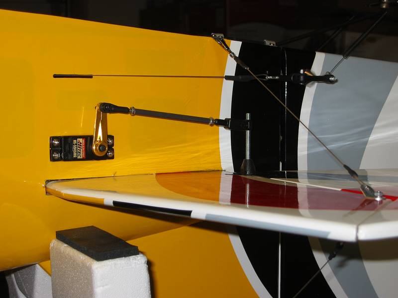

The kit comes with a nice set of fiberglass hollow rod and 4-40 threaded rod for the control horns - works great for a sturdy linkage that is easy to adjust.

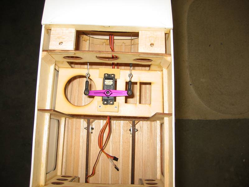

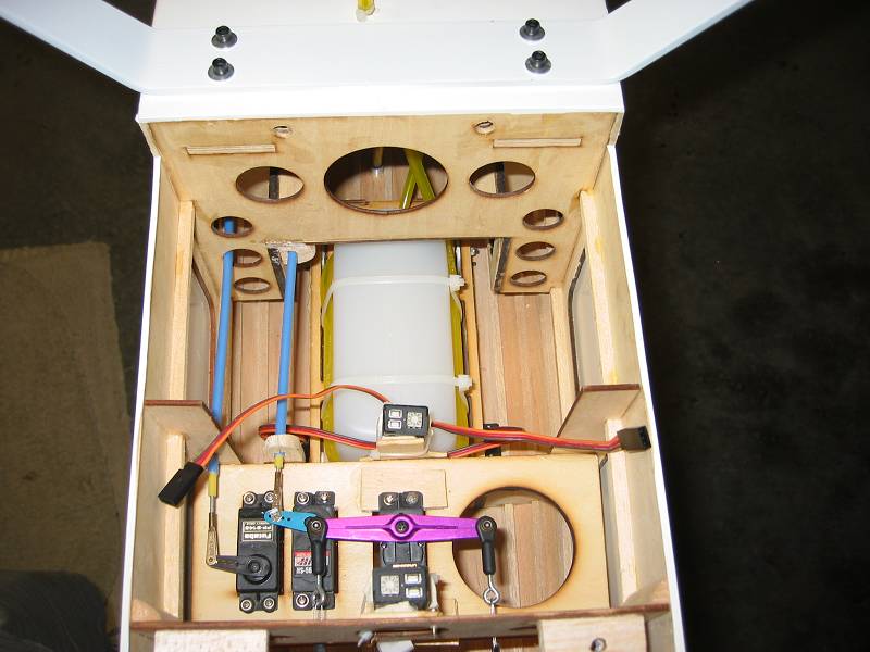

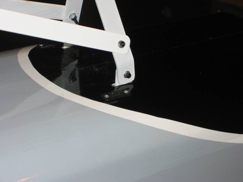

Elevator and rudder next. Pretty straight-forward; kudos again for the hardware kit that Tom sells - everything is right there.
