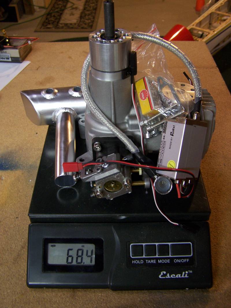

Tom,
I got my 3MM 53 from you today. Its a nice looking light engine. Can't wait to get it going. Thanks again!

That scale weight needs to be revised downwards a couple of tenths. You won't use the exhaust gasket, the box for the spark plug, or the baggie. Well, there might be some alternate uses for the baggie

Silver, Hee hee, sorry to have mislead the public You are right! Either way, it looks like a really nice engine.
