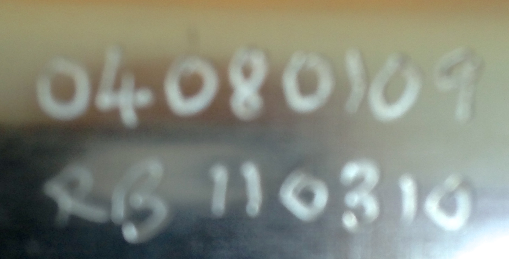

8. Xantos - 1 wren 160 serial nr: 04080109
Bought a new turbine, it failed and was rebuilt by wren- 110310 and failed again

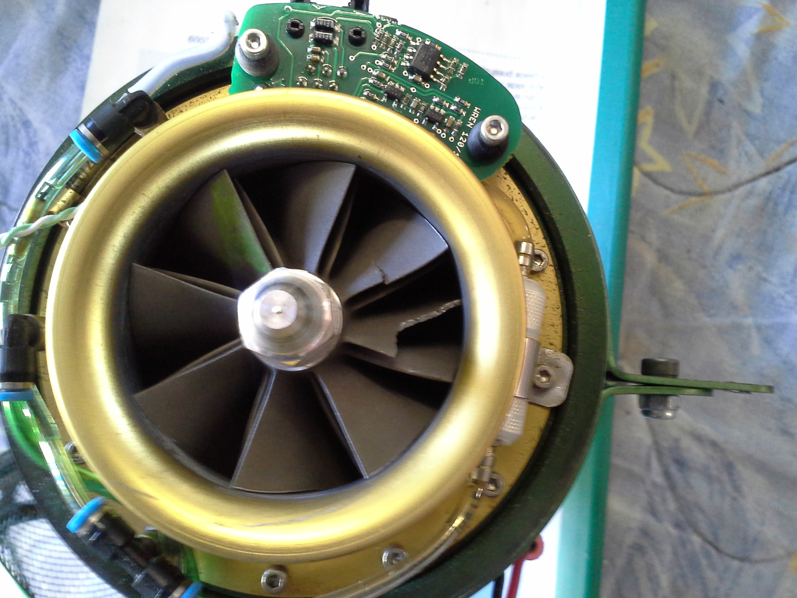

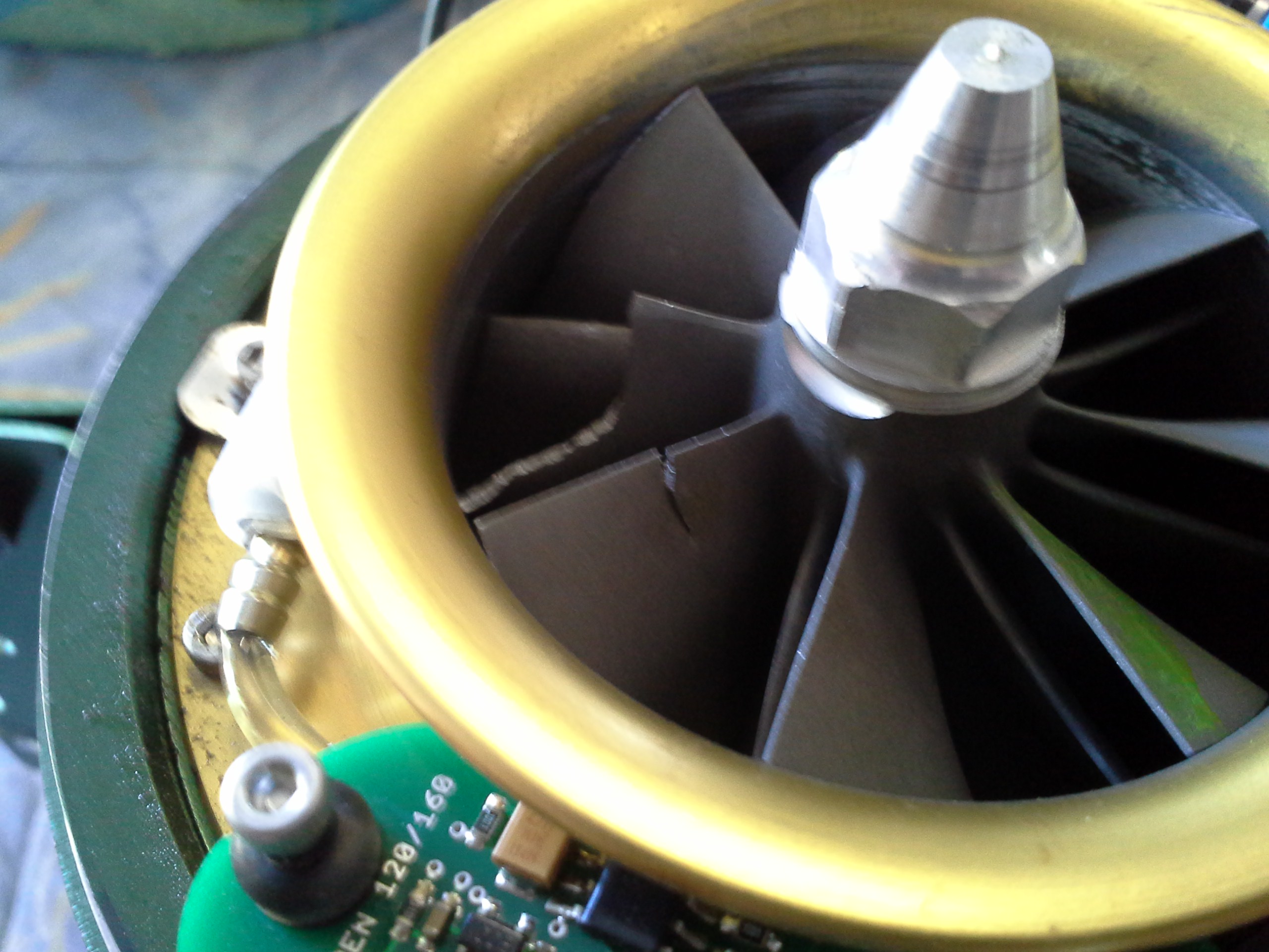

I had one of the early Wren160s that shed a compressor blade .
Wren was good enough to replace the compressor wheel and rebuild the turbine in March 2012, I was still a little apprehensive about the repair and questioned Wren if they were sure that the replacement compressor wheel used in the rebuild was from a a new lot of compressor wheels.
The reply I got was most certainly unprofessional - Wren had NO record of the rebuild and therefore couldn't confirm whether the replaced component was indeed defect free. i.e. From the older lot of defective compressors or from a newer lot.
Two weeks ago the same rebuilt engine threw a blade again.

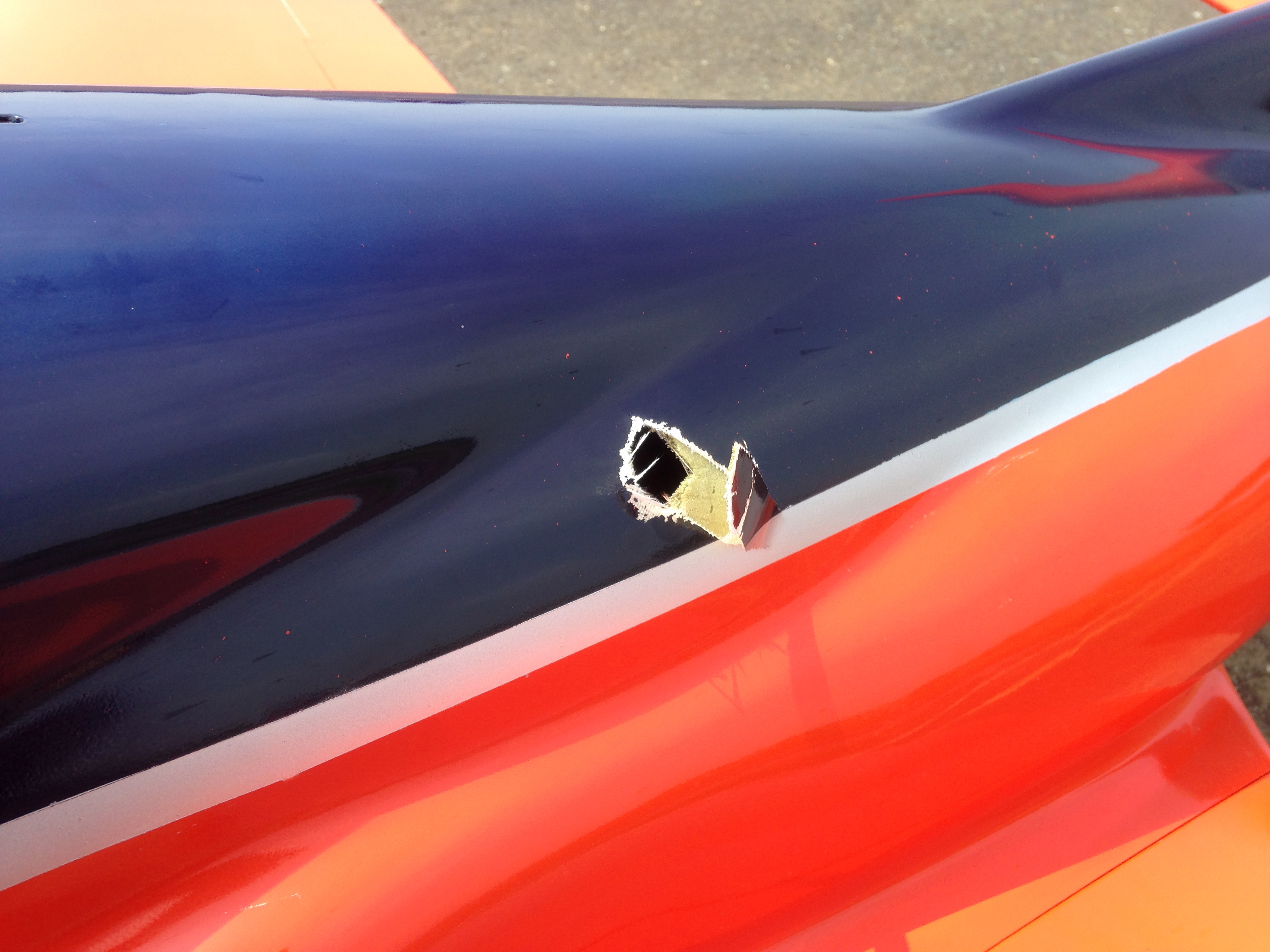

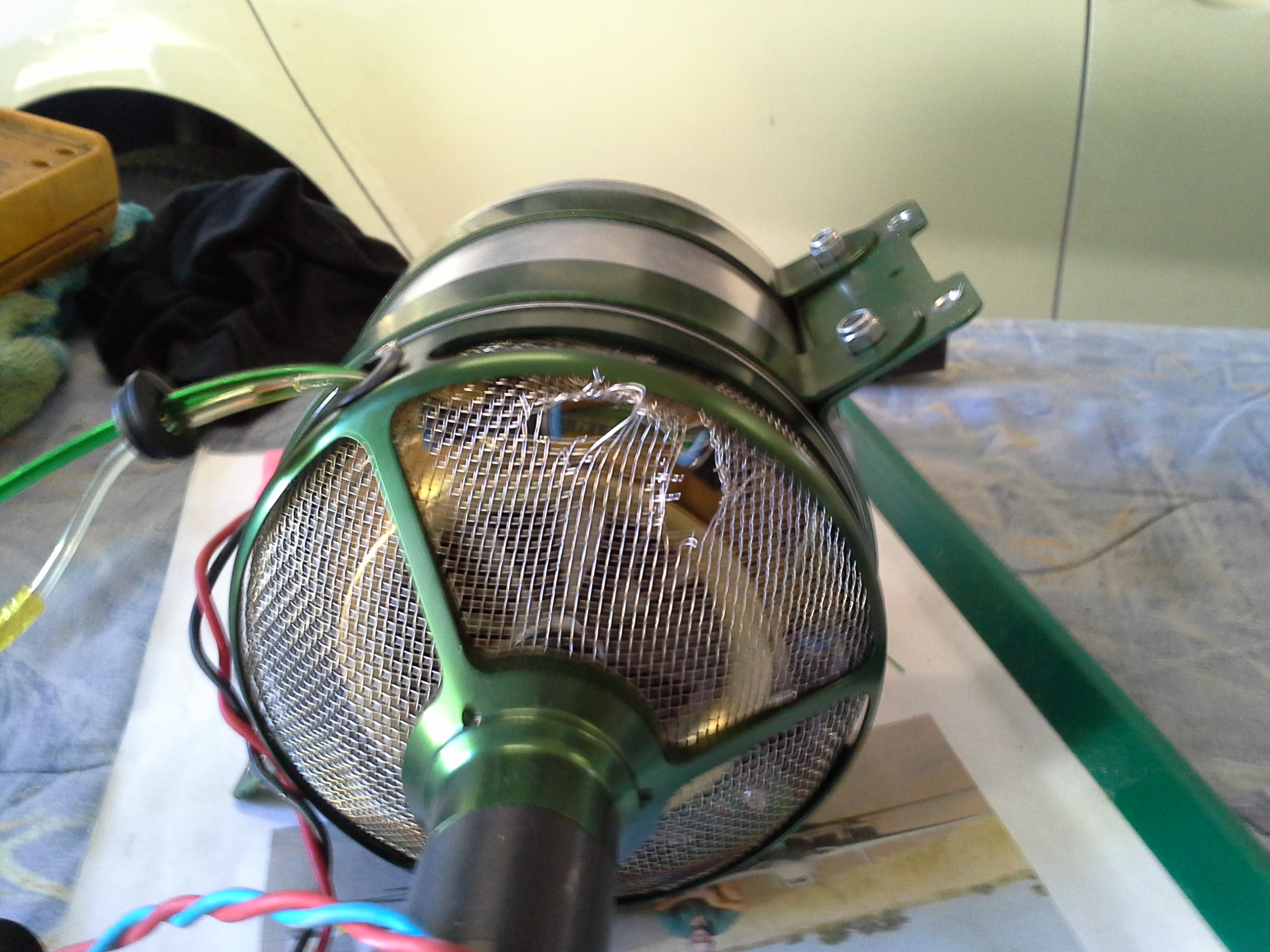

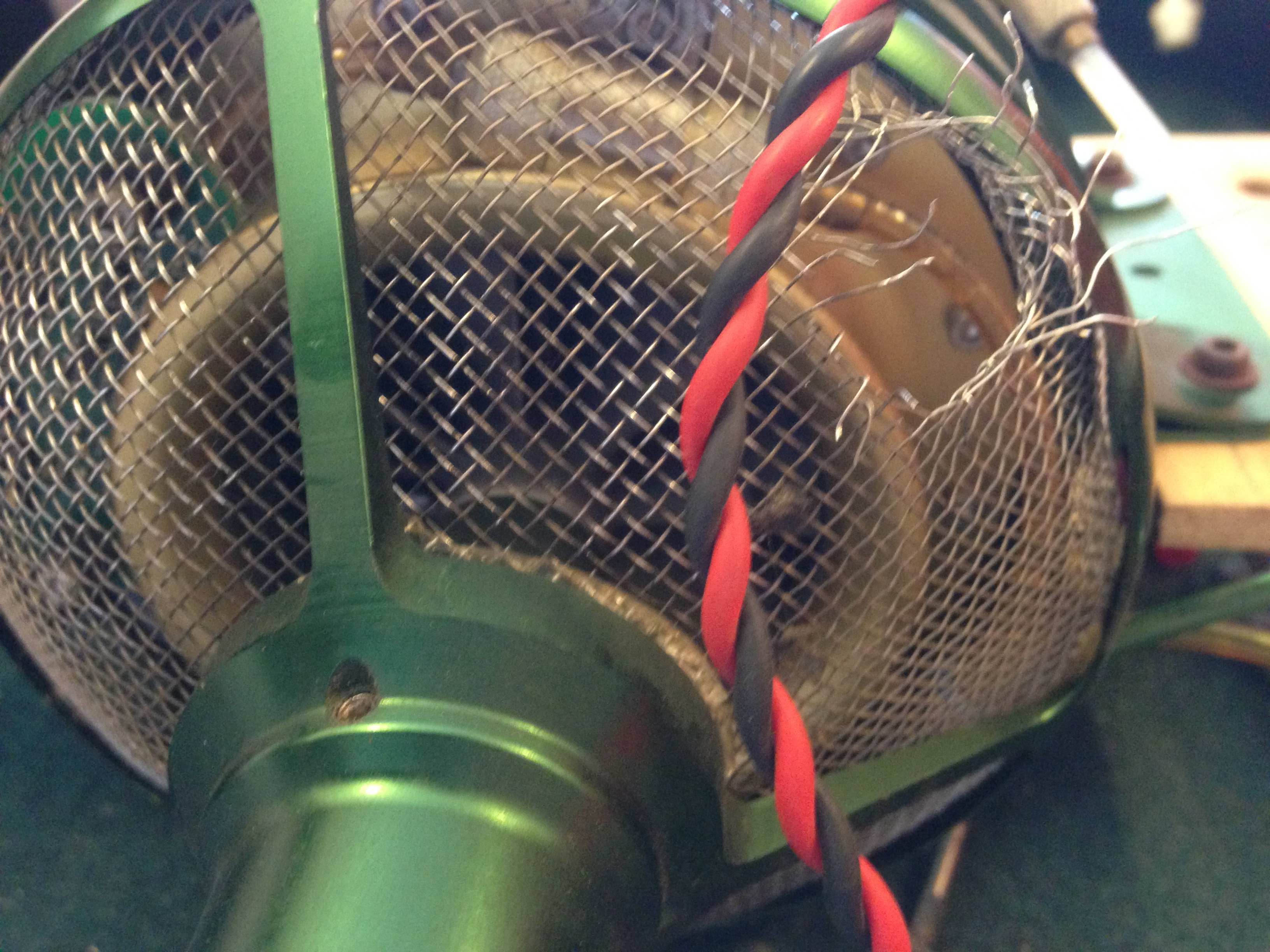

I have attached some pics from the latest incident.
Please bear in mind the engine was nowhere close to its service interval and thrust was limited to 112k RPM on the ECU
Wren of course has been gracious enough to request me to send the engine back.
The engine is back with Wren.
But the fact remains that Wren deliberately chose to ignore this matter and as a result I have a hole in my fuse and unnecessary damage sustained to the airframe.
