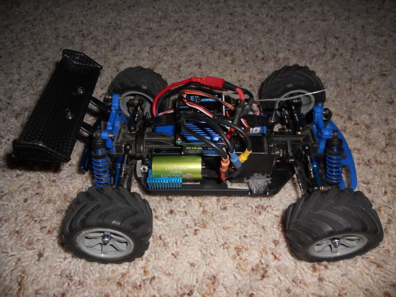

Here is my brushless RC18T. Its not anything special yet I have only clocked it doing about 60 MPH so far. But I have a few new brushless systems on the way that should make it a real screamer. They should be here on Tuesday.
So if you are building something fast show it off here! If you have questions about motors, gearing, tires or whatever ask them here. Lets see your pics and vids of speed runs. This will not be model specific just anything 1/18 scale that is fast. I guess 1/16 will be allowed as well. Some of the mini revo guys think their cars are fast![X(]
So lets get this thread going! How fast can you go?

Having done some testing myself lately, I would say 6000kv is probably about optimal in a micro motor on 3s, as a balance of rpm, torque and heat. I can't speak about the larger cans as I haven't tried them.
Above all though, see my signature below. Then refer to another great RC adage. "Speed costs. How fast do you want to go? "
Yakfish, I may have missed that you are using a 25A speed control in an earlier post, but now you've brought it to my attention, I can tell you that it will be tough to hit 80mph with only 25A. You need to be looking at a 40A at least now (minimum!), especially if you have your eye on that slightly bigger motor.
Join Date: Dec 2010
Location: Livermore, CA
Posts: 249
RE: ***Official*** 1/18 Scale HIGH SPEED Thread!!!
ORIGINAL: Foxy
Guys, let me stress again, if you want to do crazy speed runs, you are going to be pushing the limits of the electronics. Every dollar put into your motor and ESC will be worth it. If you are serious about achieving those speeds you are going to need the best products there are on the market in terms of ESC, motor and batteries. It's that simple. Even my quite expensive Orion Vortex system is prone to high heat at 7500 on 3s and has to be constantly monitored, and I'm not even doing speed runs, I'm quite high geared.
Also, do you know how to figure out the necessary amp rating of the ESC I will be using? Is it based off of the mah of the battery pack(s) I'll be using?
