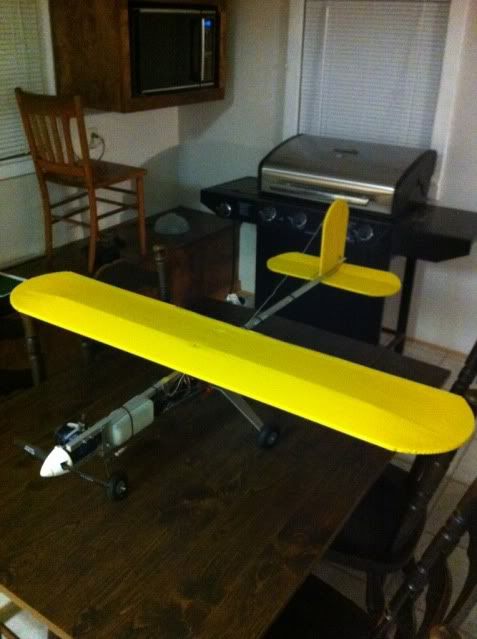

Hi guys, this will be my first post to the site in more than 5 years, but here we go. I finally got back into RC flight (read got divorced!), and I got a stellar idea from youtube! Apparently a few people here and there are building planes from the foam board insulation at home improvement stores. So....enter the "Ryleigh Roooo" My Daughter Ryleigh named it! Shes 3, lol.
This will be a complete learn as you go process. Basically Im hotwiring out the parts, laminating where needed, hand sanding airfoils and shape, installing some micro electric gear and going flying. It will be 4ch complete with ailerons, rudder, elevator, and throttle.
Yes it is going to remain pink when done as a tribute to my mom and breast cancer awareness. lol Enough talk here are pics.

Thanks man. Like I said its a learning experience. I dont want to type alot Im tired so here are the updated pics from what got done tonight.
There are a few imperfectons but I think Im going to brush something on the leading edge as a protectant and hopefully that will fill it up a little. Im thinking about using some thin paper of some kind soaked in a mixture of water and elmers glue, then lay that down on the LE, and get the bubbles out. That should strengthen the LE a bit, and cover the imperfections. Remember Im not painting this thing to keep the weight down, so whatever I use would have to look decent. Also this is only sanded with 60 grit. I still have to finish it with 220, and I havent shaped the wing tips yet at all!

Little divits can be filled with light weight spackle I get at Lowes or Home Depot. It helps to mist the spackle with water to dampen it...it will stick to the foam better instead of rolling off.
For big goofs, you can Elmers glue in scraps of foam...but beware of burying Elmers glue too deep or it takes forever to dry.

I did some calculations, and here are some specs:
Wingspan - 30.25"
Root Chord - 7.5"
Tip Chord - 4"
Average Chord - 5.75"
Wing area - 174"
Im hoping to get some work done tonight on her, and have some more pics to post late tonight!
Also I didnt realize it when I posted the project here, but I now know that 1/2a is for NITRO, not ELEC power planes, lol. Sorry. Believe it or not I did find an old 1/2 built Ace GLH, so possibly a speed plane project coming soon.

For a balsa sheet tail, I use aluminum TIG welding wire....1/8" for most stuff. Pick a bendable alloy that doesn't crack.
Otherwise, for a foamie....I'd probably go with birch dowel joiner and cross drill it so I could push a few bamboo skewers into each elevator half.

Once again, the pics are fairly straight forward. Feel free to tell me how wrong I am doing this! lol

Though I do feel the need to question the thickness of the tail surfaces. 1/8" balsa sheet would work better, but wouldn't look as scale.
With such a thick chord, elevator response will be dampened. And drag will be increased. With planes this small, having aerofoil shaped tail surfaces makes zero improvement over a flat sheet.

Dito on the stab-thickness. Why not simply put a balsa-sheet stab?
The attachment of the landing-gear is a little odd. The wire part that runs along the wing is usually allowed to twist, like a torsional spring for the landing gear.

Landing gear is correct, just put a little Vaseline on the part that's going to be embedded with the carbon-fiber tow acting as the torsion bar. You might want to put something to help the top of the strut from pulling back on landing.

The landing gear is 2mm pushrod so it doesnt have much spring at all. I wanted something going back in the body to keep it from just rolling back when I landed. After all I AM using hot glue to hold them in, lol. I will do more research for the next build for sure.
Soarrich do you mean the landing struts? IDK what I could do, any ideas?

The top drawing would work to keep the gear from being peeled off in a rough landing. The second transfers the load much better to the wing.
Why put landing gear on it anyway, it will fly better without LG, and you have very little chance of it ROGing if you're on grass, and on grass the gear is just going to flip the plane on landing unless you a landing on a putting green.[]
