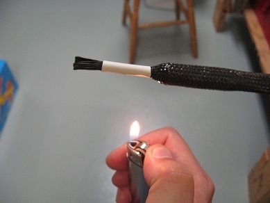

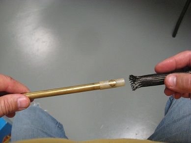

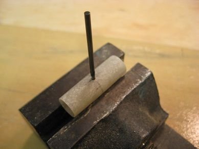

Used some carbon pushrod material to fabricate locking pins - stuffed with wooden swab dowel pin material. Here's something I learned from Trusted Source: turn in drill press while using drum sander chucked up in Dremel results in nice round end...
Cut wooden blanks and fabricated six "bearing" hard points for the locking pins - pivot point on block next to disk sander required use of duckbill pliers to turn the parts next to sander. There's probably an easier way to do this but I probably don't possess the skills and/or equipment to tackle it another way.
Stacked and aligned right and left fuselage side parts, drilled for, and inserted the bearing hard points.
Traced the firewall, formers, and servo tray then attached to appropriate material and rough cut with band saw. Used Dremel and carbide cutter to open up all the big holes, then sanded interiors with drum sander and perimeters with belt/disk sander. Final sanded all parts by hand.

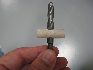

Transferred angles to balsa scrap to set sanding table and sanded in angles on firewall sides to mate up more accruately with fuselage sides. Combination square shows offset.
Tack glued sacrificial, balsa scrap to back of firewall with desired 2 degrees down-thrust at appropriate height and glued firewall to fuselage sides. Placed fuselage above plan view to work over centerline and weighted to immobilize; used square to transpose top of firewall and tack glued firewall in place with CA. Sprayed outsides with Windex to hopefully relieve stresses in wood bending toward firewall.
Fabricated and fit balsa doublers both forward and aft of firewall; applied 30 minute epoxy and clamped to set.

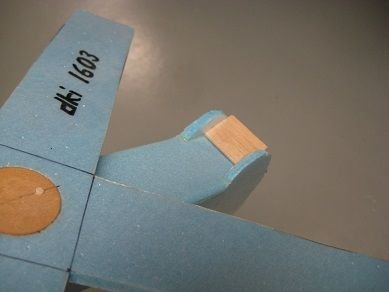

Added details to top view for pylon construction; of all balsa construction - 1/16" base and top with end-grain build-up sort of like an egg carton.
Since the inside of the aft fuse is open, it needs to be Monokoted - inside and out; prepped insides with perforating tool and hair spray and sanded between coats. Spaced out aft fuselage sides from hinge knuckle box and forward fuse with 1/64" shims, measured the separation between sides, and created a spacer block from scrap ply. Added top sheeting to aft fuse sides; had to fit last piece of sheeting between vertical stabs and use some narrow scrap door remains clamped off the end of the bench to reference a flat surface to clear the tails. Since the aft fuse is basically an open box structure (the bottom is open - think very thin "C" cross-section here), there is no real strength and this concerns me as there is such a thin bonding area with the adjacent sheeting. I'm looking at adding a ramp on the inside of the aft end of the fuse - where there is room - and triangle stock to the area between the vertical stabs hoping to try providing more support for the rather flimsy tail-end. Wasn't sure if this ramp would impart a lifting force on the tail driving the nose down so investigating flights with mods to my foamy chuck glider...
Last three pics showing all the major component parts and assembled airplane of both un-folded and folded modes.

Evaluating flimsy balsa aft fuse for reinforcement: Placed balsa scrap between vertical surfaces at rear end on foamy glider and did some backyard testing - ramp on bottom doesn't appear to have any influence, so it must be in dead air since it's behind the hinge knuckle; just to confirm, moving ramp to top side resulted in pitch-up as expected.
Old 03-19-2020, 03:49 PM

Carry through reinforcement for the spar tube intersections: Using a surface gauge to mark the midpoint of some left over bearing tube - being close is close enough to work with, turning the part over and re-marking helps you find exact center - it's between the two marks. Began opening up a through hole big enough to accommodate the carbon spar tube by hand to keep it centered. Worked hole open slowly with combination of drills and round files. Applied carbon sleeve braid on over the glass tube for strength, taped down one end, pulled tight, and cinched down other end with heat shrink tubing.

Pulled the carbon braided glass tube off a waxed brass tube handle, trimmed the ends off, and opened up the holes in the center; checked fit with carbon spar tubes. Laid out and drilled #33 clearance holes and cut out two 1/32" ply disks, marked and cut out notches (look like "Pacmans") to clear corners of center section reinforcement block; feathered edges and bonded into center section (control distribution box) as reinforcement for screw attachment holes.
-Just for my own reference: edited pictures down to 10% before posting; last two posts (#47, #48) were at 15% -
