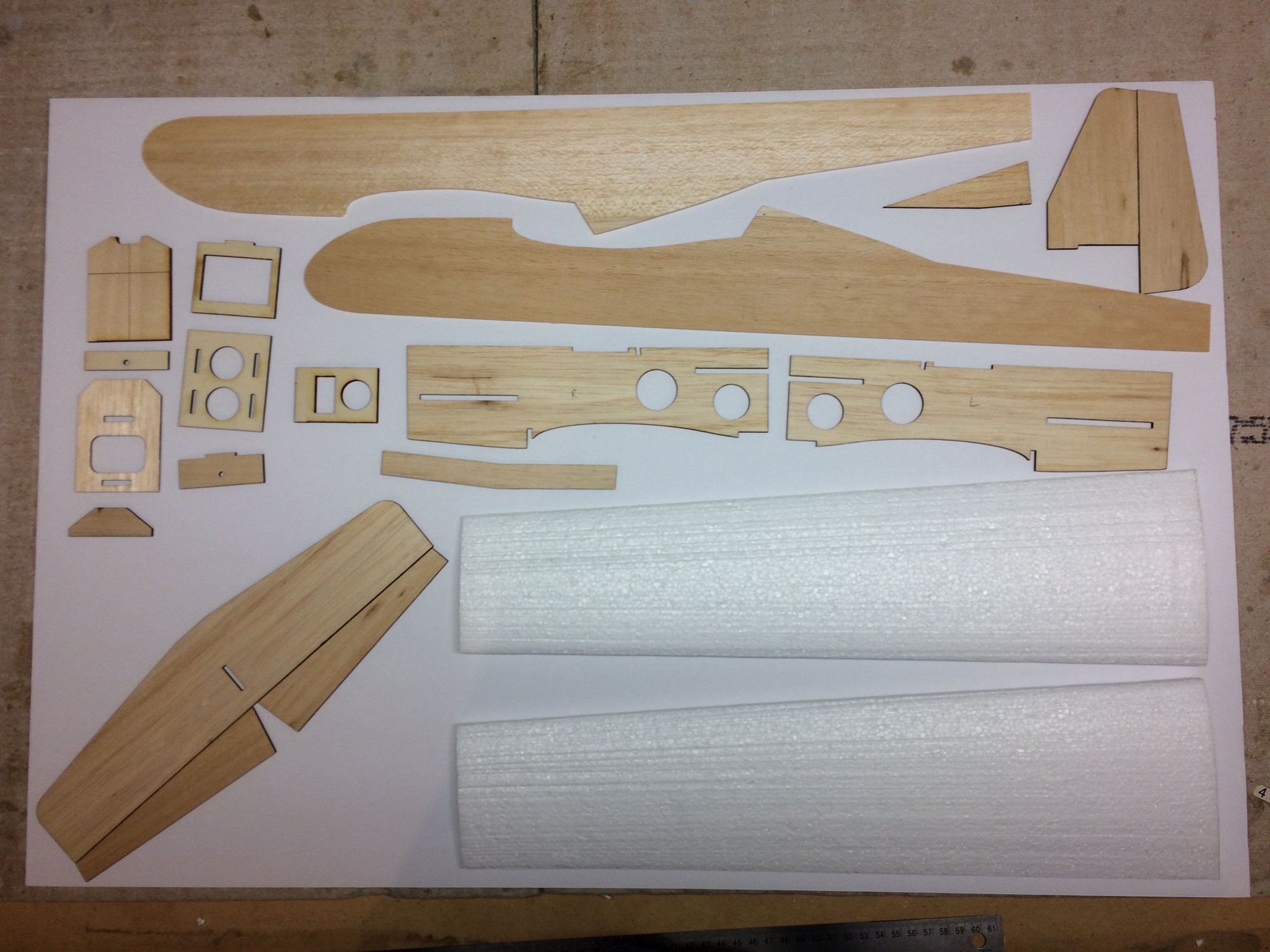

Last Christmas I bought myself a laser cutter; using the 3D CAD files I created of the mustang I made cut files for all the various pieces except the fuselage halves, which are too long for my little laser cutter. Here is my "kit" of the mustang:
I also made templates for cutting the wing cores. The cores shown in the picture were cut using a homemade hot wire bow and the templates I laser cut.

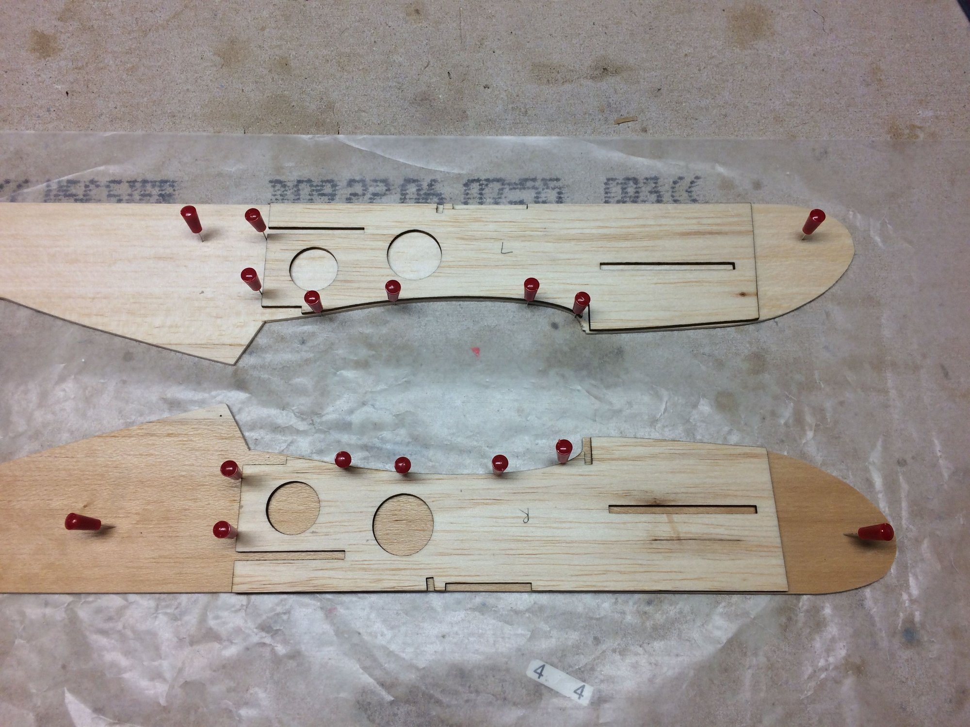

The build begins:
The small mounting plate in the middle of the last image, rectangular and circular cutout, was added after I took the screen shots of the CAD. I almost forgot that the Norvel will need a throttle servo, this plate will accommodate the throttle servo.
I was about to glue in the firewall when I realized that I need the wing to be completed so I can drill the hole for the 1/8 inch retention peg. I have put the fuselage aside and will start to build the wing before proceeding any further.

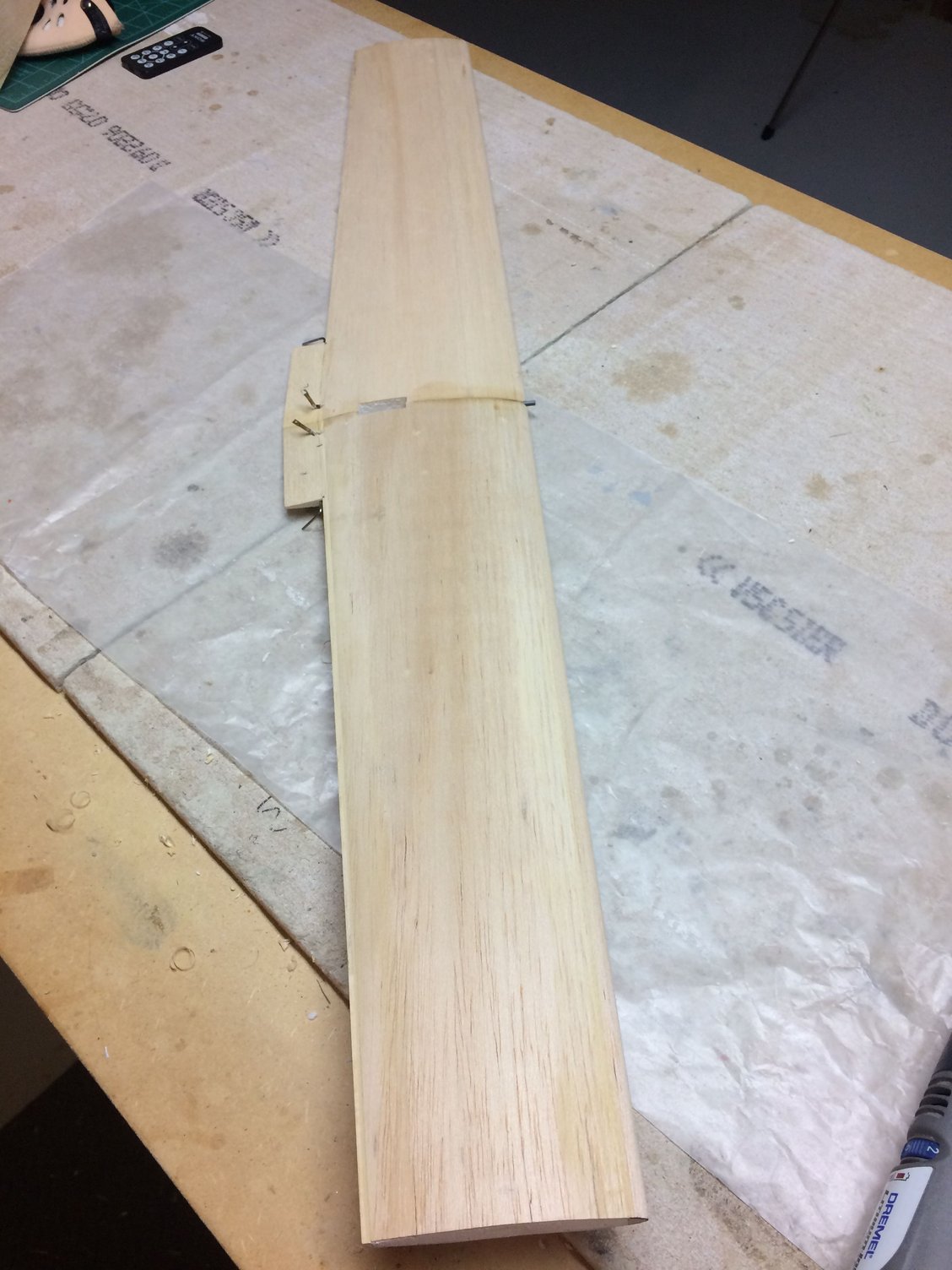

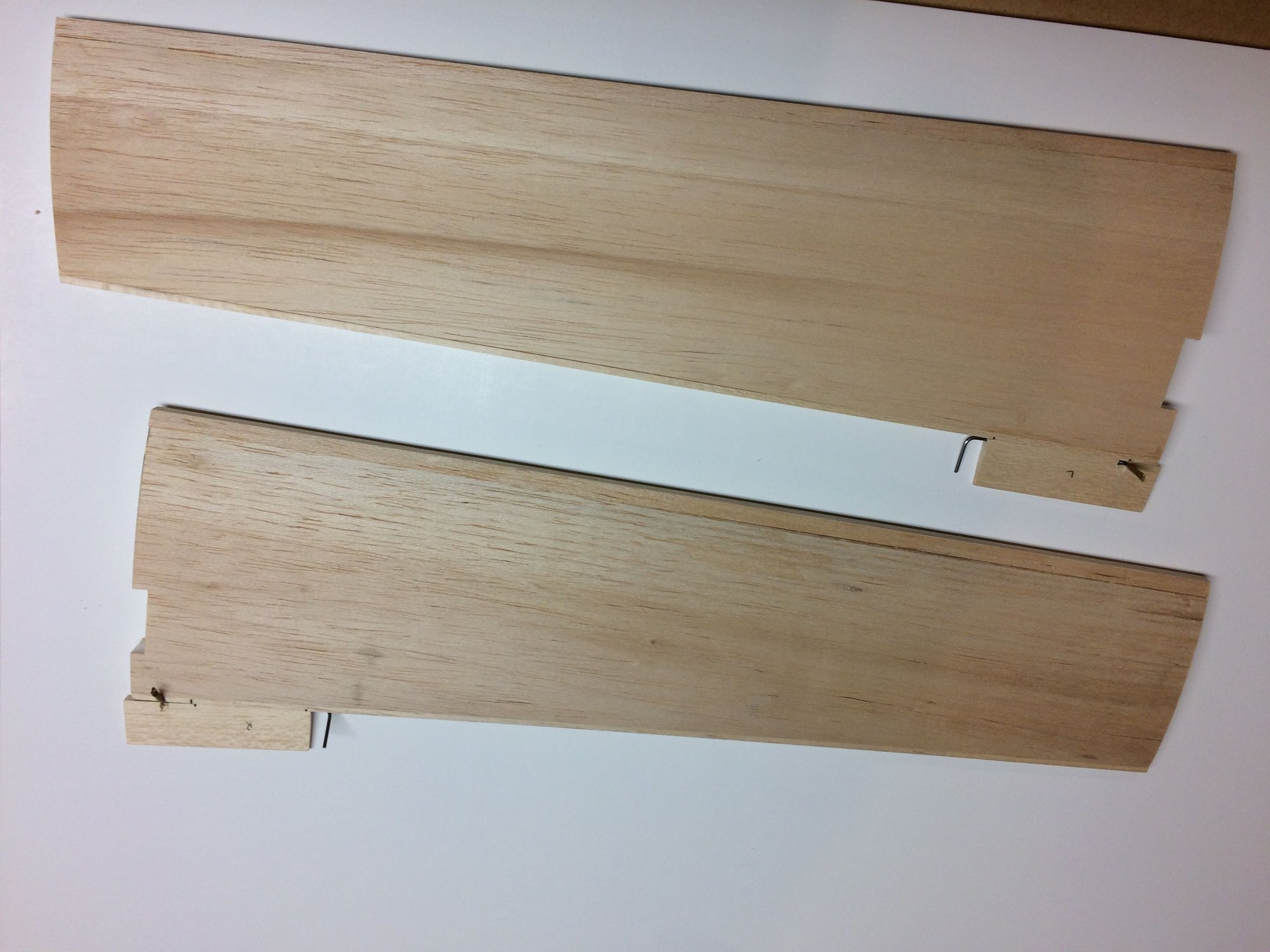

Finally had a chance to get back to this build.
Wing panels completed and ready to join. Strip aileron set-up has been installed as well as the trailing edge
Wing is now glued together and the retention peg is dry fitted. The peg will get glued in after the wing is covered.

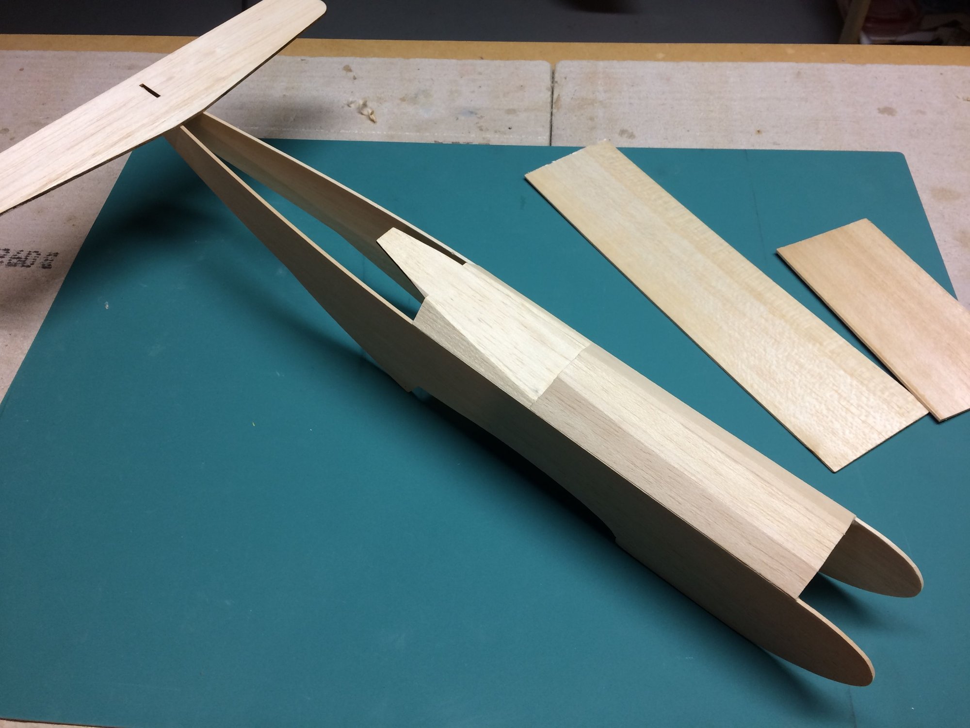

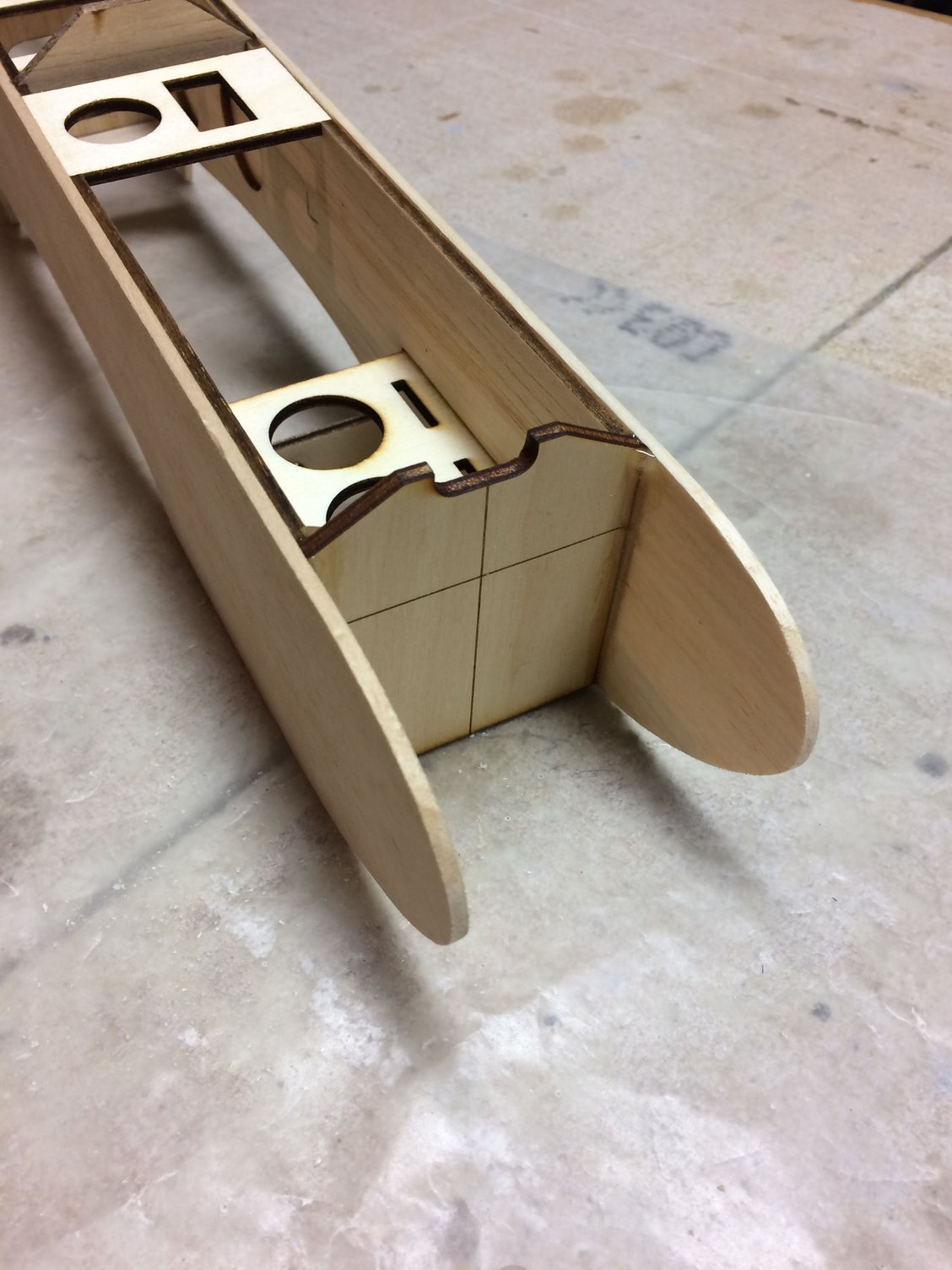

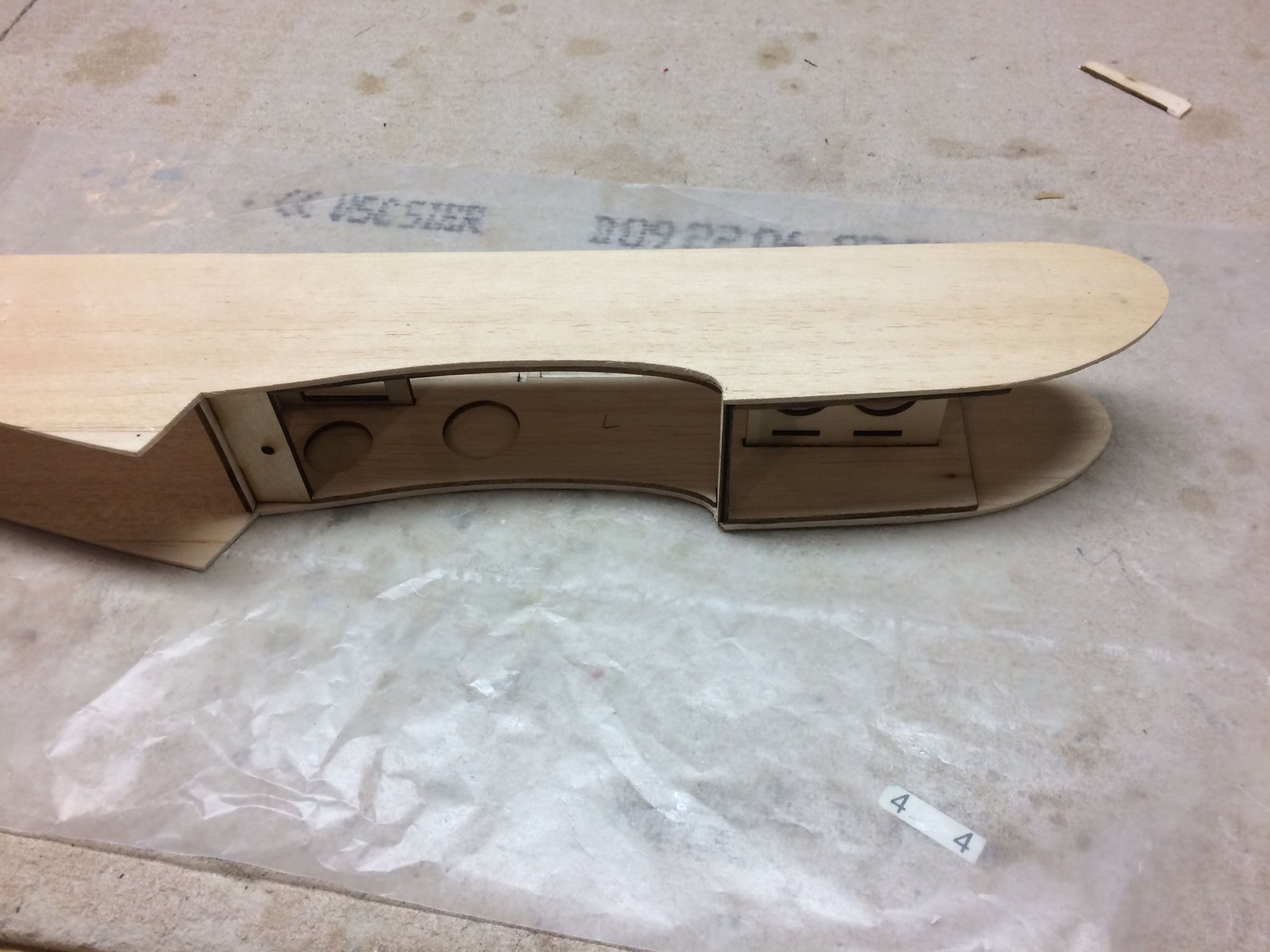

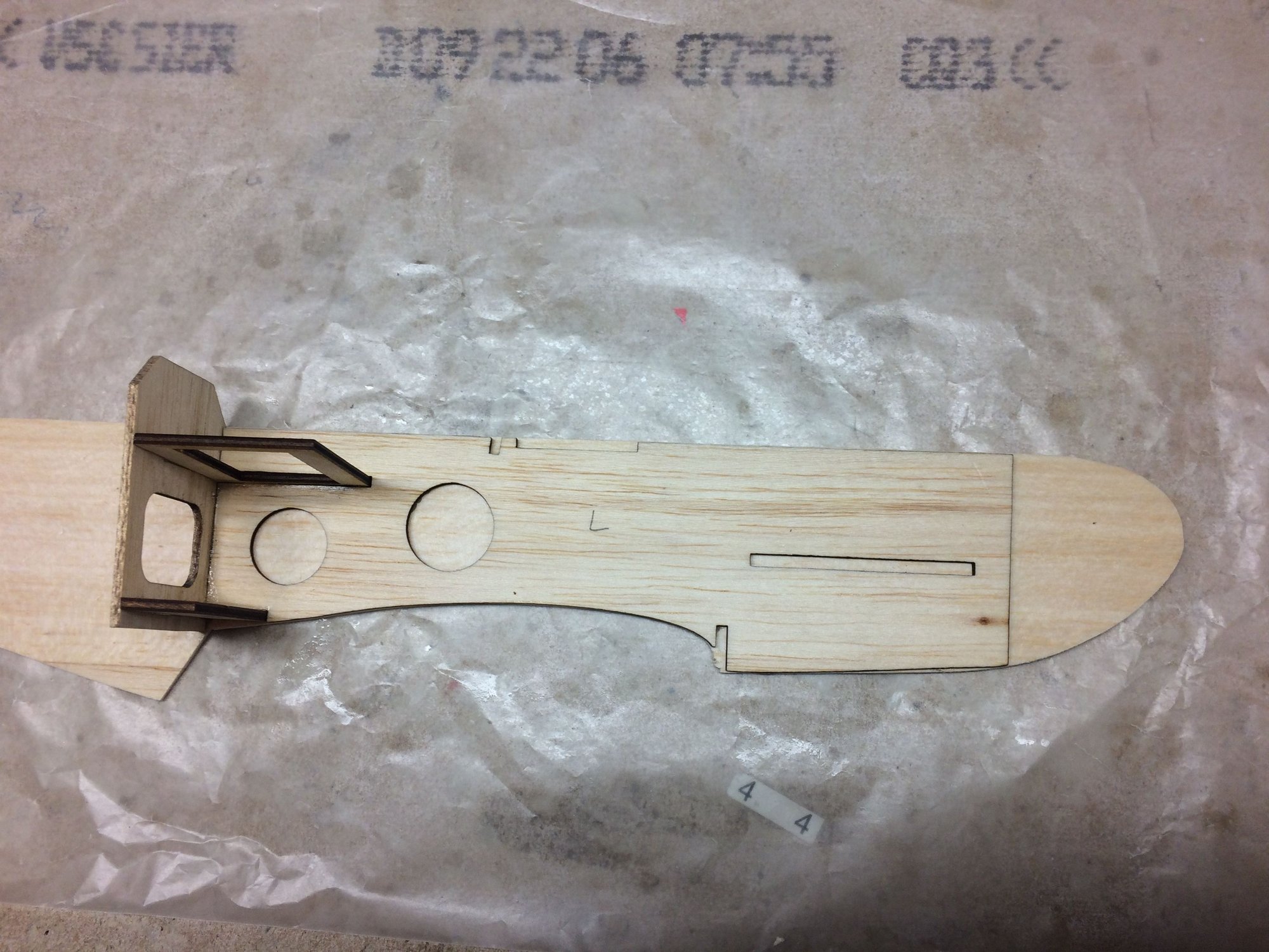

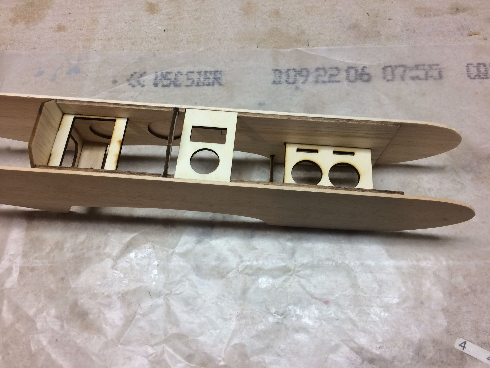

On to the fuselage build:
With the wing all sorted out I have glued in the firewall. The notch at the top is for the fuel lines to pass through. The cross mark was laser etched to help align the engine mount.
Cockpit floor installed as well as the forward fuselage sheeting. Took a little while to fit each piece, but there on there now. The stab is just resting on the fuse, it hasn't been glued yet.

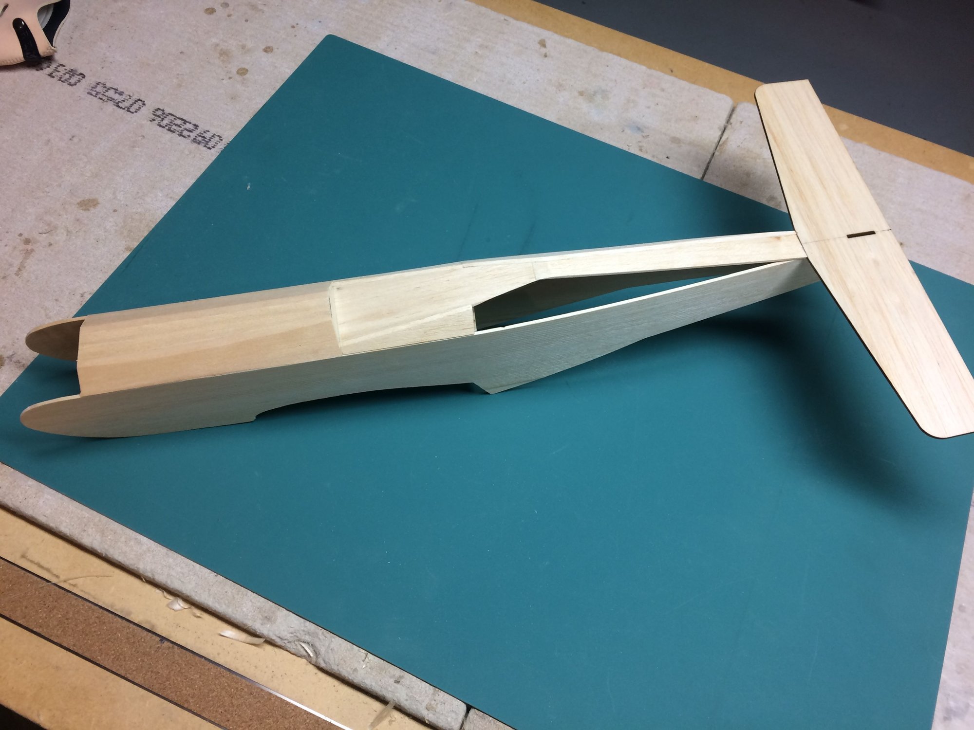

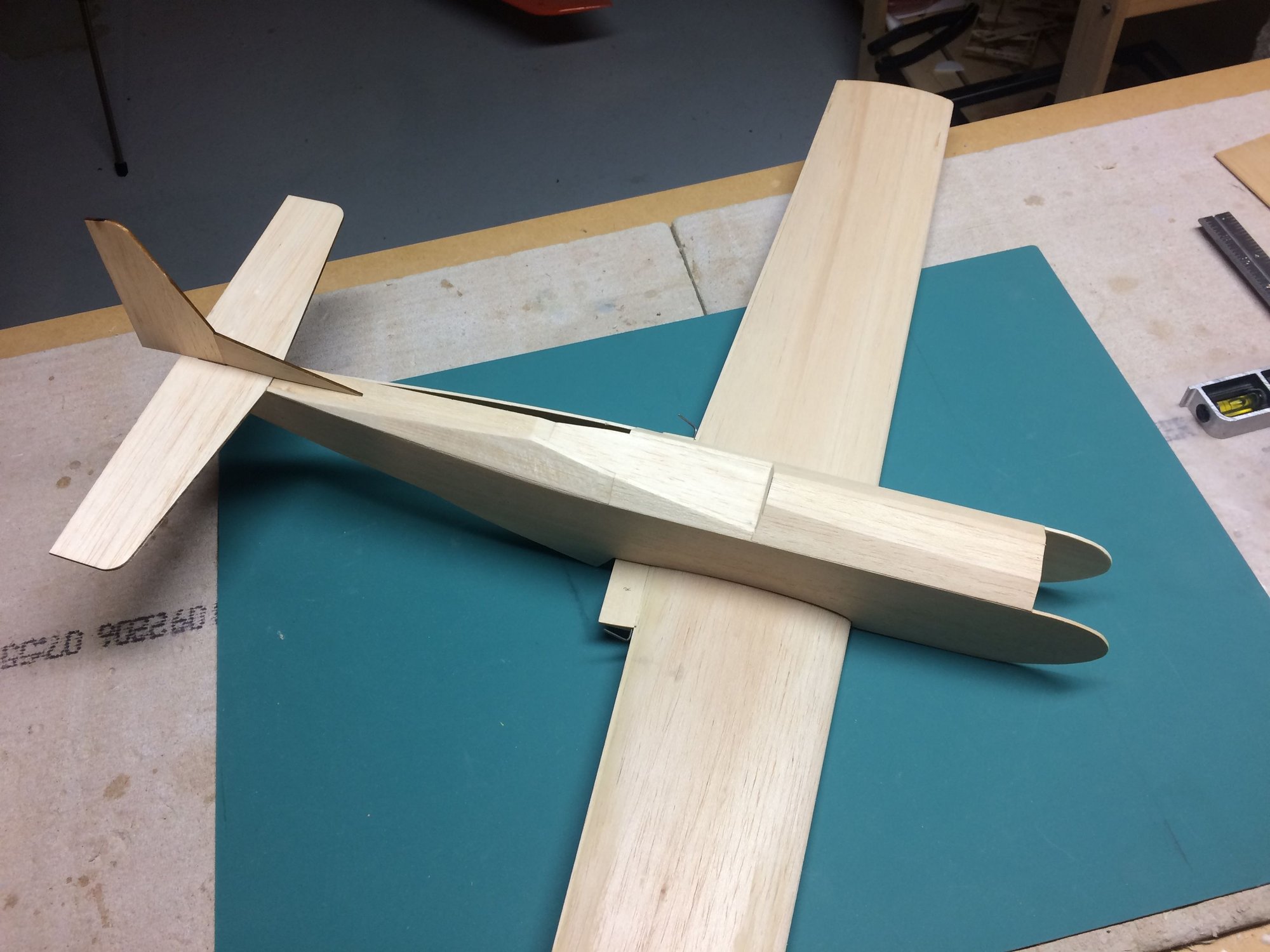

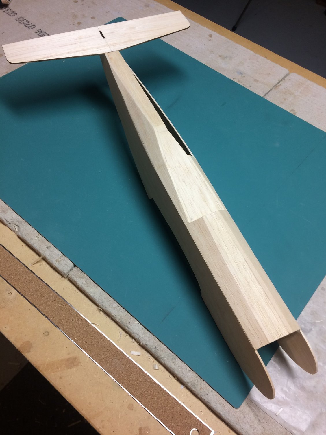

On to the rear fuselage sheeting
Stab has been aligned and glued in place. The rear, upper fuselage sheeting is almost done.
View of the fuselage from the other side. One more piece of sheeting and I'll be ready to start the sheeting of the underside of the fuselage.
A view of the fuse with the wings and the fin. The fin is just resting there, it will be glued on after the fuselage is covered. It's starting to look like an airplane.
The next thing I have to figure out how to do is the canopy. I haven't made up my mind yet how I will tackle that. I may have to build a "dummy" fuselage to build a canopy plug and then form a canopy from PET or some other clear plastic. Or i might just carve a "canopy" from a block of foam and paint it blue. We'll see.
