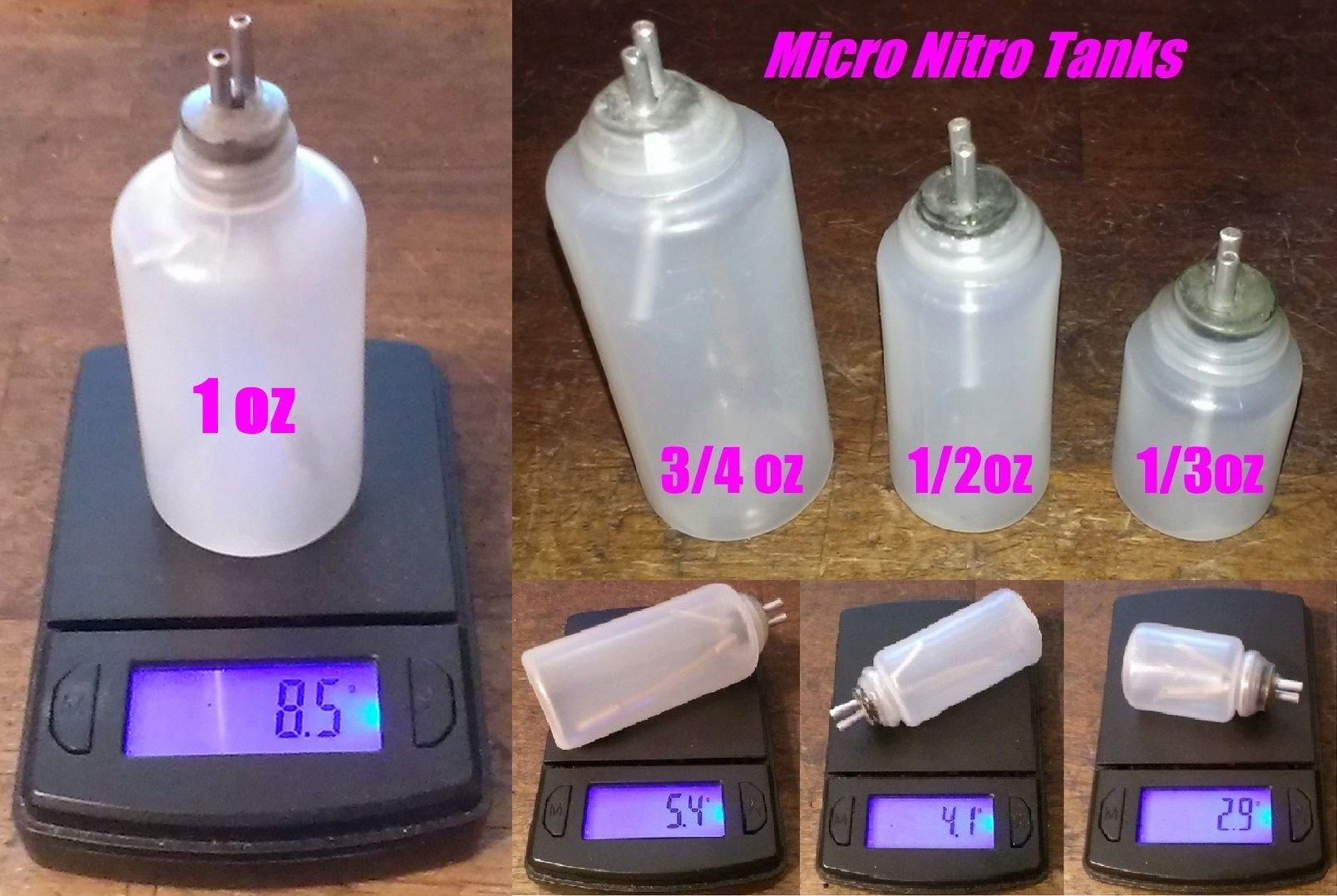

Tanks are easy with the right parts on tap. I have found a bottle type that works well with rubber test tube bungs.
Makes for a nice low weight tank all parts sourced off ebay. The bung / stopper is press fitted with a bit of glue then heat
shrink is used to keep the stopper from migrating.

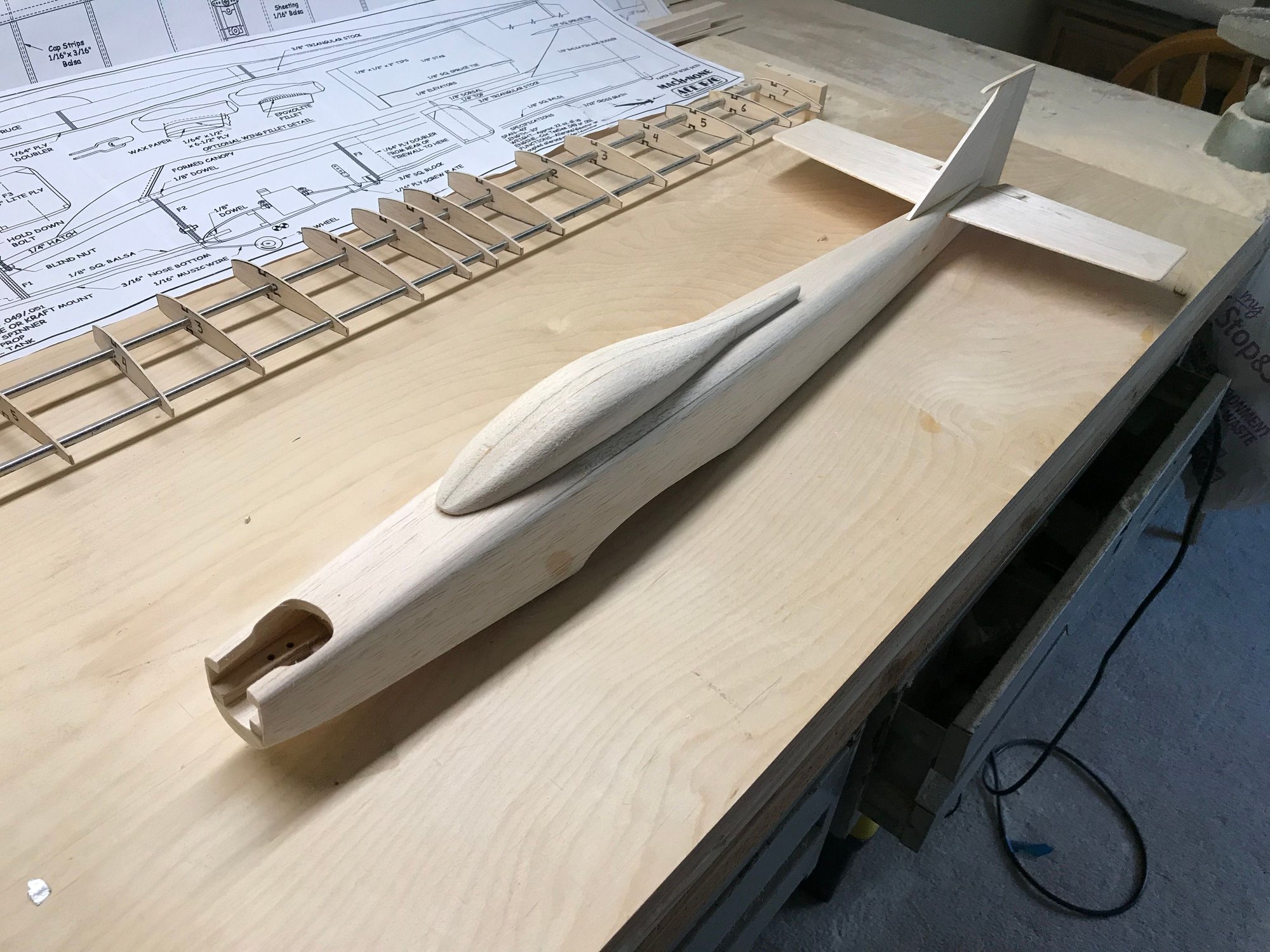

It has been a while since we had an update here. Here are some photos, I got the fuse all boxed in.

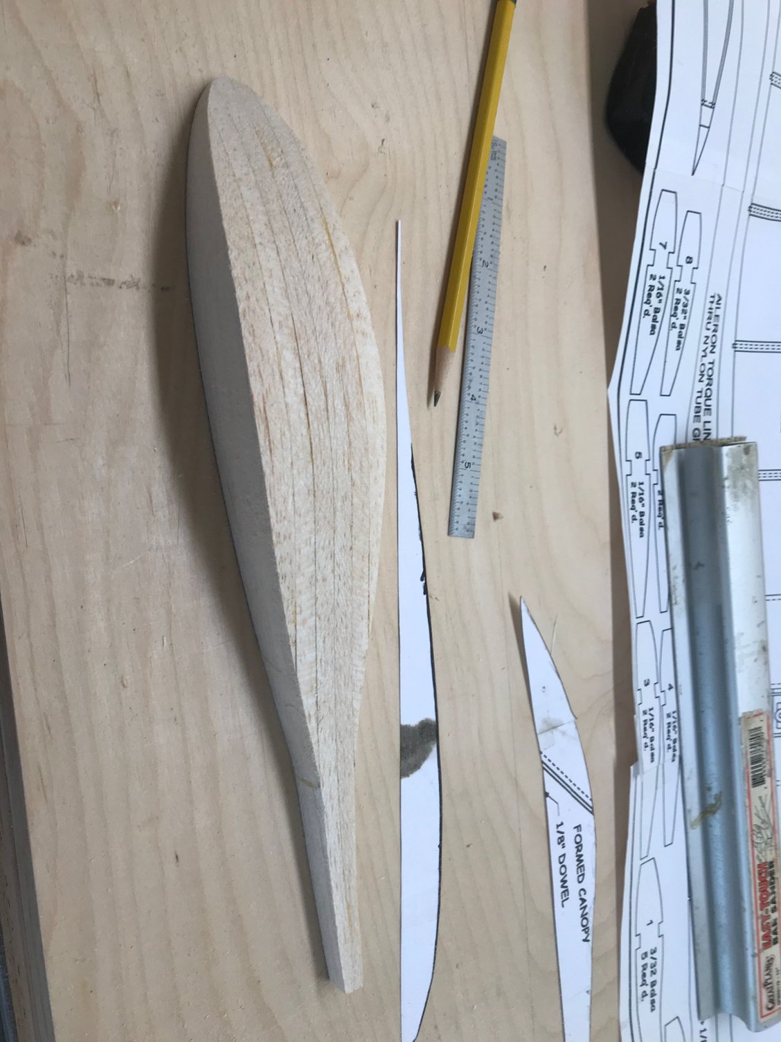

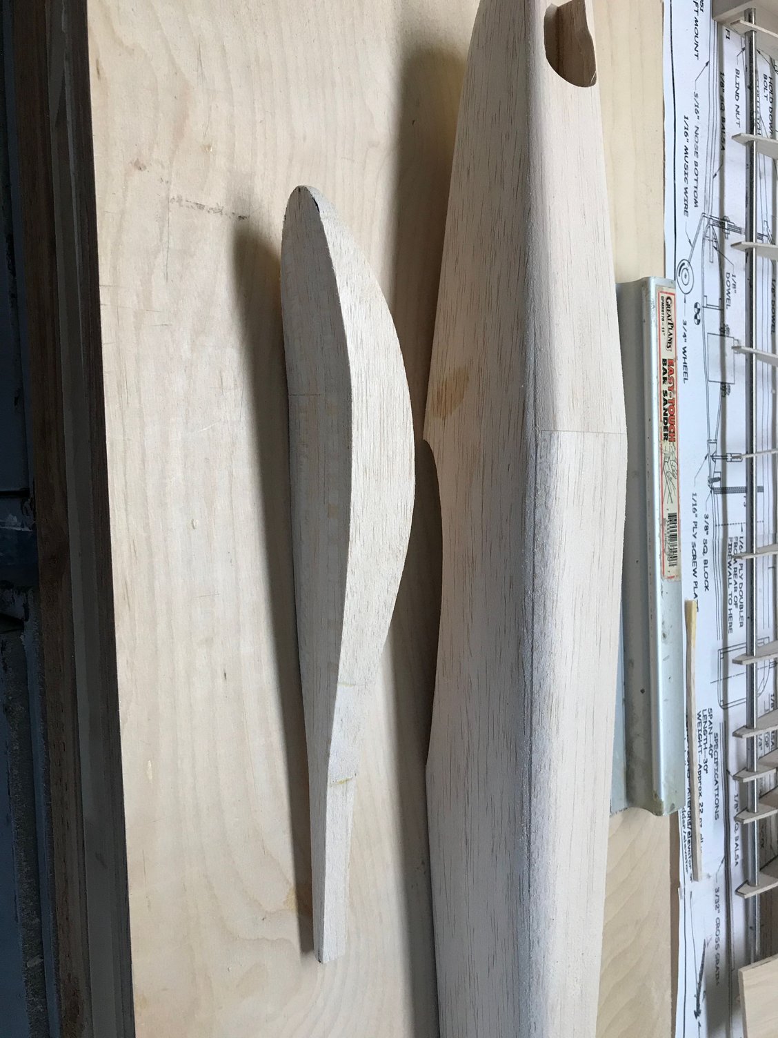

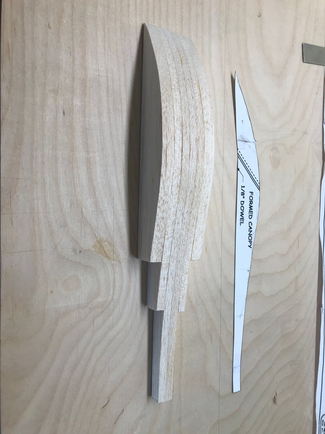

A little more progress. I mounted the horizontal fin (added elevator joiner) and vertical fin. I started working on the canopy. I am going to put the hatch on the bottom. I am trying not to deviate from the plans, but I do not have the vacuum formed canopy and I am not dealing with splitting the one I am making and putting the hatch on the top. I see a lot of difficulty in trying to get the seams to look nice on a hatch like that. I made the canopy from 1/4" balsa sheet. Enjoy!

Basically the fuselage is done, now on to the wing...
