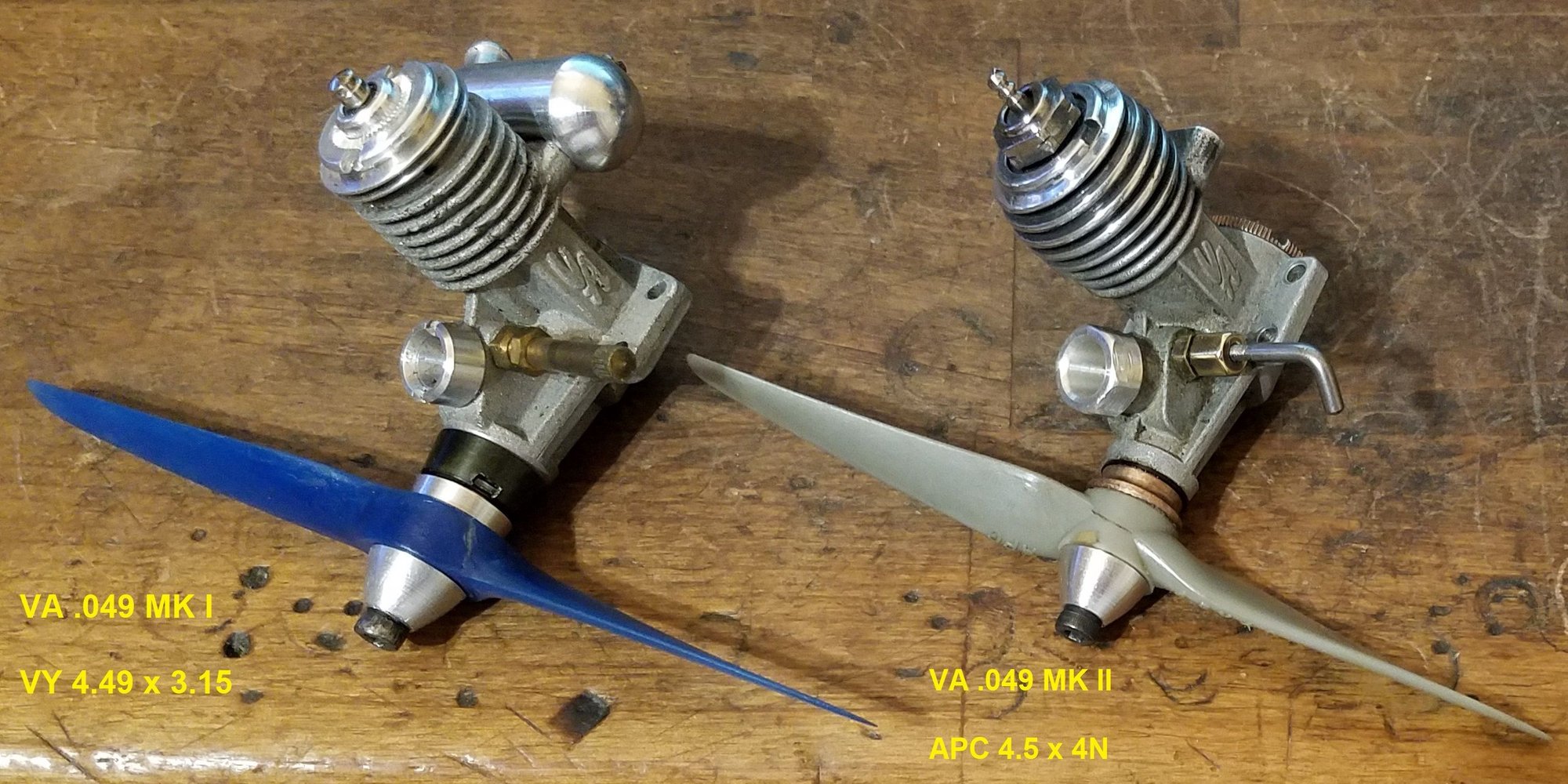

Received this MK II from Doug completing a nice VA .020 / MK I and II collection.
Dunno if I will do anything more then run them up for a power check comparisons to what I get out of the TD's and others.
CS sport engine mufflers work with the MK's / only requires 1 tap for a hex bolt.

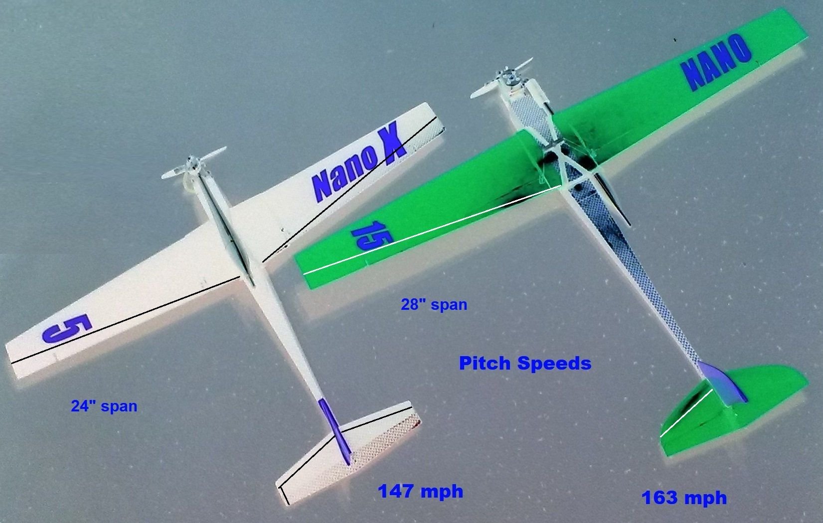

Note the fuel tank is glued into place to improve strength.
Awesome Doug hooked you up good to hear Chuck!
Bummer about the glass work being too heavy for 1/2A
Last pic show percentage changes after flying the N III
to get more speed out of the NX.

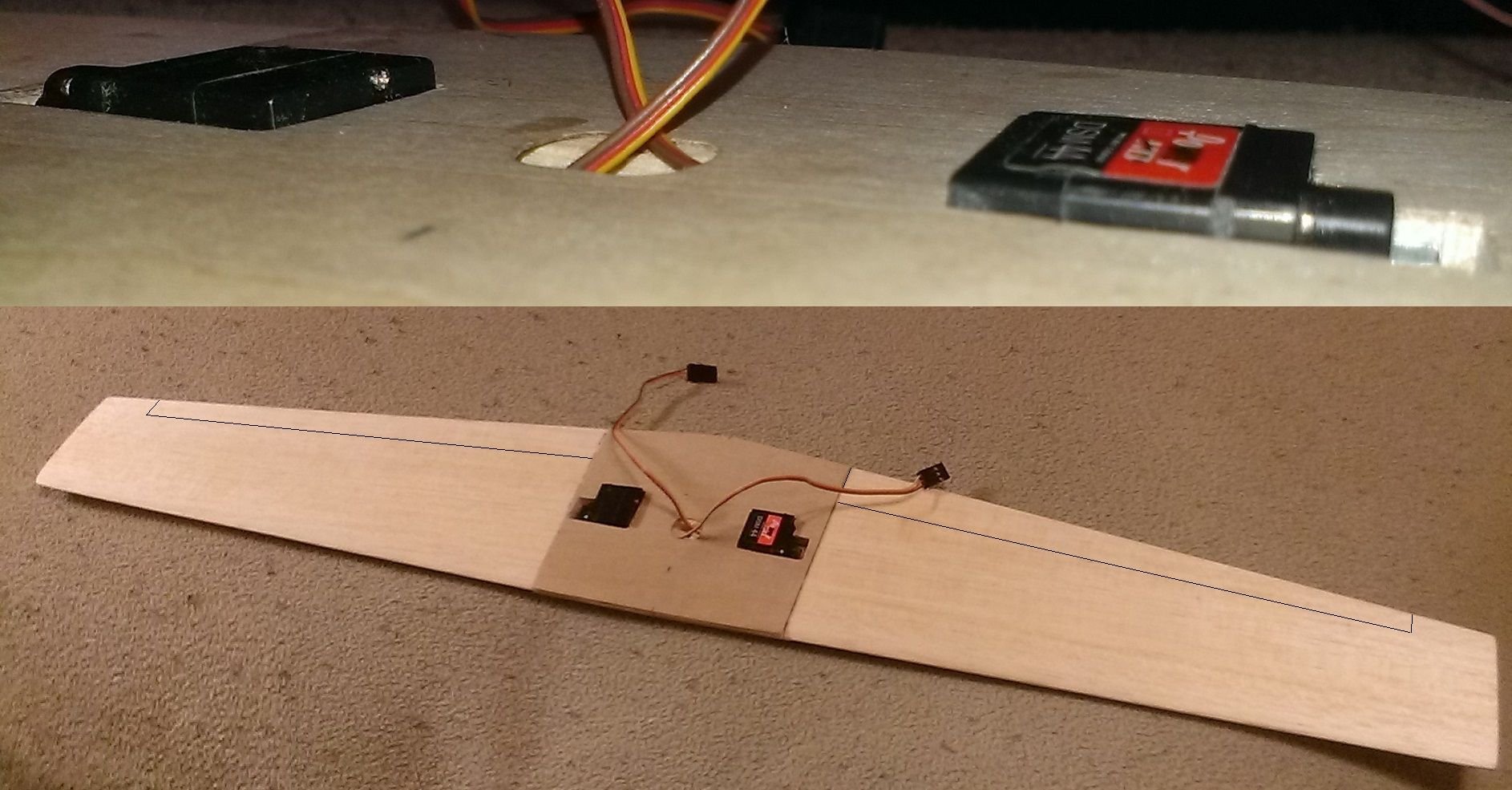

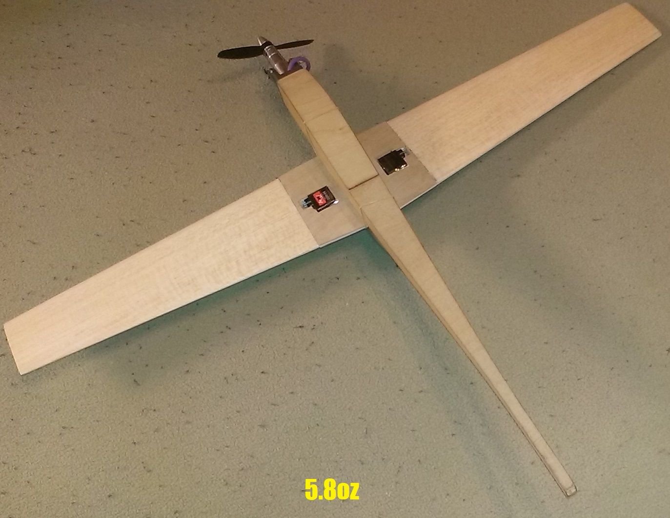

The wing gets 1/64th ply skin center wing treatment top and bottom with spruce front and back edges.
I use rubber bands as there is no space for bolting the wing on inside / fuselage is skinny with only room
for the gear. Proportions drawn around the gear. Looks like I went with the thicker ply sheet for belly landings
tail reduced to the thin stuff. Sticky back carbon pattern trim used to keep the servos in the wings. Servos held
well by having the cutouts with no slop. UVA and oil resistant fishing rubber bands.

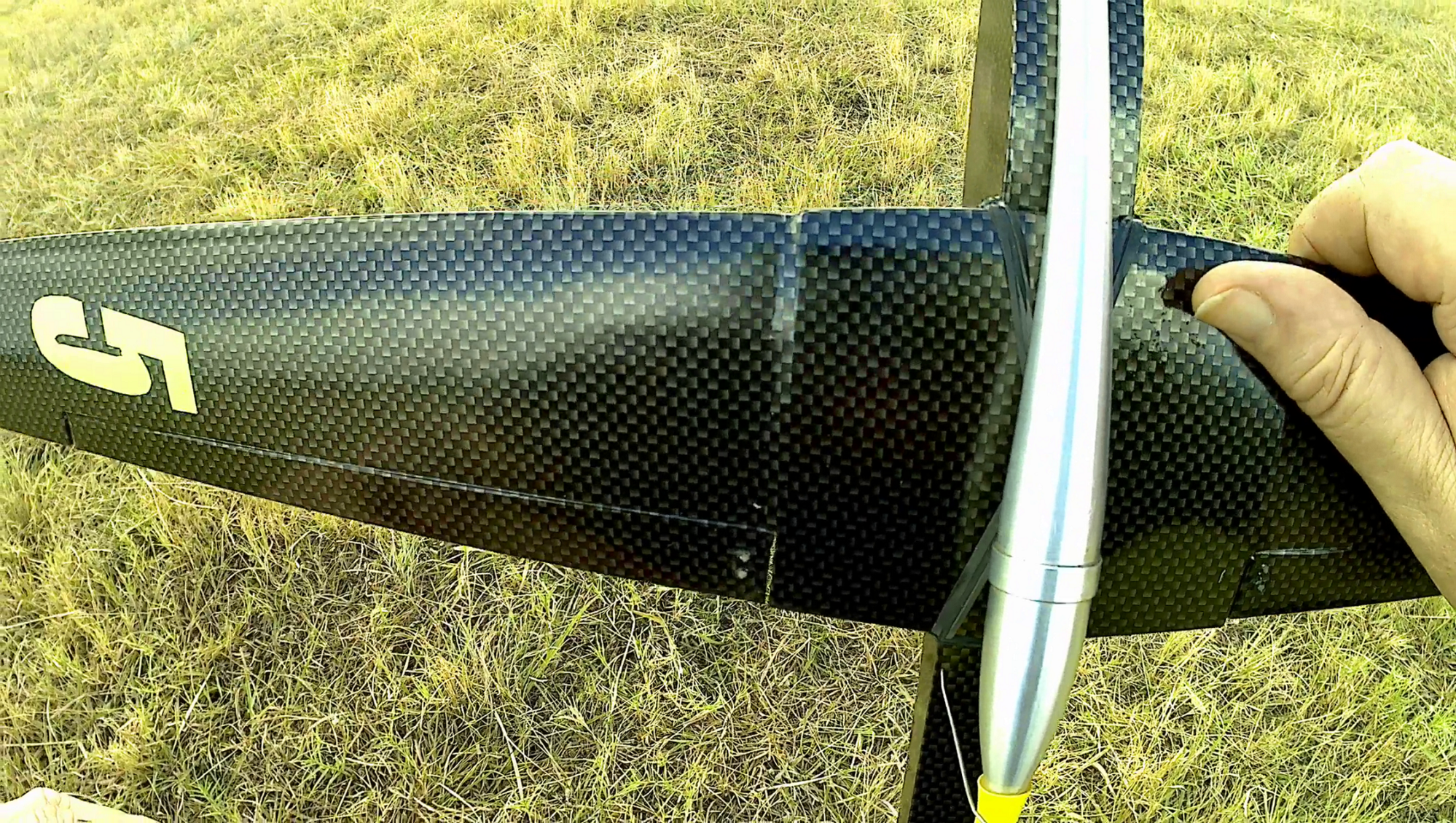

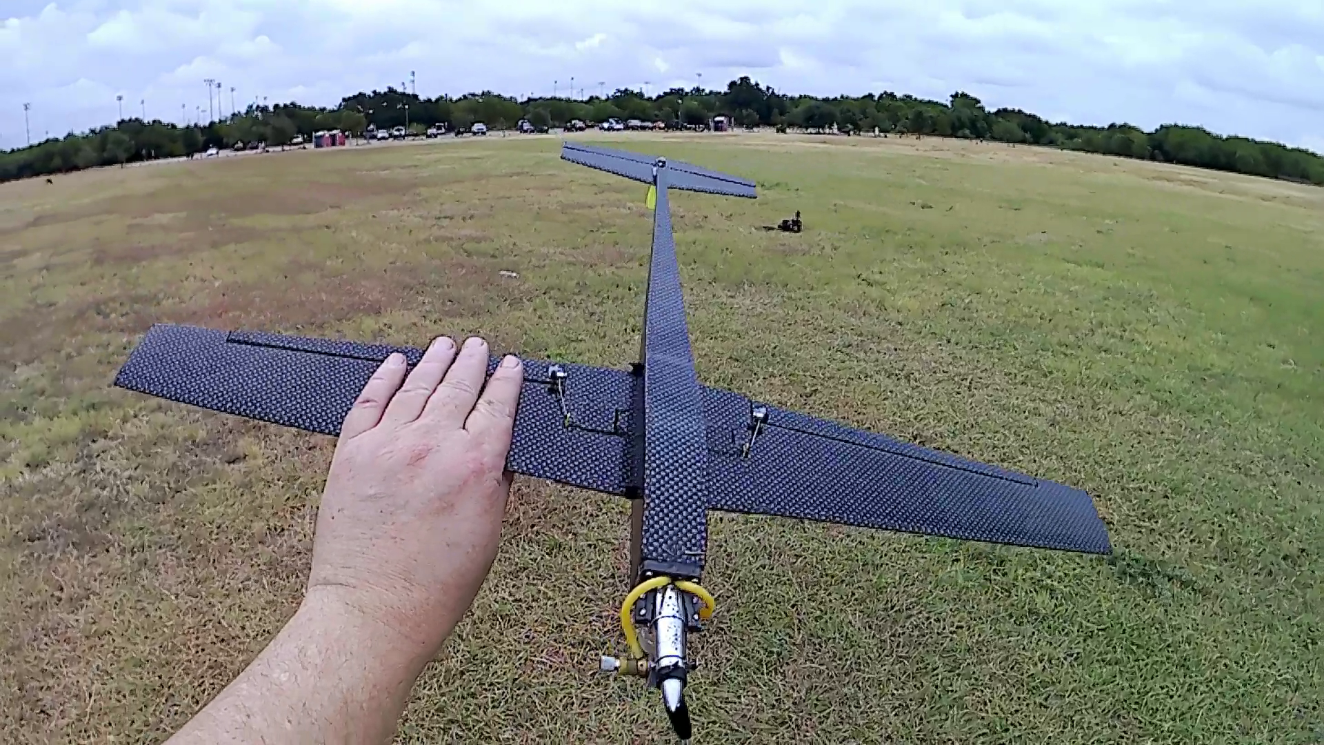

I like the carbon fiber covering. Does it behave like regular monokote..?.
I just got done laying up another pair of fuselage halves. This time with 1 layer of the heavy cloth and 1 layer of light weight [1.5 oz] cloth. 60 ccs of epoxy resin. Tomorrow morning we'll see what we got.
#33
Yes it's not bad to work with, thin and strong - low weight compared to Neon Monokote made by Hanger 9.
I will dig for a finished weight wood bare for comparison to the next glass fuselage.

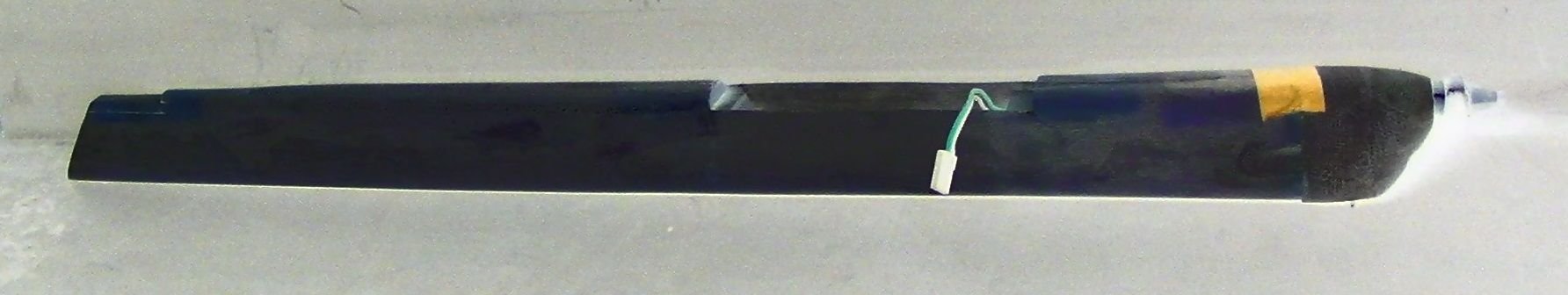

update for your comparison:
26.4g -.93oz competed hardwood box all sides and firewall.

I think the weight of the plane is within reason so far. I'm being as stingy as I know how with the cloth and the resin.
By the end of tomorrow I'll have a better idea about the weight because the plane will be much closer to being done.

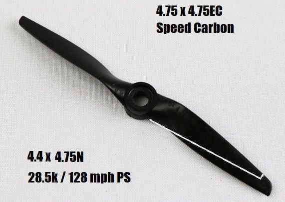

The .051 piston / cylinder set I am using with the NX is an old one from the 80's ran in my inboard outrigger hydro.
Lucky for me it was ran with SIG 25%- rpms over 30k whenever it bounced out of the water using a surface drive prop.
Down wind pass 4.3 x 5.5 @ 28,746 / 149.7 mph pitch speed / 143 doppler that's the best I have thus far.
Your the only other pursuing extreme 1/2A RC speed will be a thrill for me to see what you get out of the project.

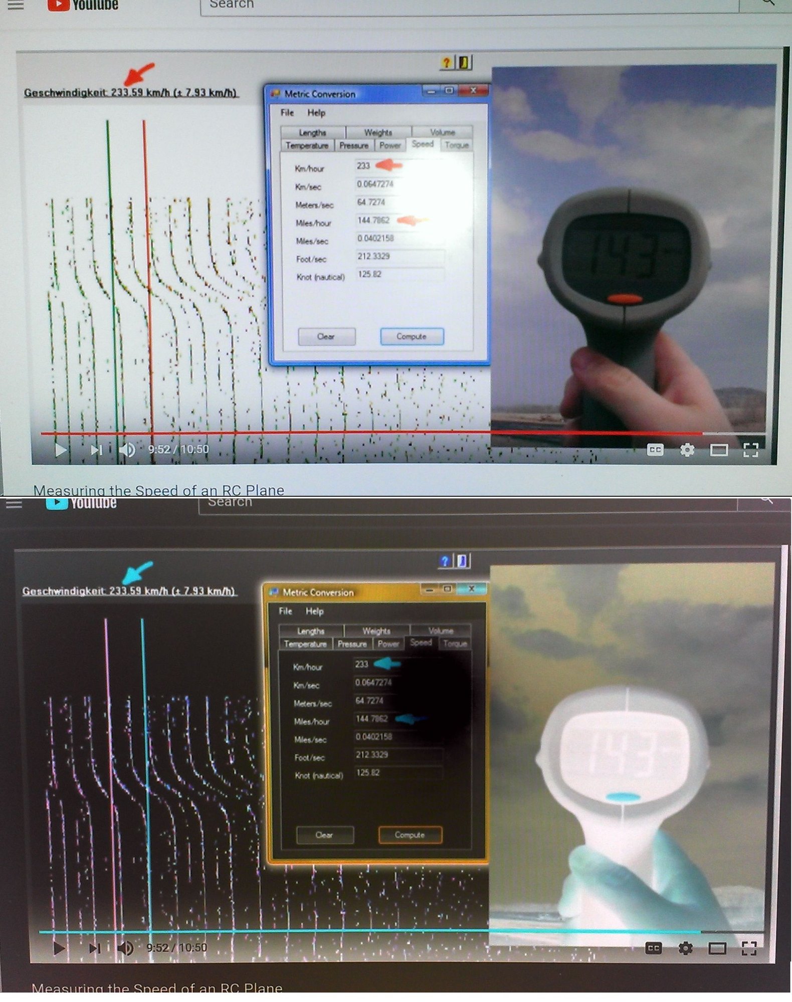

A good level pass in front of a camera is enough to check rpm quite accurately now with a audio tach app called "RPM Gauge" for android.
Wav. Scope works well enough for a doppler shift reading if blown up to full screen you can get the shift points on the money.
I also have a oscilloscope to read speed passes in hz. to convert.
See results from two methods match up within 1.8 mph 233 kmh = 144.8 mph

Regarding tail feathers I have tried ply it can be thinner still a bit of foil shaping starting with a thicker piece.
The upshot is stiffer at higher speeds thinner and able to battle tumbles. I use longer tail moments to get
away with smaller tail surfaces. Always foil the surfaces to help the back end sit at speed.
One was the usual 1/8" balsa sheet style, with the edges sanded to a fairly sharp edge. I am tempted to tissue and dope the wing and tail surfaces, then lightly paint the whole works with Klasskote. Just enough paint to be fuel proof but not pretty.
I have also laid up some carbon cloth tail feathers. The fin is 3 layers and from past experience will be .030" thick. The CF horizontal surfaces are pre-hinged with a strip of kevlar cloth as a continuous hinge. I pressed axle grease into the kevlar cloth where I do not want the epoxy resin to penetrate. So it is a sandwich of carbon cloth outer layers. I have my doubts how this will turn out, but at least it's a try. If it does work it will be nice and thin and of course fuel proof.
It might be a good idea to inspect this piece before the epoxy is totally cured so that I can make sure the hinge line isn't fouled with epoxy resin.

Awesome awesome great to see the design in the air Chuck!
Glide was easy on the ticker.
What a challenge the TD .051 becomes when max speed is the goal.
Easy enough with 38k performance engines or electrics.
The TD .051 can go very fast for those willing to go there.
Your at: vs / NX:
30 inch span / 24"
120 sq inch / 75"
11 oz RTF / 8oz
APC 4.2x4 prop / APC mod 4.3x5.5N down wind peak at cam: 28,746 rpm / 149.7 mph pitch speed / 143 mph doppler
Your Vid Stats:
In the hand 22,771
Passes near the cam: 25.45k to 26,162 rpm
Peak dive 27,697 rpm
I found through the process of designs / testing the closer you get to 1:1 the rpm can be milked / maintained in a slow
shallow 10 - 15° dive enough to hold rpm from declining too far before it gets in front of the cam / looking for rpm apex pass.
Found I could be at 85% thrust / weight ratio and maintain peak rpm in front of the camera but only with real steady locked in
passes no slip ups / corrections - straight slight angle down to keep the load low on the engine.
