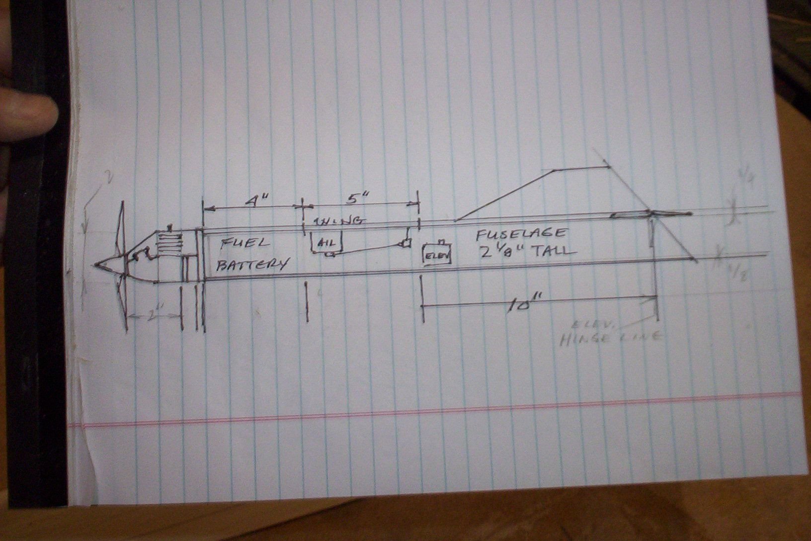

Hello to all fellow Cox TD abusers..!
The plan is to build as fast of a TD .051 powered plane as I know how to do.
The project will involve stealing some technology from what I've gleaned from others.
This wing will be smaller than what I've usually built. Credit for the smaller wing area than what I've used in the past goes to Amp Abuser's .049 Speedster.
The fuselage is based on the smallest frontal area / rectangular shape I could come up with. while using the stock engine mount lugs and a DuBro plastic engine mount. I suppose using a backplate mount would allow slightly less width up front, but I can't find the one I've got.
The engine is a brand new TD .051 I got for $85 shipped. I'll get a "baseline" RPM with a 4.2 x 4 APC on 22% nitro. Why 22%? I bought a jug of 66% Torco boat fuel and will use very basic math to cut it with methanol and castor.
I plane on shaving the inside of the piston
, detailing the crank fit, removing every last bit of rod slop, opening up the venturi to 5/32" and running it with a Nelson head once the TD head burns out.

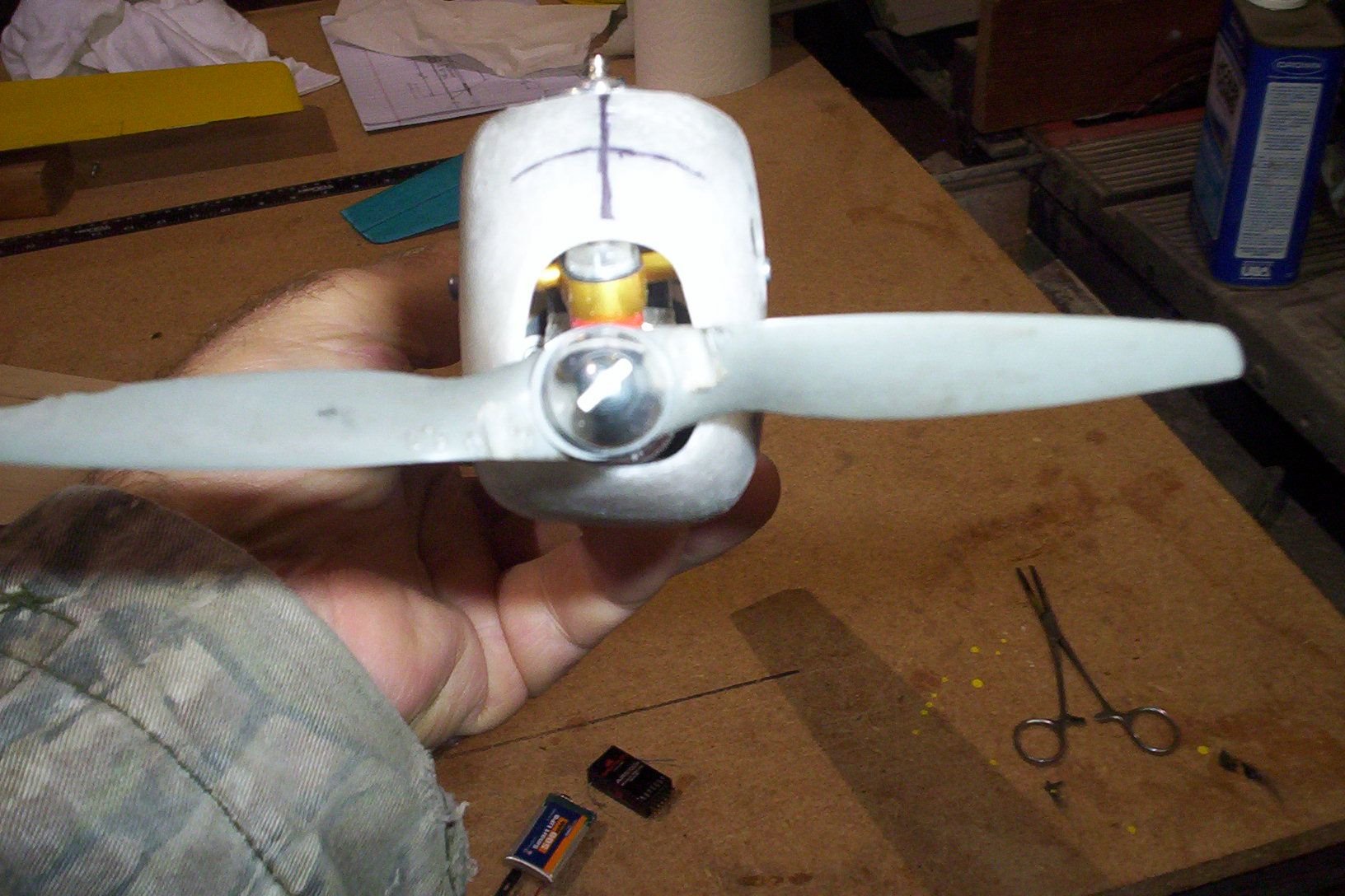

A tiny bit of progress today...I found a Galbreath / Nelson head for the TD and it responded with 25,000 plus...!
Much time was spent trying to make handling refueling and starting the engine convenient with a cowl that has such limited access to the fuel line.
I hate putting holes into the cowl of a plane that is supposed to have the least drag possible. Easy access to the fuel line with hemostats is the only practical way I know of for fueling and starting the engine. Routing the fuel line so I don't create accidental pinches is proving to be a PIA so far. The cowl comes very close to where the fuel line plugs into the nipple on the NVA.
The other SNAFU is the servos drift at rest [neutral] with the new Spektrum Park Flyer radio I just got. HS65 servos and a 6.6volt LIFE RX battery. The binding procedure was simple enough.
The new RX doesn't have any antenna whiskers which is nice [if it works].

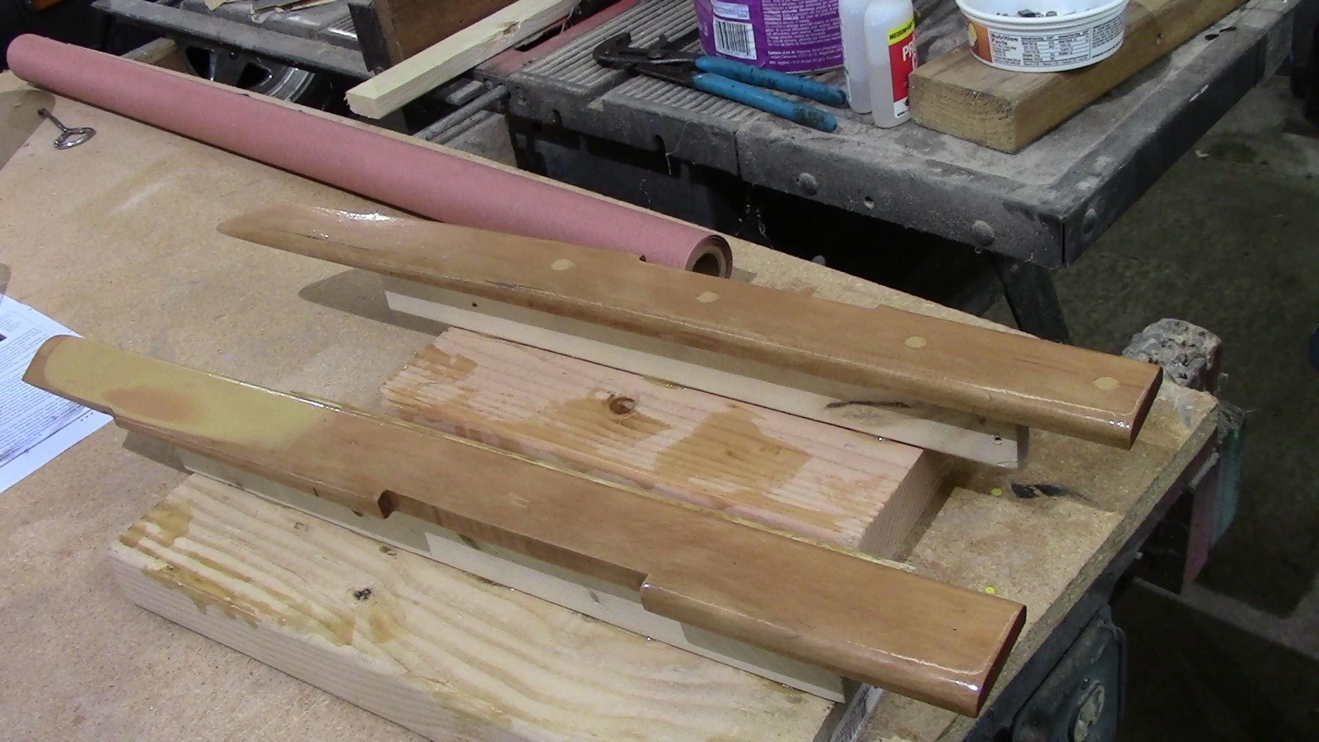

Yes....I figured you might spot the fuselage mold halves. They is for a TD .049 with backplate mount [no side lugs].
The finished width of the fuselage ought to be 1 1/16"....so quite a bit more slim than the plane I flew today.

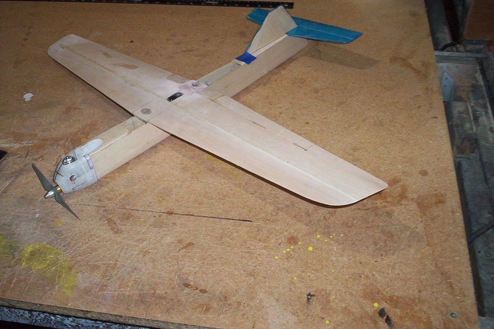

The wing has rounded wing tips, so I'll just do a rough estimate of the area....
The "average span" is about 29 inches and the average chord is about 4 inches..
The plane weighs 10.25 ozs.
I checked the engine today and the cylinder isn't staying pumped up like it did when it was brand new. Instead of 25,000 plus it barely did 22,000 with the 4.2 x 4..This was with the cowl off.

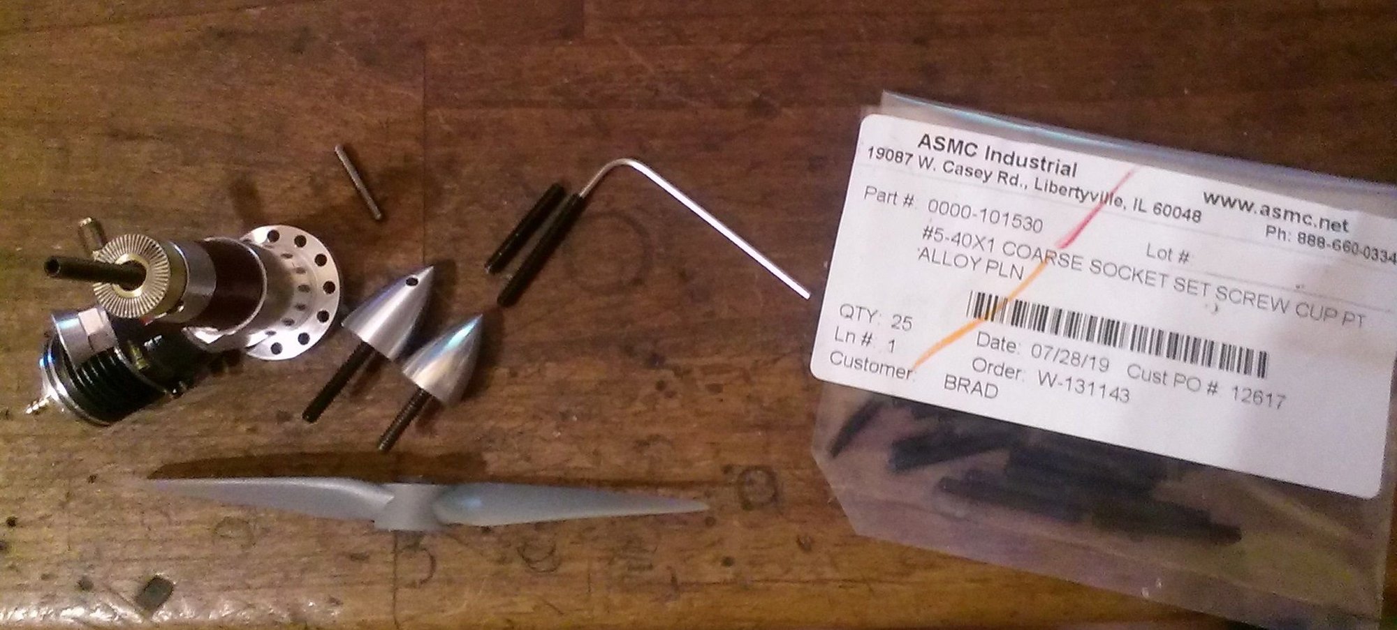

My trick is a short .049 stud bolt and .020 bullet spinner on a .049
The stud bolt has a hex head lock it down to the crank threads.
I have done the same for a TD .020 with a tapped out TD .010 bullet spinner.
Hex point head is available for the .02 big plus when removing.
Also tapped .049 bullet spinners for .09's and recently had Valentine retap
two 09 bullet spinners for my TD .15 because the APC prop hubs are smaller
in dia. than the old school props saved bit over 4g to boot.

Your spinners look great. I should make a few and get a Hornet starter going.
