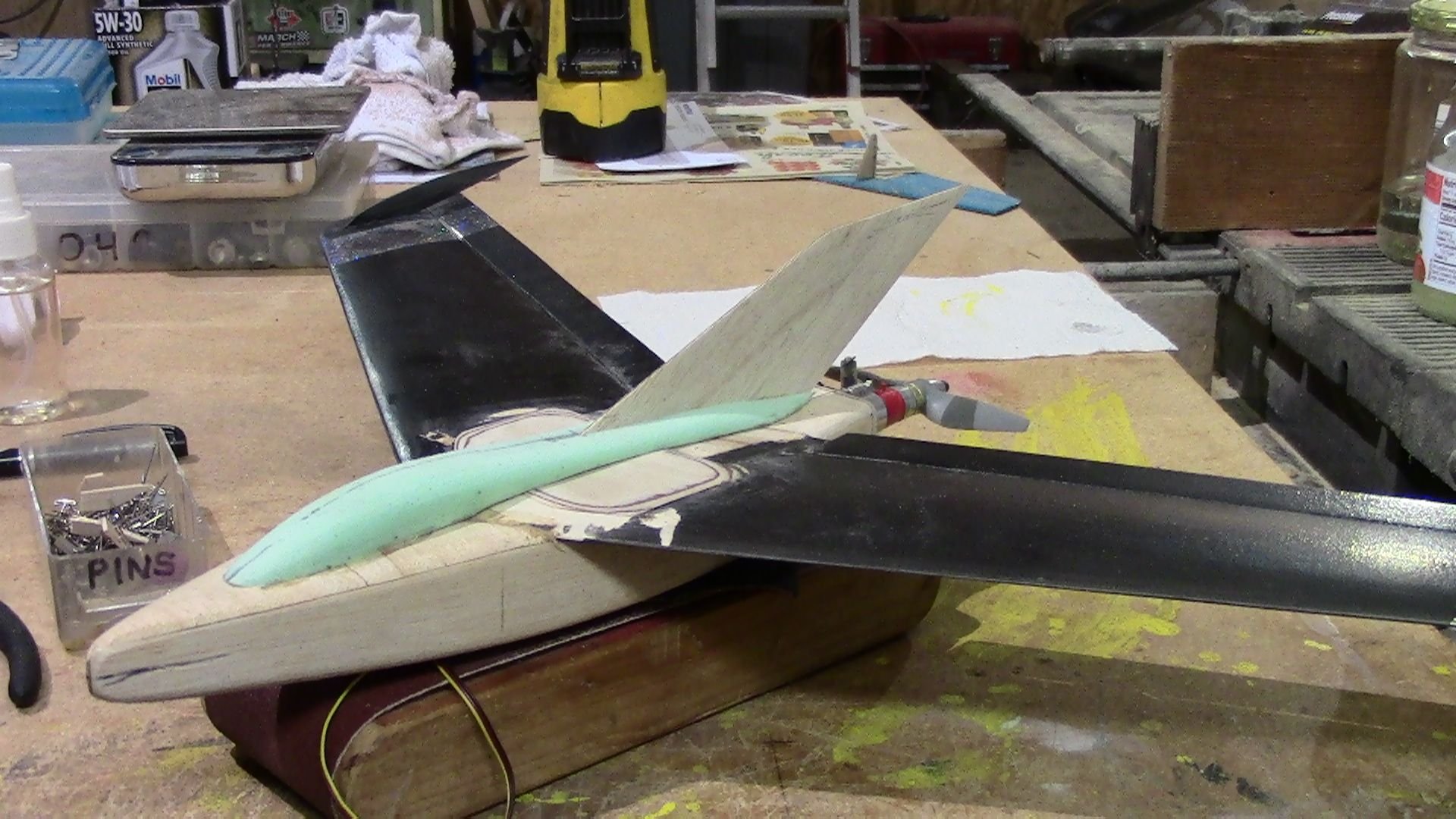

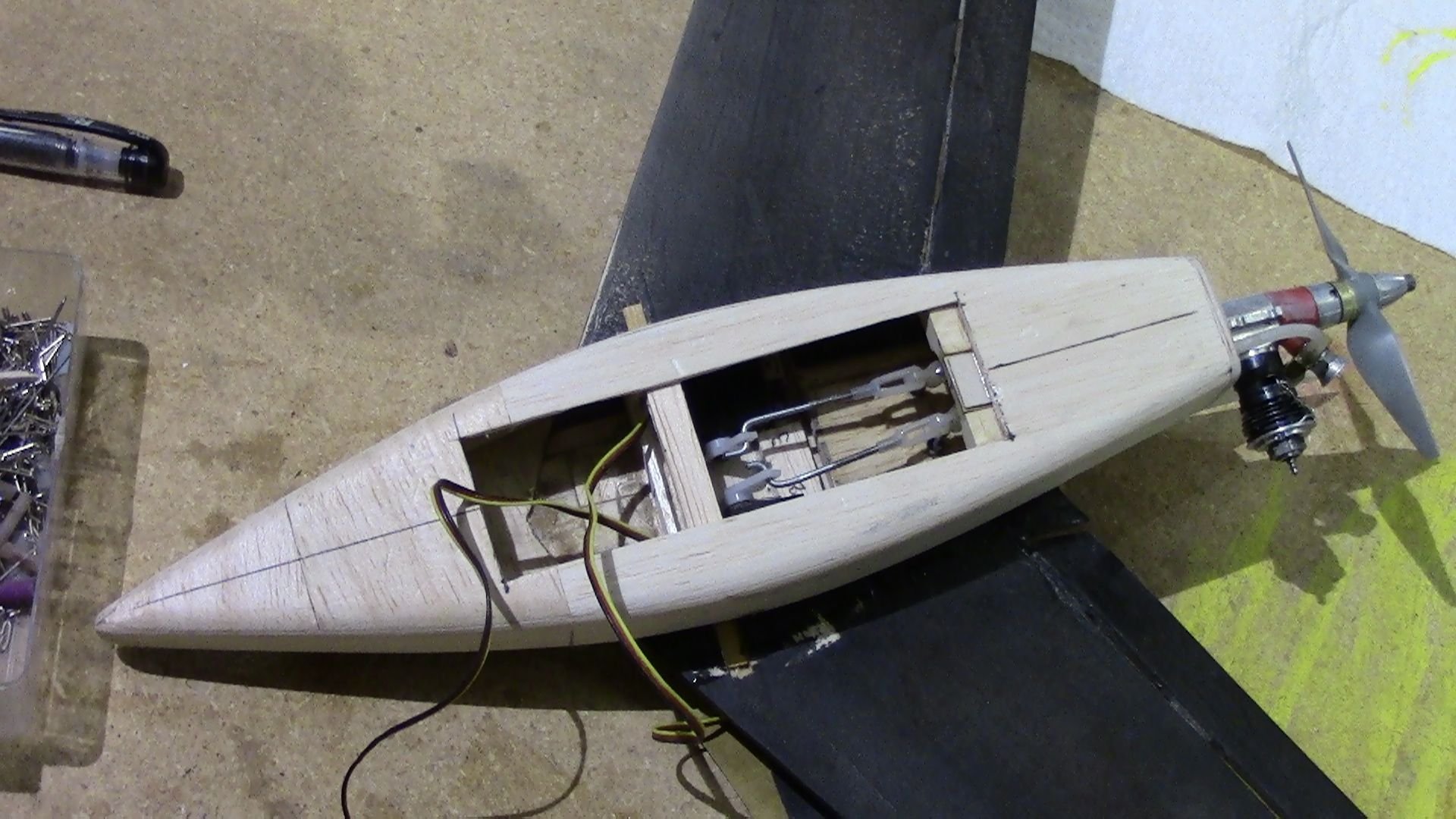

My first toss of the Boomerang did not go well. It went straight in as if it were very nose heavy and if the elevons were reversed. I think it was massively nose heavy, but will check the thrust angle after the repair is done. I redid the CG calc and found that the CG is just 1/2" ahead of the firewall. This meant the battery needed to move to the rear and that a deeper box needed to be built so the battery could sit right next to the elevon linkage. It was a pretty easy fix

I think so..more like definitely do not want any DOWN thrust.
I'll take the time to check the thrust closely this time.
I hate the look of this triple decker fuselage..so hopefully I get an idea about gear placement and control set up with the way the plane is now..then transfer this wing to a better looking fuselage design.

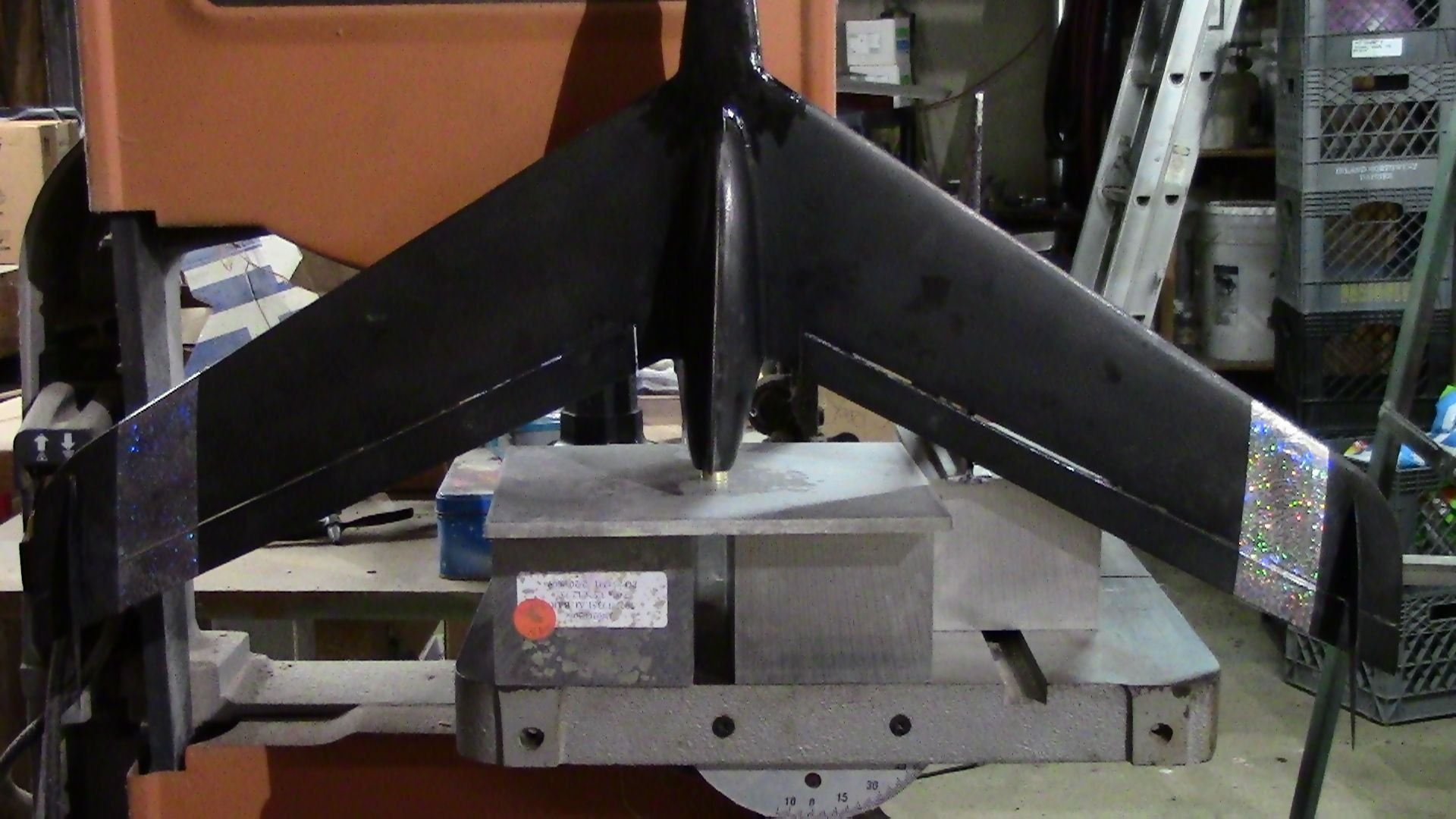

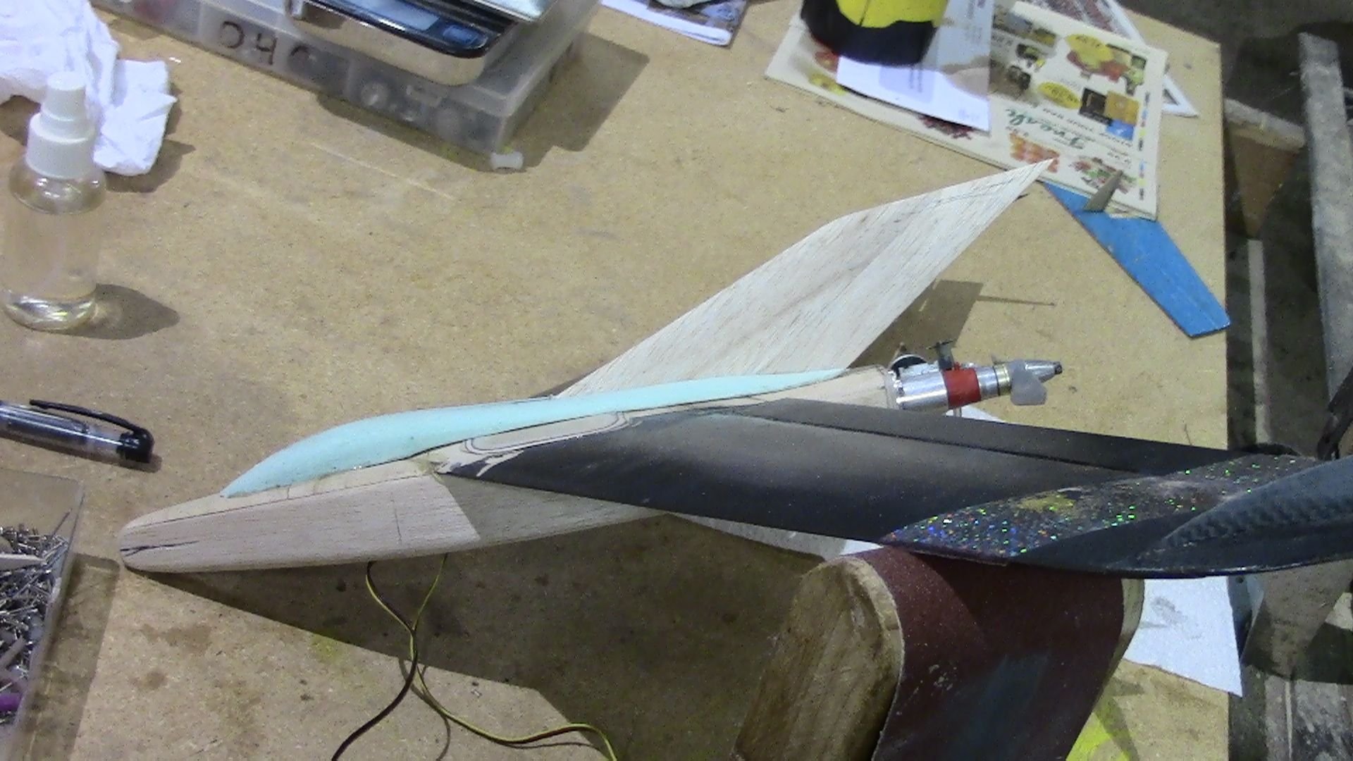

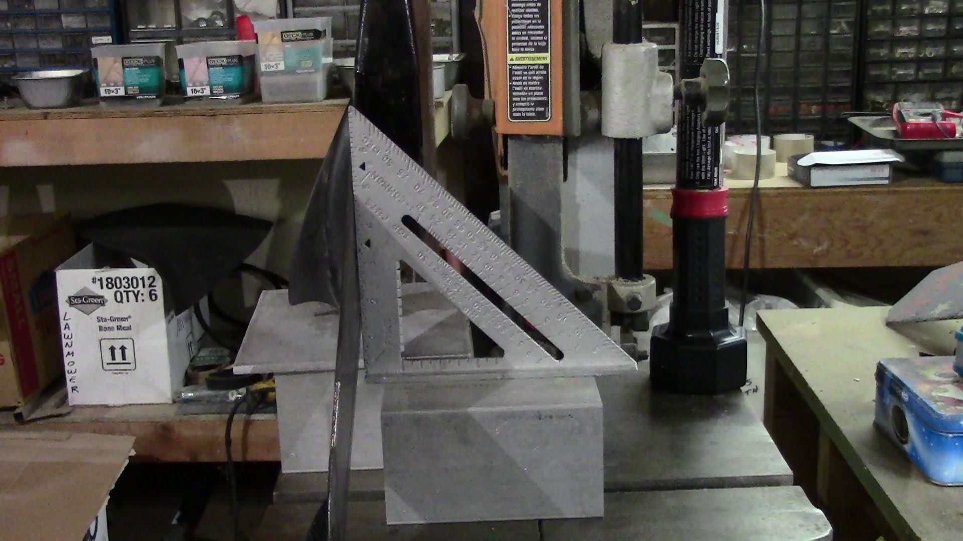

Here is the check of the engine alignment and it looks close enough to me. I moved the CG back and increased the elevon travel. I think this is the 3rd swept wing pusher I've built with .049 power. The last one I did was pretty fast with a hand carved 4 x 4 prop out of maple.

Deltas always need a bit of up reflex on the elevons. Maybe a framer's square on the bottom of the wing to the motor mount would see if it is up or down thrust.

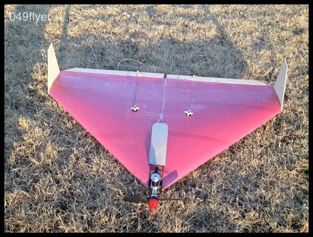

The first flight of a hand launched flying wing is always exciting, you never know what it will do. I usually find a hill and try a “test toss” to see if I am close.
I’ve built several of these with great success:
Thunderbird from old magazine plans, powered with a Cox Surestart.

I cut the foam cores out of blue insulation foam, covered the blue foam with red tissue applied with watered down white glue, then covered that with doculam to fuel proof it. Worked out very well, a couple of us chased each other around the pylons with these deltas. Lots of fun for vey little money!
1/2A is always a blast!

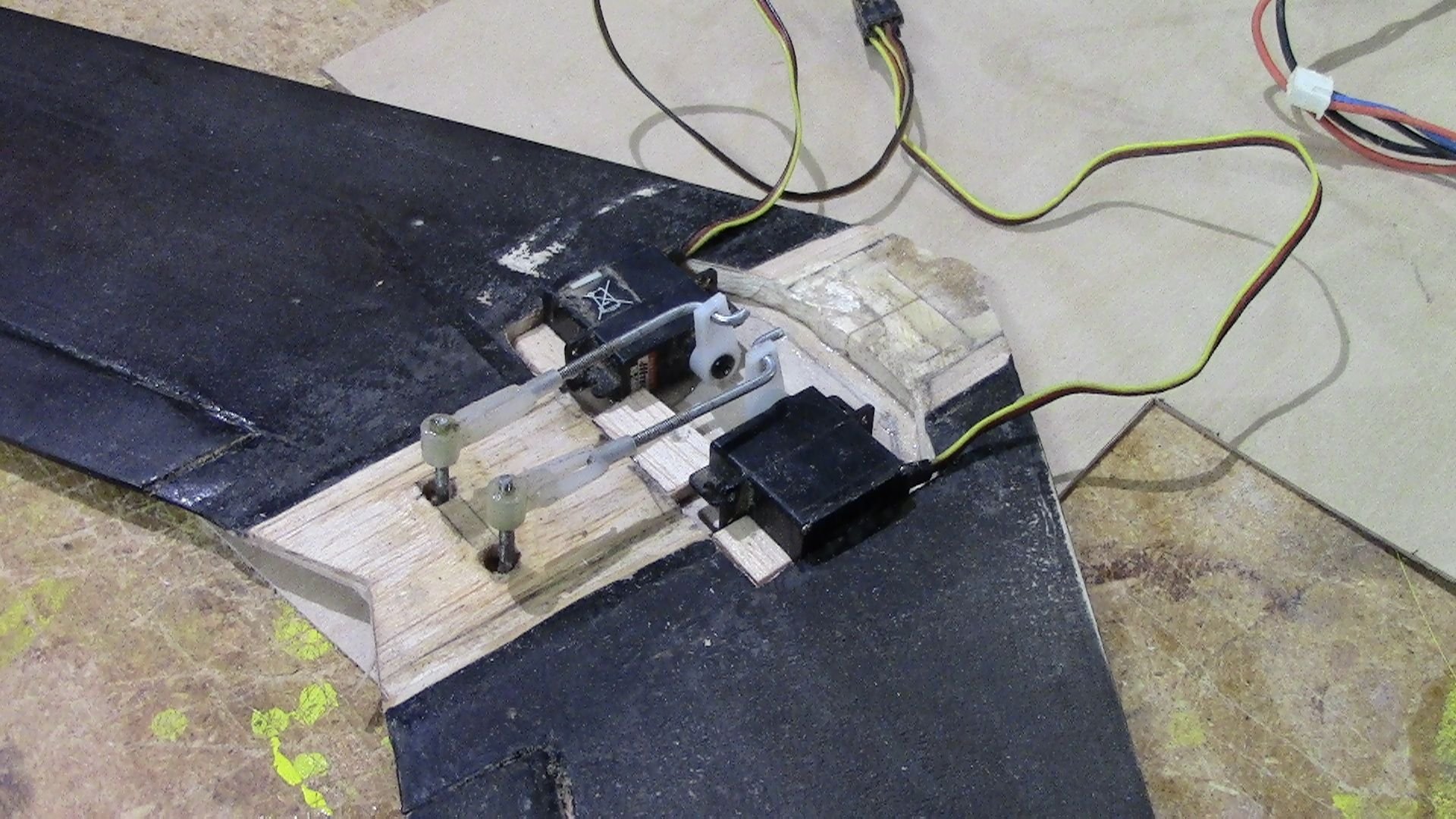

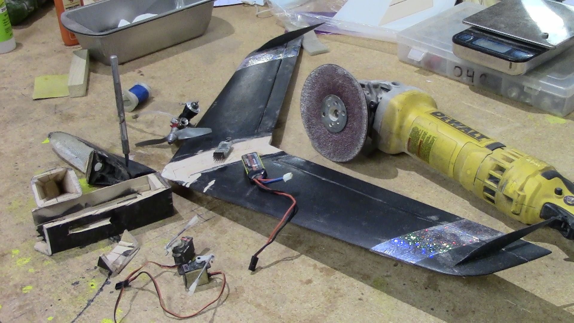

I was close to trying the plane today but noticed it didn't have the same amount of elevon travel in the UP mode. The elevons themselves dont have any binds but to check the weak servo meant knifing into the plane to investigate. It looked like the servo got a gear tooth missing so I decided to wipe the slate clean and redesign the plane. I found a pair of HS 56s laying around and mounted them recessed as much as possible into the wing. The fuselage will need to be somewhat wider to enclose the portion of both servos that sticks out of the wing.

I'm OK with the looks of this one. The first attempt reminded me of those 1800s illustrations of what a steam engine powered flying machine will look like someday.
It ended up wider than I would like...so I think a future attempt will have the elevon servos mounted inline

At this point it weighs a little more than 8 ozs. I want to flatten the black and then paint some highlights on top just so I don't lose track of which side is up.
