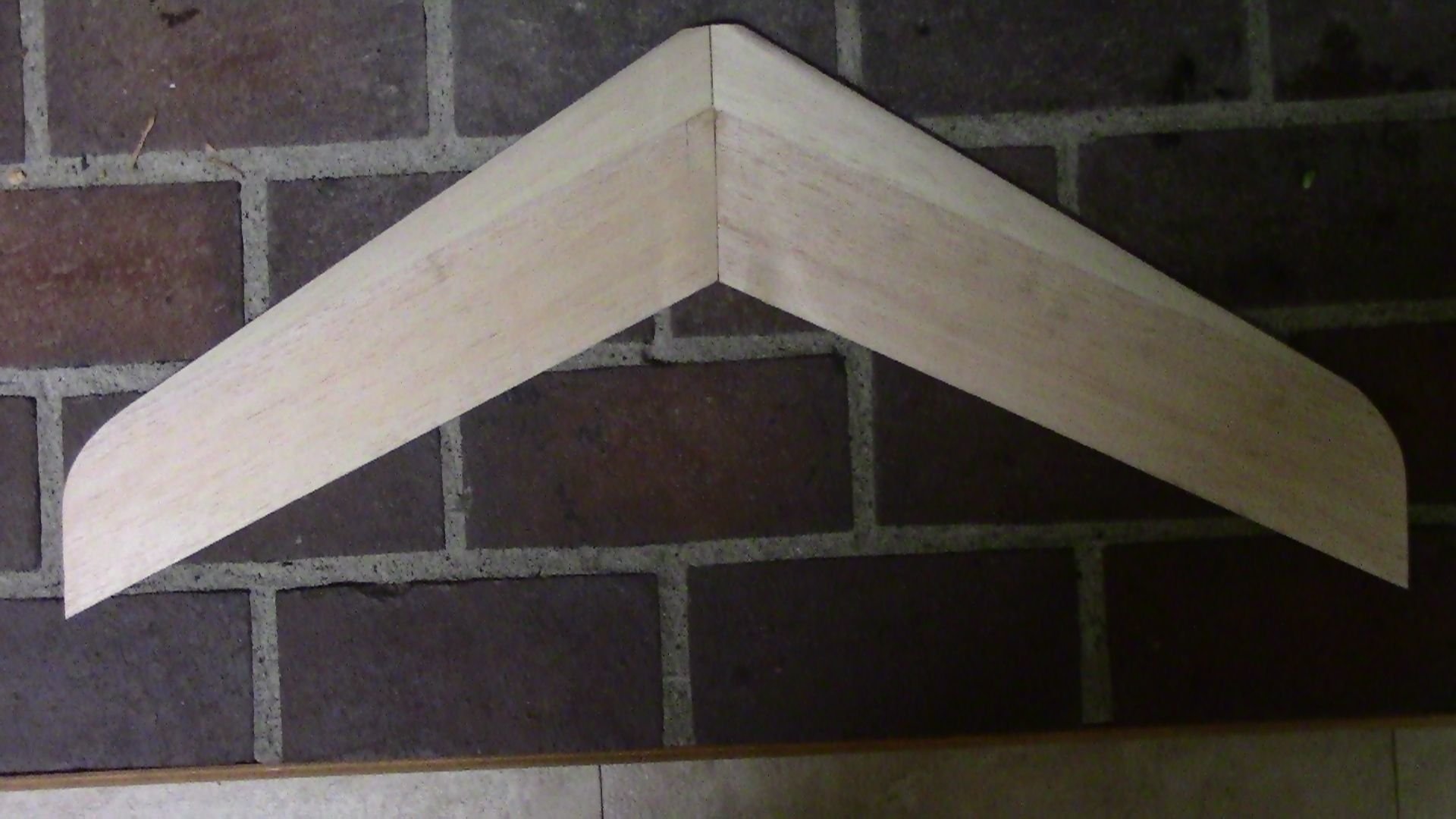

The heart of this project is of course....
a slab of 1/4 inch thick balsa for the wing...
a Cox TD 049 with a Nelson head and fueled with a high pressure latex bladder

What is the prop size, span and squares?

The span...the actual span is 25 inches and there are about 100 sq inches. 5 at the root and 3 at the tips. This balsa is stiff enough that the only spars will be short one in the center section.
The fuselage will be a foam carving that is wrapped with FG cloth and laminated with medium CA glue.

Swept wing should do well to support a pusher engine conf.
100sq." will make launch less stressful.

The swept wing is useful for CG considerations for the most compact design.. The CG @ 20% is a little more than an inch from the TE at the wing root. This way the amount of side area ahead of the CG wont amount to very
much.

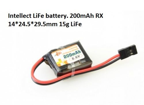

I found some being used with cars here you go..they take PayPaL
It's in the UK shipping sucks you would have to buy 3 to make it worth it.
https://alshobbies.co.uk/Intellect-R...IPLFP652424-2S

That's a great find. Just to know they exist..some other battery Supermarket in the USA must have them.

This was a big deal at a time when the car guys used them but that craze is over most vendors have sold out all stock.
Took looking in the UK to find a following still. 2yrs ago I scarfed up the last of the Reedy 250's
The solar light area has a new cell 2/3rds AAA size 3.2V 200mAh Lithium Iron phosphate LiFePO4
7g button cell /
10.2mm x 24mm
Only way to get them with PayPaL is ebay bulk buy 20 cells or ten 2S / 6.4v packs.

200mah LiFe
Out of Canada so price is inflated need to confirm the miracle of their existence.
https://hobbyhobby.com/product/28548...source-u-conn/
I emailed them to see / can't beat the weight and size.

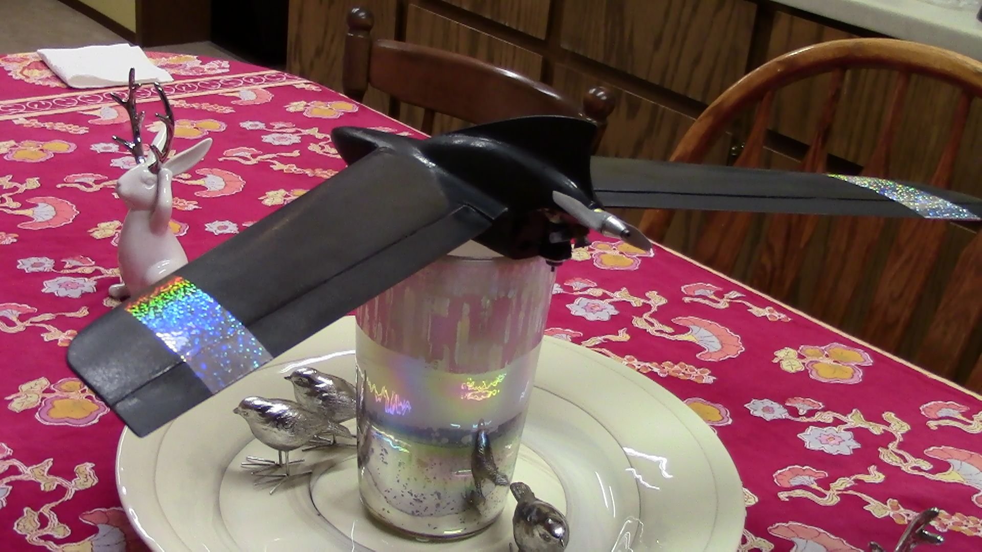

It weighs 7.25 ozs before covering
The bladder just wouldn't fit in the cargo space below..I had to make the bulbous blister above the wing.
Next time I'll make everything fit in a longer fuselage that's all below the wing.

Weee looks cool certainly should have good viz with the top add, lends to being a canopy.
Vertical stab should just be enough, certainly at speed. How is the CG looking?

Thanks..but .I think it looks like a plane that I drew when I was in Kindergarten..!
At any rate it will be fun to see how it flies
And what is wrong with that?
I think it has a strong Buck Rogers look to it. And that means it looks awesome!
Be a while before the first flights I'm thinking?

Unbelievably the finished weight is 7.75 ozs. I used Klasskote epoxy paint satin black but it was too cold to get it to flow out. After the paint cured I sanded it to get rid of the bumps, contact cemented a couple of thin gift wrap strips on top of the wing and called it DONE.
Old 12-25-2020, 10:59 AM

Nice, the silver should help flash a reference.
All colors turn to black from a distance anyways, great weight Chuck well done!
T -10 I image when the field dries up. Happy Holidays!
