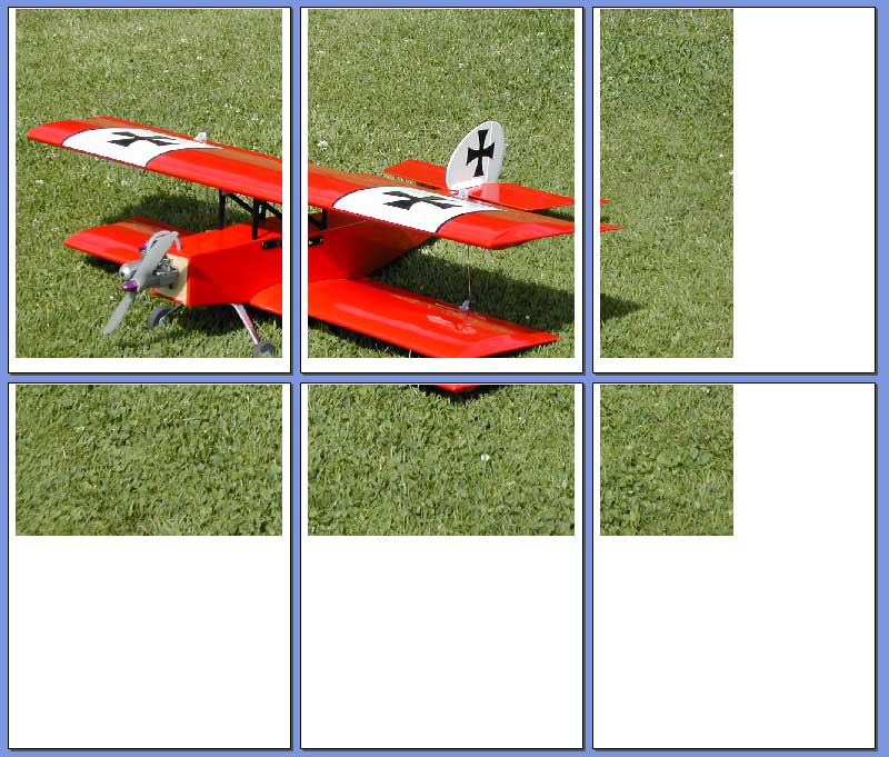

This is that a picture would look like.

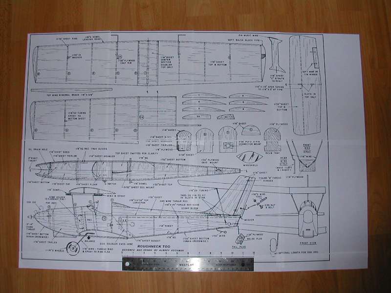

Here's how a set of "Roughneck Too" plans came out after printing and taping them together.
