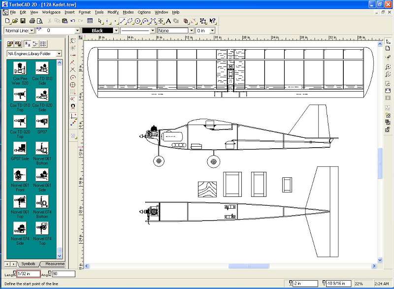

I started drawing up a trainer with a 40" span that should be suitable for .049 to .074 engines.
It should be pretty obvious what it is patterned after. If anyone is interested in building one I'll post the plans when I'm finished.

The little Kadetlet looks good- I also like the shape of the tail on the kadet mk11, but that may be harder to make..
One thing that might be a boon to beginners trying this (or any) 'electronic' plan- where you download and print yourself- is a 'printwood sheet' layout. An image of a rectangle representing a 3x18 or whatever common-sized balsa sheet with the outlines of all the ribs, etc that are to be cut from that sheet might be helpful for a novice- and would ensure the grain is going the designer-intended way for all the parts.
I know a lot of people now make a hard rib template for constant chord wings, then do all the ribs from that- but I still do it the hard way, by making 'printwood' using a xerox copy with lacquer thinner rubbed on the back to transfer onto the balsa.

Looks like a Whizard to me, nice job,,I agree it needs a wing rib template...what are those funny looking round things hanging off the bottom?...Rog

Yes it's a mini Kadet.
I drew an optional fin and the rib layout. I'm just going off of pictures, so I may not have the fin exact. I still have to draw the spar and LE cutouts on the ribs etc. I was going to go with a Clark Y airfoil, but I decided to use an airfoil that could be built flat on the workbench.

looks nice but would be an easier build for beginners if the firewall and formers were all the same width from trailing edge forward. make them the same as the trailing edge former and you also reduce some of the "chunkiness" up front.

Then an .074 wouldn't fit. I used a Kadet Senior as an outline for the fuse.
Here's what a simplified fuselage would look like.

I agree that simple is better. Getting serious (what? Not a Piper? ) I would suggest loosing the landing gear for beginners. They typically fly off a grass field and we all know that if the grass is not putting green smooth or the wheels are not HUGE that a 1/2A model will typically nose over. I'd also suggest that for a trainer you would be better to loose the ailerons and go rudder only with throttle as an option depending on the engine. Here again it's simpler to build that way.
I do like the 40 inch span as it provides a bit more area and drag. Speaking of drag for a trainer a fat semi symetrical airfoil similar to the one on the Littlest Stik may be a good idea as it's thick enough to offer some speed controlling drag while not being so highly cambered that it would encourage a lot of speed related ballooning out of turns and dives. If you use that airfoil the lower rear surface is flat for easy building and if you use a piece of 1/4 sq set on a diagonal it would fit right into the mouths of the ribs without requiring the table surface for support.

Oh while I have my arm chair quarterback helmut on, I have a wish for the wing-
like Bmat said, having the leading edge in as a square stick turned on diagonal (herr style) is great- I think the way my kadet junior wing was made was awesome- the top was sheeted from leading edge to the middle of the main spar, then cap strips went from the middle of the spar on back to the trailing edge. It was hugely strong and what i liked is that there weren't the rib hills and valleys along the top front of the wing, since it was sheeted. Isn't that called 'D' wing construction or something?

Wheels and ailerons could be options. I've flown smaller planes off of grass with no problems. Personally I think that a person is better off learning on 4 channels, including taxiing. Rudder/elevator only is easier to build, but not the easiest to learn with. Beginners often get heavy on the elevator and find themselves at high AOA with little airspeed where ailerons are much more forgiving than the rudder. I think that one of the best characteristics about how the Kadet series of planes flies, is that they don't need a lot of elevator in turns. I've used this airfoil before, albeit on a low wing, and it has performed very well. I'd rather people leave off a few things if they simplify rather then not know how to add ailerons or gear if they wanted it. I do prefer the angled LE though as it is stronger and needs less sanding.
McClintock, yes it is D tube construction and is very strong, although it does take a little more difficult to build. I'm trying to keep the wing construction simple, that is why there is little sheeting and no cap strips. There's nothing to stop someone from building the wing that way though. For myself I would use sheeted foam (no it isn't heavier when done correctly), but I know most people don't have a foam cutter or prefer built up wings.

Here's how I could go with the ribs using some of BMatthews' and McClintock's suggestions.
1/4" leading edge on diagonal with fully sheeted ribs where the rubber bands are and D tubed ribs for the rest. I've drawn the ribs alone as well as with the spars, LE, TE and sheeting.

I would suggest adding some doublers in the front, and adding some extra beef to the wing. A trainer is best built using crash-proof structure, otherwise it quickly becomes a fly n fix bird. This adds some weight, but adds to it's survival during the learning process.
I usally add a 3/32 dowl across the front of the L.E., makes it MUCH able to survive even small tree impacts, and is easy to cover with as the round accepts the covering without added sanding. Very little weight is added, but it will add many more flights.
Don't mean to rebuild this for you as it looks great, just considering who the trainer would be used by and all.

I like your decision to use built-up stick formers. That is a lot easier for a beginner than to guess where the holes go when installing the radio.
Noticed that you don't show sheeting between the spars. Did you decide to use a "C" tube instead of a "D"tube? Both work well.

Thanks for all the suggestions so far. It's no easy task to design light, strong and still have it be what every person considers to be good trainer. I like the feedback though as it means that it is a worthwhile project.
Remby,
I'm not a big fan of crash proofing, but a dowel leading edge could be another option. Again, this is where I would prefer a foam core wing because it has a very good strength to weight ratio and is easily repairable. I will probably add doublers under the wing or possibly between the firewall and first former, although I rarely use doublers when building for myself.
George,
I really like stick formers. I think that they give the most strength for the least amount of weight. I don't like using ply unless I have to. You're right, I haven't drawn any shear webs yet. They should go between the spars, but I will probably draw them on the back of the spars as this makes building easier.
