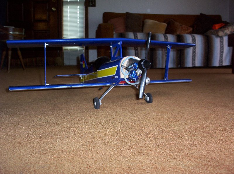

Well here it is. I did a conversion on a Mini Funtana. I used an os15 engine. I still need to weigh it, but by just holding it in one hand and an electric version in the other they feel about the same weight.

Wow, what a nice looking plane, I especially like how you have the engine mounted. Looks fantastic!

That's a good looking job on the conversion.
The only advice I have is on the RX in there. It looks like a GWS Pico 4 channel? I have a few of these and they do get some glitches, which can be severe. Only a suggestion, but you might want to consider getting a slightly more robust receiver. I assume you'll eventually want to get low and slow with this plane and I personally wouldn't trust the GWS for that, one good glitch and you'll be done for.
For my little 1/2a planes its no big deal, but for something this pretty I would want to have solid reliable control.

Thanks for the info on the GWS receiver. The guy at the LHS said I would have no problems with it. Of course he said that, he wanted me to buy it. Is their a small receiver that you would suggest? I have a regular size one, but was looking for something to shave a couple of oz's off of the total weight. It is a six channel receiver as each wing has its own servo.

Nice Conversion! I was thinking of doing one of these for a Saito .30. You might look at the FMA M5 (or something like that), a Berg receiver, or a JR 700 comes in at .6oz with the case. Also, if you have the $$ get the small voltage regulator from FMA for $22 and you can power your radio with lipolys, a 2s 340 would weigh next to nothing.

Nice job. When is your flight report coming? What size tank did you mount? It looks like a GP 4oz. Is there anything you wish you would have done differently? I use a Hitec electron 6 receiver in all of my planes. .6 ounces and .4 without the case. THey are also dual conversion, so you get the range.

OK, so that is the Naro 6 channel then rather than the Pico 4 channel. The Naro is supposed to be better than the Pico 4 channel, but I don't have any experience with the Naro. I would second the Electron 6 or maybe the Berg 6 channel. Both are light, but a little more pricey at $50 to $60.
You might not have any trouble with the Naro, but I would search around a bit on the boards and read what others have to say.

Great job. You'll get around 30 mins flight time with a 4ounce tank. I did the same thing to my Shock3/D and Ultimate Bipe .
Ended up putting an OS-10 on the Shock but when the .15 was on you could do knife-edge loops all day. Tons of power.
Half throttle flying at it's best. And when you go FWO it's a blur going past. Just be careful not to blow the control surfaces off at high speeds.
I used two coats of BalsaRite fuel proofing on both planes and all is holding up well after 6 to 8 flights on each. I also added a front wing bolt to the Ultimate so the wings would stay on better. The OS-15LA really shines on a model under 2-pounds.
