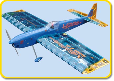

There is also Diablotin Super FG.
This model will take up to .90-1.2 4-stroke engine.
It has gel-coated fiberglass fuselage.
It's my favorit.
Wing area: 925 sq.in.
Empty weight: 53 oz.
It's my favorit.
This engine recommendation is not correct. 120 is too much even for Std Diablotin -- 91 Fx being about the max.
