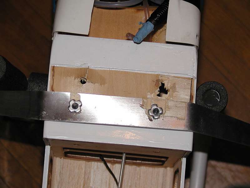

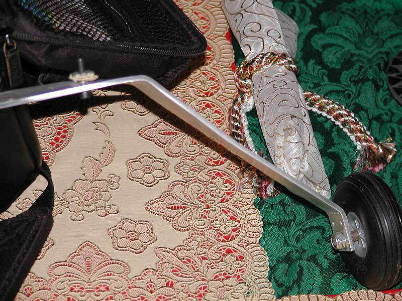

As far as not flying right most likely was my inexperience in flying new models. This would have been the first airplane that I maiden-ed.
Usually a flying buddy of mine does my maiden flights and set trims but he could not make it out to fly today due to other commitments.
It just seemed a little squirrelly to me and I wanted to get it back on the ground before something happened.
I was coming around on final to the grass strip and misjudged where the airplane was in relationship to the ground and strip.
Put it down on the far end of the strip which is very rough. The field I was flying at was a landfill and has allot of settling going on
therefore pot holes and dips occur all the time. The smoothest part of the runway is in front of the pilots stands which was were I wanted to go
but did not end up there.
Most likely the problem was the loose nut behind the controller. When I get the damage fixed than I will have my friend re-fly the airplane and
see what he thinks.

not bad to fix.
2 pieces are better than 50
Old 01-22-2005 | 11:34 AM
  #131
Maudib's Avatar
My Feedback: (51)
Posts: 5,833
From: Ashland, KY
Default RE: BME CAP Maniac
Actually you should be glad it busted out as it did... could have been a LOT worse if they hadn't busted out.
A 2 bolt gear like that gets a lot of leverage on the type of landing you mentioned... catching grass or the edge of the field puts so much stress on those two bolt holes..
I think I'd sand it down, glue a 1/8" ply plate to the inside and fill the holes with epoxy & milled fiberglass... then when set redrill the holes right where they were.
I would welcome this type of damage anytime over the alternative... the gear plate could have ripped out taking formers with it... the plane could have nosed over hard and busted up the cowl and prop, maybe even busted loose the firewall, flipped over and damaged the rudder...
All in all.. the best damage to have experienced is what happened to you...

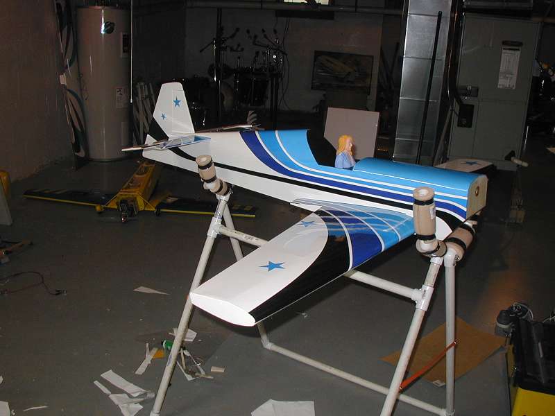

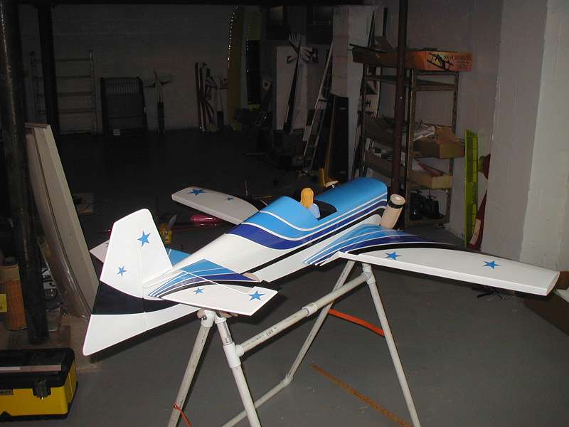

Well progress is coming along great on mine,NICE and STRAIGHT!!,,, I should be ready after it thaws out here in a couple of weeks..[8D]

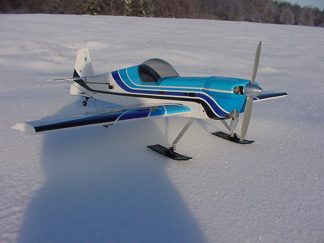

I took the cap up on another flight two weeks ago. So far I really like the way it handles. On past post someone contacted BME and they said, “The tendency for snapping has been reduced to a minimum. Even if you pull elevator quickly during level flight, it will not snap unless you have some crosswind effect.”
Well I just had to try it, and sure enough some where above mid throttle I pulled full up elevator and it didn’t snap off to the side like so many of my other planes do.
Point rolls were clean and crisp. Landing were smooth (still have my skies on)
The Magnum 120 is still running rich on the low end and when I throttle down it wants to die. I haven’t brought it down to hover yet until its adjusted right. Now that I have ½ doz tanks of fuel through it I will start to lean in the low end.
Last weekend we had another snowstorm with strong winds so flying was out.
Temperatures down in the single digits.
Hoping to take it up again this weekend.
I will keep you posted

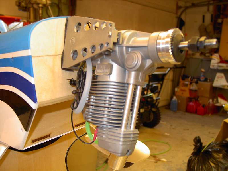

Okay, now that I am really leaning toward putting the Saito 120 in this plane, the 1.20 is longer that the 5.125 that the cowl measures out to the front. I can not set the 1.20 back any further because of the carb - doesn't matter if it's inverted or sideways. Hummm the Saito 72 I have on hand could work, but would probably be somewhat lacking in performance.
So the Saito 100 is now a purchase contender....

No, I could not get the 120 back far enough to the firewall with the supplied mount. I modified a mount that I had left over from another plane which allowed me to but the engine to the fire wall and set the cowl 5-1/8”out.
Here are a few pics of the install.

The great planes mount i am using would not allow me to mount inverted. i see yours was tight at the top of the firewall too.. mine was close enough to have to cut a side off of the blind nuts so i opted for the stock location side mount.
