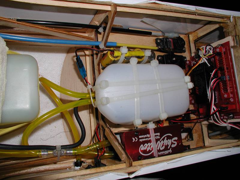

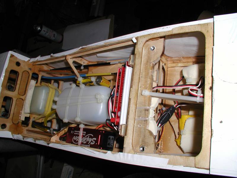

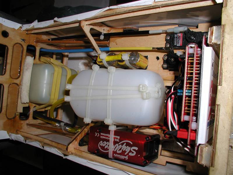

Hay Lou I have a question for you, when we were talking about cg you said to leave it as the manual says. for now until I get better , I installed the smoke pump today and moved things around , and now when I balance the plane it drops the tail about 2 inches. With fuel it should balance out, should I leave it or try to bring some weight forward?
Old 11-01-2007 | 01:32 PM
  #1129
bubbagates's Avatar
My Feedback: (32)
Joined: May 2004
Posts: 8,635
From: Elizabethtown, PA
Default RE: GP Cap 232
Always balance without any fuel in it. Remember as the fuel burns off, the nose will get a bit heavier, unless you move th tank so the center of it is right over the CG

Couldn't agree more. The hardest part about "tail heavy" is landing. If you run your fuel or smoke oil out flying and the tanks are forward of the CG you're gonna be tail heavy for your landing. That's not going to be fun.[:@][:@][:@][:@]

The smoke oil tank is in the middle of the cg over the wing. So I am going to try to move the batteries up forward a little. Today I did not get a chance to try it to see how it works we are having a wind storm the thruway is closed of 250kph wind here at my house it is steady at 45kph gusting to about 70kph.

here are some pics of what i did.

Yeah, with your fuel tank forward you definately want to balance the plane dry.

Moved the batt forward, and cg is ok now. Started the plane and lit up the smoke. It took a while to start but it is smoking. Now I need to adjust it some more to much oil no the ground , got it to 2.5 min for 10oz still to much oil . But it sure dose look good the whole street fogged up. 1/3 diesel 1/3 baby oil 1/3 auto trany oil . I bought 2 cases of trany oil in cocsco for $10 a case of 12 , here in Croatia it is $32 for a liter , unbelievable. not to many people here drive automatics. it is all stick vid coming soon.
