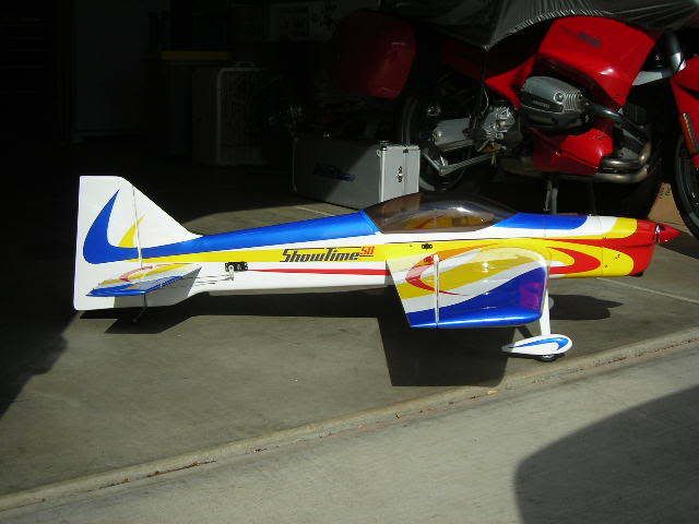

Just finished mine today.
YS .91, went with two tanks like rmazuera, an 8 oz over the CG, and 6 oz up front. It needed 1.5oz at the tail to balance in the stock location. Dry weight came in at 7.5 lbs.
I'm planning on running a 15x4W APC, if it shows up on time... I'm planning to maiden it Wednesday AM. [8D]

where are your cowl cutouts? on the bottom? curious. looks awesome! really needs the prop tho lol
