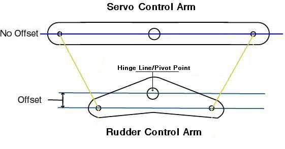

Default offset
I've had this question a while too. I think I read somewhere that some servo arms are offset to compensate for the arm/control horn dimentions being different. By offset I mean (I think) that if you drew a line from one hole on the servo arm to the other hole, the line wouldn't pass through the servo output shaft. (see the picture below) Somehow this keeps both lines tight even though the servo arm is bigger or smaller than the control horn. I'm not really sure about all this though, so someone who really knows... please enlighten us!

Default Re: offset
Actually the servo arms are offset to compensate for the fact that you get varying line tension if the servo arm is straight and it's connected to the control surface that is NOT straight (See the attached image, which WOULD give undesirable varying cable tension).
If you could set up the control surface so that it too is straight, then unequal length arms between the servo and the control surface would not matter, because the ratio or distance one side moves is exactly matched by the ratio/distance the other side moves, and cable tension stays constant.
To minimize this varying line tension, you can (1) use an offset servo arm to match the amount of offset at the control surface between the hinge/pivot line and a line drawn between both clevis holes or (2) offset the control surface arms to so the clevis holes are at or near the hinge/pivot point, thereby matching the straight servo arm.
Actually, it isn't absolutely critical that both lines stay absolutely tight. What IS critical is to avoid the cables becoming tighter when the surface is moved from neutral to extreme travel. It's fine (actually a bit desirable) for the cable to loosen slightly at extreme travel. Air pressure from flight loads will keep the loaded (pulling) side tight, and since one side of the surface is under a load, flutter isn't an issue.

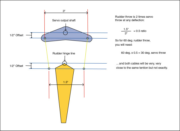

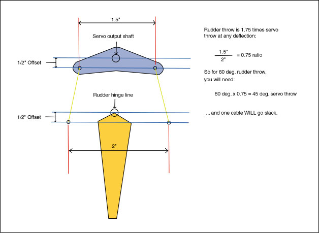

Default Is this what 'yall mean?
Thanks for the great input, everyone!
Just to double-check, if I understand correctly, the servo-arm/control-horn size ratio gives you more (or less, depending) rudder throw than servo throw AND causes the non-tentioned cable to go have slack, and matching the offsets on each end (match servo-output-shaft/servo-clevis offset to hinge-line/rudder-clevis offset) just causes the servo-arm/control-horn size ratio to be proportional (i.e. rudder throw is always X times servo throw, for any given deflection)?? I have trouble explaining what I mean, please see the picture. If you wanted both cables to be at the same tention throughout servo/surface throw, the servo-arm/control-horn would have to be the same size and the offsets would have to be the same.
I either finally understand or am really confused - I hope it's not the latter!

Old 04-02-2002 | 08:51 PM
Posts: 611
From: Indianapolis, IN
Default Re: Is this what 'yall mean?
That is exactly right!
The servo-arm/control-horn size ratio DOES determine throw, but it's the mismatched pivot offset that causes slack in the cables. Matching the offsets controls slack in the cables.
Again, offsets mainly control slack in the cables, (don't want to open up another can of worms about the travel actually not being linear).
Another thing, in your picture, since the offsets are the same, cable tension variations are minimized (rather than your feeling that one WILL go slack). Your ratios are also wrong, in that 45 degrees of servo throw will yield LESS than (not more than) 45 degrees of rudder throw. This is because in your example, the servo arm is shorter than the rudder arm. To get more surface throw than servo throw, the servo arm has to be LONGER than the surface arm. For example, a 3" servo arm (1.5" from pivot to clevis point) attached to the rudder's 1.5" control horns (.75" from pivot to clevis) will yield twice the throw at the rudder than the servo. At the same time it cuts the mechanical advantage in half, so that if you're using a 100 oz/in servo, the rudder only sees 50 oz/in. That's the reason that proper setup dictate you first maximize the servo travel with your transmitter, then change your ratios (servo arm length and control surface arm length) to give you the travel you need. this way, you minimize your loss of mechanical advantage to the surface.

Default Pull Pull Increase Throw?
Tim:
Thanks for taking the time to explain this. I think I understand now, please check the new pic below and let me know if I'm on the right track. Another question:
...will yield twice the throw at the rudder than the servo. At the same time it cuts the mechanical advantage in half...
Does this mean servo throw to surface throw is the inverse of servo torque to transmitted torque? I.E. if you have a 50 oz/in servo and want to transmit (through mechanical advantage) 100 oz/in to the control surface, the control surface can only deflect 30 degrees if the servo is deflecting 60 degrees? (cet. par.)
Once again, thanks for taking the time to help.

Old 04-02-2002 | 11:03 PM
Posts: 611
Yep, THAT'S the ticket!!!
Yep, that's what it means. Guys get into trouble not having enough strength to move control surfaces after setting up for large surface travel, because they don't take into account that the loss of mechanical advantage. The back half of a knife-edge loop is NOT the time to find your rudder is blowing back from the commanded position!
