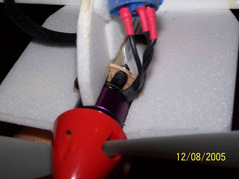

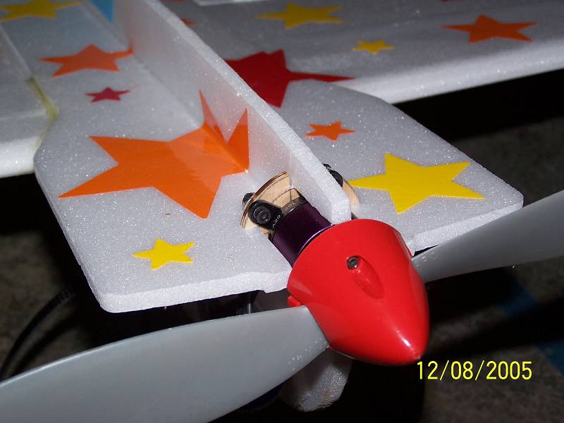

Old 08-12-2005 | 05:09 AM
Joined: Jun 2004
Posts: 40
From: Mechanicsville, MD
Default RE: Need help again... Pro 540 question
Phil, I think you are talking about the older AXI mount that is sorta shaped like a cross with radius corners in the center. I have built five of the www.3dfoamy.com models now and the first two I built had the mount that you are describing. I can say from experience that the forward mount does not hold up. After several flights you will notice the foam on the nose starting to crinkle and then shortly after that the mount or the foam will crack. The two models I had with the forward mount I replaced with a back mount. I run all Hacker A20-20L outrunner motors on all of my models from this company. Hopefully I can post some pics so you can see what I am talking about. By the way these models are the best flying foam 3D models on the market. I also had some trouble building my first one but it was well worth the effort. If you have any questions let me know. Gene.

Old 08-12-2005 | 12:46 PM
PHILB571's Avatar
Posts: 23
From: WPB, FL
Gene thank u for the pics.....lol now i can see how this goes. yes i do have to "older style mount" looks like i have to get some wood and make a new mount. or just order a new mount from 3dfoamy. thanks for the help so far guys..

Old 08-12-2005 | 03:11 PM
Ken-h's Avatar
Joined: Oct 2004
Posts: 675
Received 9 Likes on 4 Posts
From: Whitefish, MT
Phil
Here is what I did to mount it using the Pro mount system. I've attached a diagram from the front that the motor mounts to. You will have to make this out of light-ply yourself. You can see how it fits on the existing motor mount. You need to cut off about a 1 1/4 from the mount that's on your foamy to set the engine in. On the back side I epoxyed two pieces of small hard wood triangle stock.
Funny thing, just finished mine and then seen your post. I thought you had that thing done by now. I burnt up my geared 370 and went to the 400 outrunner and I am really happy with it.
Good luck,
Ken

Old 08-18-2005 | 12:16 PM
PHILB571's Avatar
Posts: 23
From: WPB, FL
hey ken,
yes i thought i would be done with it as well[>:] but as u can see i had some mount trouble. i guess i have an older ver. for the axi set up. question tho, ur thrust line does not seem to be at the cross( intersection ) how does it fly? and should i keep it as close to the cross as possible?
i did what u said about the wings, and to my amazment, straight as an arrow. and very strong as well, i ca'ed the whole thing came out very well. looks like ill be in the garage constructing the mount this weekend. then all i have to do is paint, ill post pics soon.
thanks again,
phil
Old 08-25-2005 | 09:38 AM
Ken-h's Avatar
Joined: Oct 2004
Posts: 675
From: Whitefish, MT
Hi Phil,
Sorry for the late response but I've been out of town on business. I would try to get it as close to the center as possible. Mine fly's great but it's a little lower than it should be and it wants to dive a tad at full throttle. With my old motor on the centerline it was perfect.
