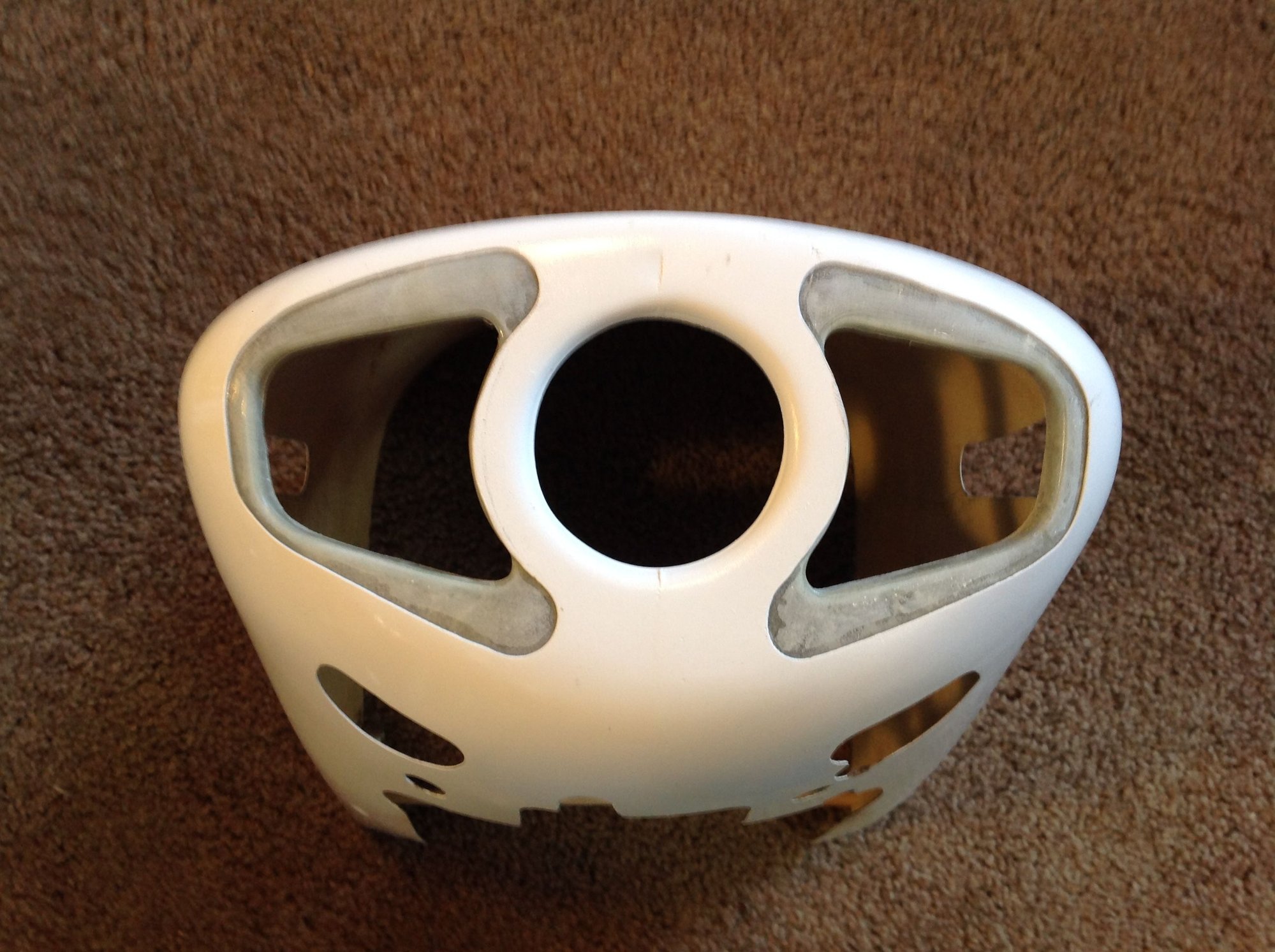

As has said already, there are many variables. One that hasn't been brought up yet is the shape of the exit. If at all possible try to create a low pressure area at the exit. For example, on some of the big twin engines some guys used to add a lip at the front of the exit hole. A current project of mine has the bottom edge of the cowl dropping down 1.5" lower then the fuselage. It's much more efficient to pull the air through the cowl then it is trying to push it. As mentioned, you need to get flow through the fins and not just around them. A good example of this is some of the F-1 racing airplanes.
F-1 race plane. Fairly small intake due to efficient baffling.
A current project of mine, the original owner went a bit overboard with the intakes. I've also closed up the bottom.
Gas engines produce more heat then equal size glow engines. My YS 140 doesn't require anything more then having the cylinder head peeking out the bottom of the cowl.

I see your point however with a little thought put into it you can reduce the size of the exit by designing in a low pressure area as opposed to just cutting a huge hole in the bottom of your cowl.
Low pressure area at the exit of the cowl created by extending the cowl below the fuselage bottom.
This shows the exit size. This exit along with the holes for the muffler stacks and carb are very close to the intake area.
That exit hole would be more effective with a small lip extending downward As seen in the picture below.

Quite possibly but what I have will work just fine. I bought the airplane second hand and what I have done is an improvement to what it was originally. I flew it for two years with the old setup and had no cooling issues.

Astro is correct here. Mechanical things like these lips function to redirect airflow in order to expand the low pressure area downstream ... which enhances the airflow through the cowl.
These and other air exits are sometimes placed on the bottom of the aircraft for the simple reason that air flowing through those fins often pick up dirt and minor bits of oil and other fluids, and most owners would rather have that dirt on the bottom of the plane than on the sides. However, that is not universally true either.
Below is an example of the other low pressure areas on that same cowl, which sure looks like it's a super cub.
