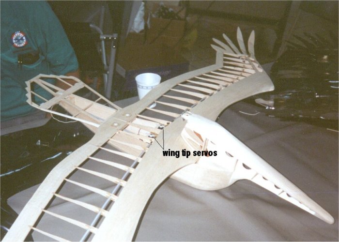

Regarding the fragility of the tip feathers......we've had some trouble with them shedding if the lift plane is flown too fast. The plans call for a carbon fiber torque rod, but Chuck used either a dowel or piano wire, and that lets them flutter......

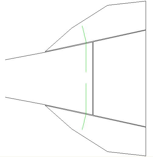

I was thinking of creating a tail with elevator and ailevator combination. I don't want true ailevators as the radio I will be using does not have mixing capability. I'm not sure how effective it's going to be. I need to put on my thinking cap and crunch a few numbers. I need to find some formulas for calculating force from moment, area and deflection. This is going to mean even more aerodynamic reasearch on my part.
I plan on keeping things similar to the "real" version, so I'm not going to be adding a fin. It would just look ugly if I did that. Besides, how does the real thing create yaw stability!?
I've included a picture of the tail with control surfaces.
-Q.

I see that most models try to exactly match the wing tips of the bird. I don't intend doing this as they are so fragile.
-Q.

The way I understand it, the complicatd, fragile tip feathers are what gives the one we're flying its yaw stability. They're set at different angles, and the whole assembly took some fiddling to get set right. I think you'll need a vertical tail of some sort if you don't use them.
Are the wingtip feathers creating drag (a kind of brake on each wingtip), or are they acting like tip-plates?
I must confess that I thought that the tip feathers were only used for roll control.

I've noticed the tilting of the tail, too. On the model we're flying, however, all the roll control is by the tip feathers. The angles involved seem to create more drag on the downgoing wing, rather than the adverse yaw you get from ailerons.
