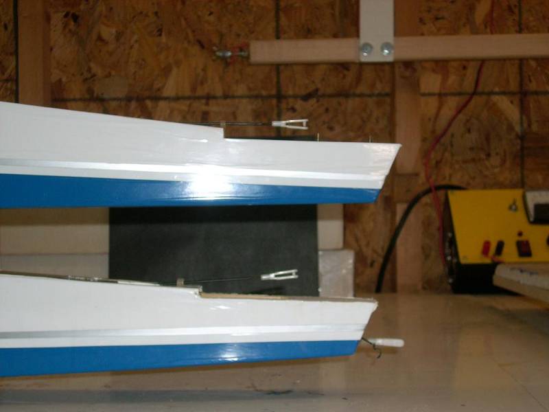

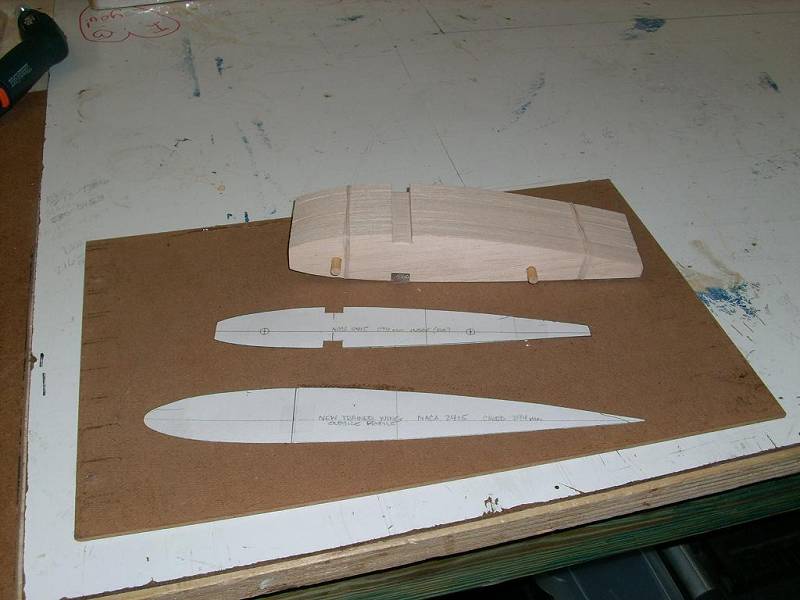

Gotta agree with da Rock. In full scale, you add throttle to climb and then re-trim evevator to maintain. It's so funny that I have no problem flying full scale, where I can see and feel every thing from the cockpit but have a hard time sometimes, looking up at my models from the ground. For me, controlling an RC model is harder I went ahead and reworked the horz stab on the model and it's now at 0 degrees decalage. Weather permitting, I'll give her a try tommorow and report back on the change.
The pics are of the re-worked horz stab saddle and another fuse (a spare) in it's original state for comparison.
And, the ribs for the new semi-symetrical wing in the works.

Keep in mind that along with the decalage change you'll most likely need to move the CG back to see the improvement. Otherwise if you leave the CG where it was you'll have to add up trim to achieve normal flight and the effective stabilizer angle will end up right back where it was and you'll still have the strong climbing tendency.
It's the CG location that is the real culprit in all this. You COULD have just moved it and added down trim to effectively do the same thing as cutting and gluing the stabilizer on at the new angle.

Bruce, I'll be sure to bring some lead with me to the field to adjust the CG and see how she does. Thanks Tim

Update on the Degalage modification................ 0 degrees decalage= One great flying plane now! It flys strait and level at 1/2 throttle with one click of UP trim, and still climbs out fantastic with added power. No change in the CG was needed either. It still floats forever on final and you have to fly it down to the runway, but, I'm sure that the new semi-symetrical wing will take out a bunch of that. Thanks for all the help and advice on this one guys, and I'll post back on this forum when I get the new wing done with a flight report. Tim
