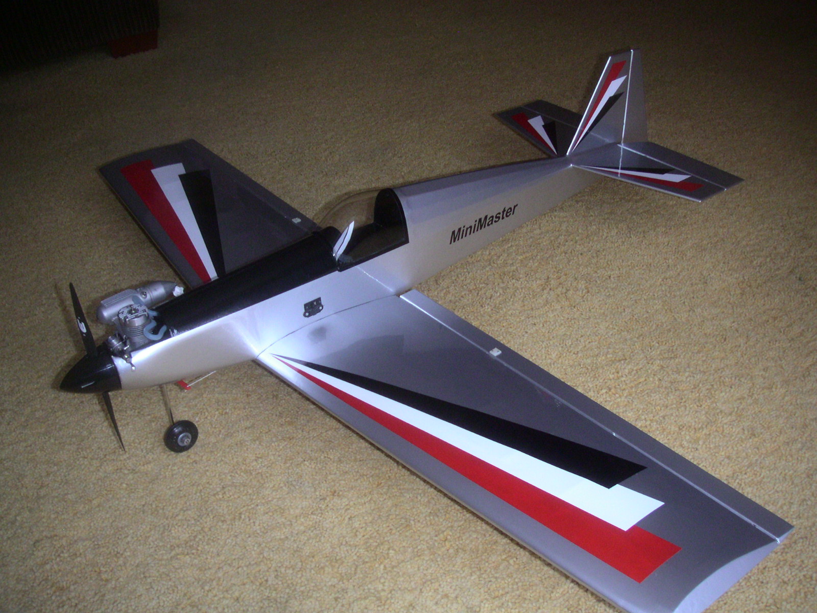

dksnyder 02-25-2014 01:04 PM
CG with tank FULL or EMPTY
1 Attachment(s)
I just completed an Andrews MiniMaster .25 powered sport flier. Great kit... fun to build!!
The suggested CG location is shown on the plans, but it doesn't say if that is for fuel tank full or empty.
With a 4 oz. tank, that can be almost 1/2" difference (3 1/3# all-up weight), or 5% chord!!I
I guess for the initial T/O, it would be best to use the more forward CG location (balanced with empty tank).
Balanced with a full tank might result in a stability problem with the fuel burned off.....
I just don't know what Lou Andrews assumed with his CG location.
Anybody have any ideas? .... similar experience??
http://www.rcuniverse.com/forum/atta...mentid=1972319
Marzy69 02-25-2014 01:18 PM
Always set c.of g with tank empty ... rather have a nose heavy than tail heavy plane.. unless im prop hanging hahaha
wkevinm 02-25-2014 01:50 PM
I set the Centre of the tank on the cg, this way the plane flies with the proper cg through all tank levels. I use a Bladder tank so the the blader does not allow fuel to slosh about or foam up.

alasdair 02-27-2014 03:03 AM
On the very rare occasions when the fuel tank is at the rear of the model, you go for the worst case (aft-most CG). You would balance with a rear mounted tank full, UNLESS (as in the case of the Northstar) the plan gives a CG for an empty tank, in which case an allowance has been made for the CG shift when it is filled.

Lnewqban 03-01-2014 09:29 PM
Originally Posted by dksnyder (Post 11745785)
............Balanced with a full tank might result in a stability problem with the fuel burned off...............
The correct answer was in your question. :)
For proper pitch and yaw stability, the aerodynamic center of the airplane must be aft the point in which the weight is concentrated (just like in any arrow).
As the fuel is consumed and the nose gets lighter, the center of mass or weight relocates closer to the aerodynamic center, but it will not reach it if you follow the designer recommendations.

BMatthews 07-07-2014 06:23 PM
Originally Posted by wkevinm (Post 11746323)
If you are unable to set up with the tank on the cg, move it as close to CG as reasonable and measure cg with tank empty as Marzy69 suggested nose heavy is more predictable than tail heavy.
wkevinm
That might work for an engine with a fuel pump or with a pressure bladder. But for direct draw or the usual muffler pressure tank you can`t do that. The tank has to be as close as practical/possible to the needle valve. This generally means right up against the firewall with the top of the tank just at or maybe as much as 1/5 of the height above the needle valve.
Dksnyder, as some have said you ALWAYS set the balance with an empty tank. You simply live with a slightly more nose heavy trim when it's full.
As you gain more flights on the model you can consider moving the CG back in small increments and test flying to see where you hit the spot you like.
As for the first flight CG position Lew Andrews, who designed and kitted this model, was a long time flyer and excellent designer. He's got a fleet of great flying models to his credit that made it as kits and made many of us happy. So if he says "put it here" then you do what it says.
I know the rest of you are trying to be helpful but when the plan shows a CG location it's pure folly to second guess this and try something else. Any designer of a model like this is going to show a range of CG locations or a single spot which produces a safe first flight.

BMatthews 07-08-2014 11:14 PM
Yep, the idea of moving the CG to suit the flyer is a good one. Some like a little more positive pitch stability and others find they like a more minimal amount. Shifting the CG and doing the associated elevator re-trim is a great way to set the amount of pitch stability to suit the taste of the pilot. So I'm going to go along with ahicks on this.
Hossfly, the Eindecker in scale version has such a small horizontal tail that even with the long tail length I'm shocked that the company would suggest that far back a CG location. I guess that not all of them get things right. If I were to run the measurements for a proper small scale size tail through some of the CG calculators I'd fully expect them to come back to me with a CG location at something like 23 to 25%.
But for some other designs with a large horizontal tail on a good length fuselage a 33% position isn't out of the question at all. It's just a shame that they messed up that Eindecker plan with the wrong position.
Still, you and the model survived..... :D How was it to fly once you got things dialed in? And just how faithfully scale is it?
