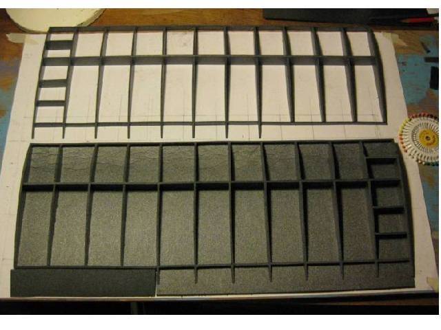

The solid foam wing was next..Using 3mm Depron i fabricated a new wing.
https://cimg5.ibsrv.net/gimg/www.rcu...c7edea4a4c.jpg
https://cimg0.ibsrv.net/gimg/www.rcu...a23132e7d2.jpg
Being basically hollow the new wing was lighter by 20g) had a similar strength and lkely better aerodynamics. Still more performance.

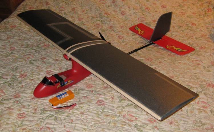

This then posed the question "how much longer could a similar sized plane fly if it was specifically designed for endurance?"
A lightweight aerodynamic air frame, efficient motor and prop and a big capacity battery.
With a slow programme of improvement I eventually got this plane to fly for 1 hour with a 1000mA 2s but at the same time carrying ballast to match a 5000mAh battery. In other words a theoretic endurance of 5 hours.
https://cimg2.ibsrv.net/gimg/www.rcu...eaacfe96a2.jpg
It was flying on just 1A. On a 2s that is 7.5W. As it weighs 436g or 1ib that's a remarkable 7.5W/lb average power..
The final twist is it has over 10 times that available at full power so it is even modestly aerobatic too!.
I have never actually flown it for its full 5 hours as after 2 hours I decided that was my limit even if the plane could go on for longer! .
