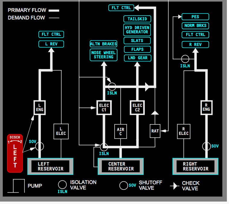

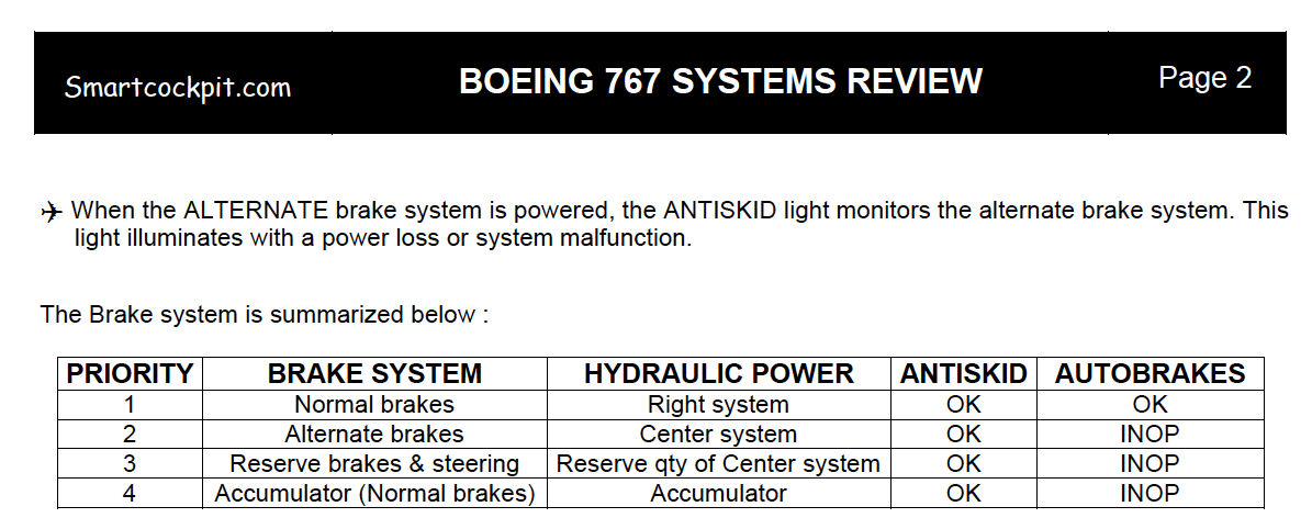

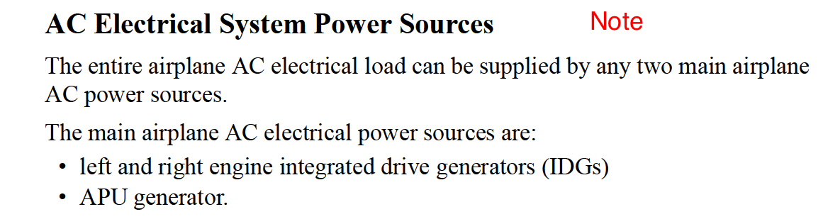

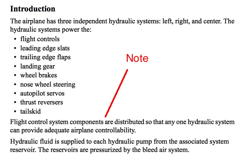

I agree losing an engine in flight is not ideal but it is definitely not as bad as your post makes it sound.
Modern transport category aircraft can generally fly and land safely if one engine fails.
Lets work though your points taking the 767 as an example...
Electrical - the entire aircraft system can work normally if one engine is lost.
Hydraulic - the 767 has three Hydraulic systems, Left, Centre and Right, The left and right are powered by an engine driven hydraulic pump AND a separate electrical pump. (See diagram below) If one engine fails you don't lose the associated hydraulic system at all as the electrical pump will keep it operating.
Also just one hydraulic system will provide adequate aircraft controllabilty.
Thrust Reversers - They don't provide the full rated thrust in reverse and you are not relying only on the brakes to keep straight - the rudder is very effective during the high speed phase of the landing roll. You also have ground lift dumpers providing drag and making the brakes more effective.
The aircraft I fly is a twin engine corporate jet roughly the size of a 717, you can use a single thrust reverser on landing no problem at all. We practice it annually in the simulator. (see checklist below) - I don't know about the 767 but I'll ask a friend who flies them.
Brakes - The brakes have back up systems, The 767 has two back ups, the first alternate braking is via the Central Hydraulic system (powered by an electric pump) and the second back up is via the brake accumulator. There is no risk of spinning at all as these systems operate both the left and right wheel brakes.
Even very small corporate jets have back up and emergency braking systems.
Thrust - loss of an engine will affect performance but as you say airliners must demonstrate the ability to keep flying after losing one engine or they won't get certification. At full throttle with one engine failed in level flight at 15,000 feet we have to throttle back or the aircraft will exceed VNE.
http://www.rcuniverse.com/forum/atta...mentid=2153821http://www.rcuniverse.com/forum/atta...mentid=2153822http://www.rcuniverse.com/forum/atta...mentid=2153823http://www.rcuniverse.com/forum/atta...mentid=2153824http://www.rcuniverse.com/forum/atta...mentid=2153825

Your commuter jet probably has the engines located in the rear on the sides of the fuse. You can probably get away with using the reversers on it. The problem with the 767 is that the turbofan centerline-to-centerline distance appears to be 51' 11-3/8" [15.83m], with a turbofan air intake of 94.072 inches [2.389m]. Engine nacelle outer "width" is about 109.99 inches [2.79m]. This means you are getting 26 feet of leverage with the full reverse thrust trying to spin that aircraft. As you said, the reverser does not give 100% but even at 75%, you're getting up to 47,500 lbs of thrust meaning 1,238,250 ft-lbs of torque trying to spin that plane, not an insignificant amount

You are right, our engines are mounted on the side of the fuselage and I totally agree with your point that a wing mounted engine has more 'leverage"
The 767 has a VMCG (Minimum single engine control speed) of 106 kts, Below this speed the rudder is not effective enough to compensate for the yaw - this is assuming full thrust on the good engine.
During a landing if using 75% throttle with reverser you are not getting the same value of thrust "in reverse" that you would normally, the reversers are not that efficient.
Reversers are most effective during the high speed phase and are closed on many aircraft below 60 Kts.
Another point is that landing distance does not increase dramatically if you don't use reversers, 30-50% typically, at most airports there will be ample runway to stop without reversers.
A flapless landing is far worse and can require twice the runway to stop. I have a couple of friends that fly 737s and 767s so I'll ask about single engine reverser use. I honestly don't know if they do that for those aircraft.

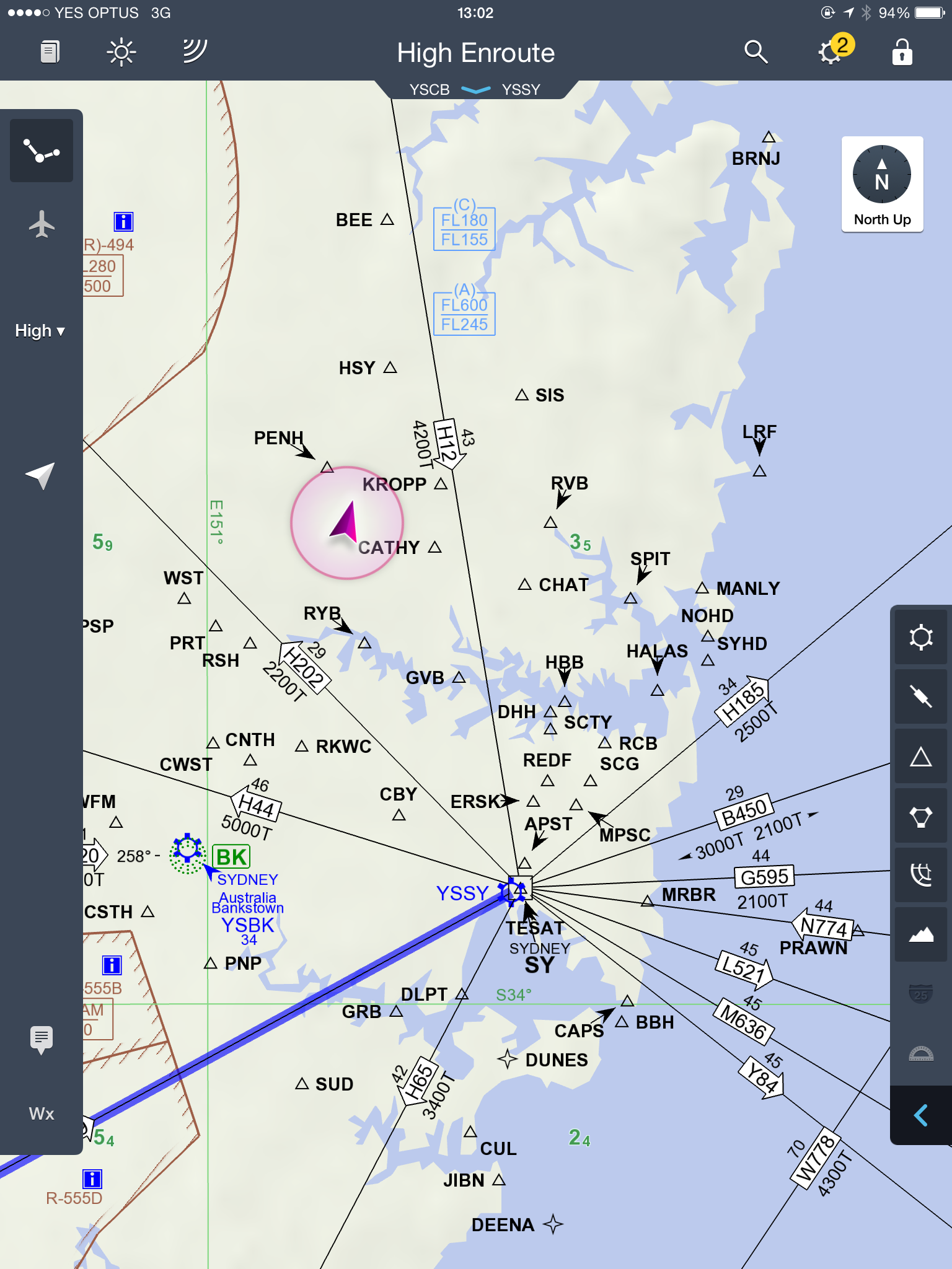

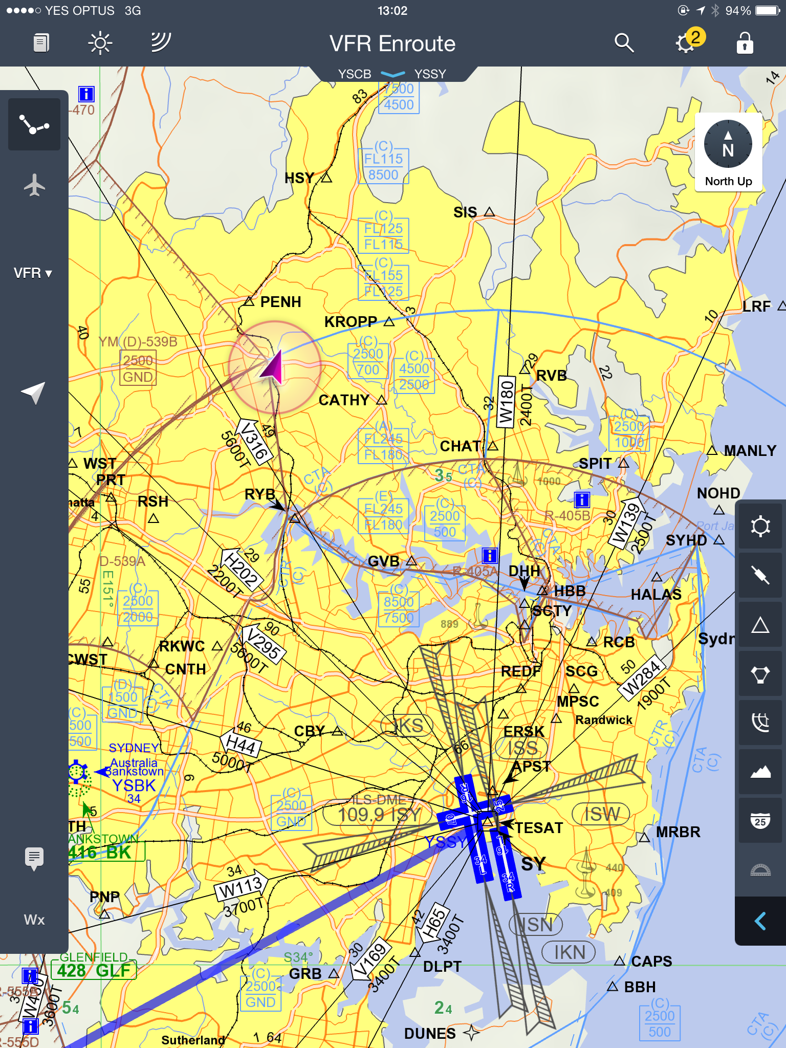

It really is amazing the changes over the past 5 years alone. We fly with a true paperless cockpit using iPads for chart display and these show real time tracking in flight and on the chart itself. .
So much easier than fumbling with paper charts and amendments are automatic and take minutes instead of manually replacing charts for hours.
The aircraft databases are updated every 14 days via a usb stick. Occasionally there are cabin system updates that automatically download via satellite during a power up.
http://www.rcuniverse.com/forum/atta...mentid=2153921http://www.rcuniverse.com/forum/atta...mentid=2153922http://www.rcuniverse.com/forum/atta...mentid=2153923
