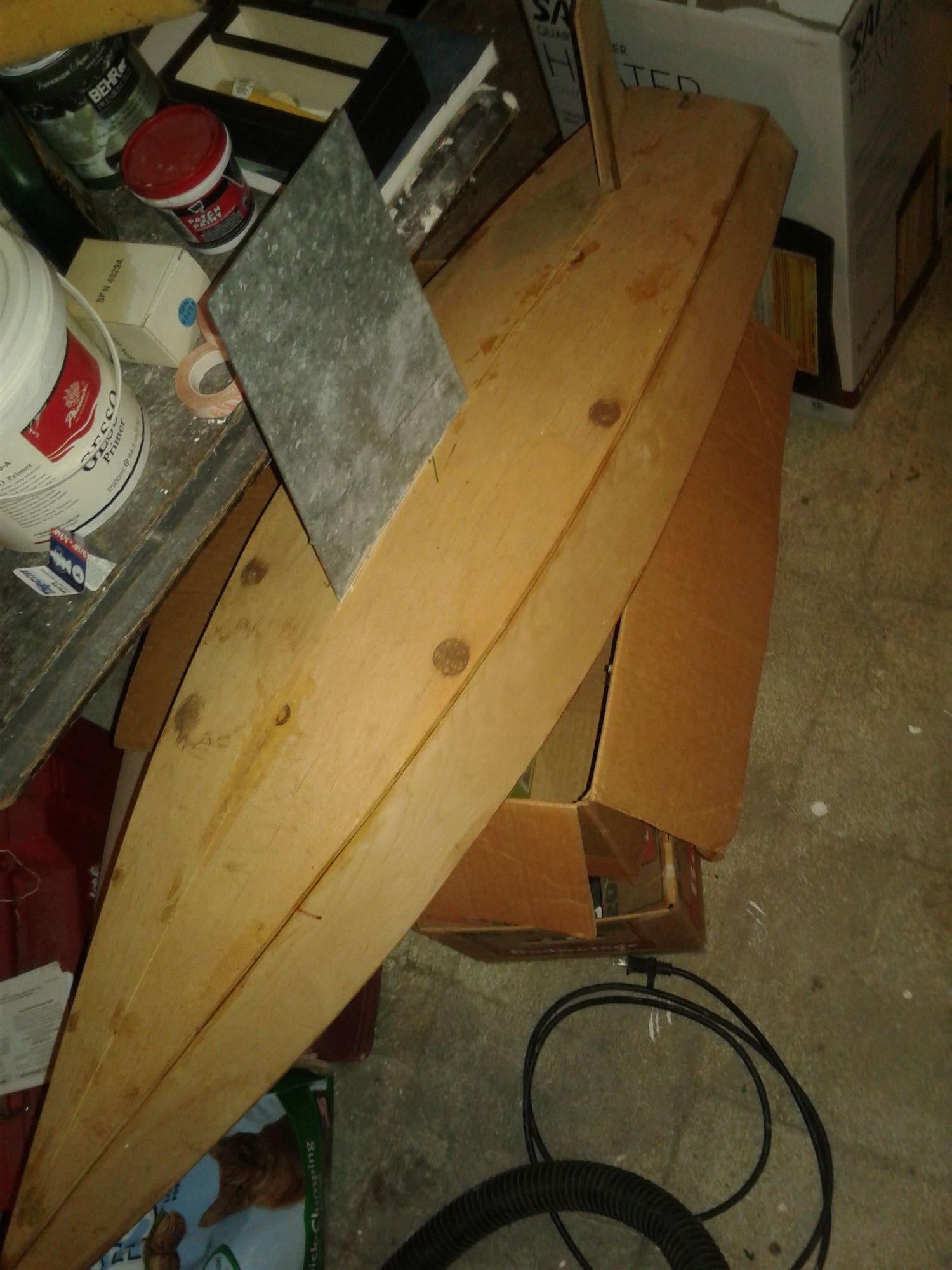

https://cimg1.ibsrv.net/gimg/www.rcu...7e90064b60.jpg

I haven't seen one of those in years. If the wood is still in good shape, you done good

Scary thing is I recognized the hull design without being told what it is. If the wood is still good, finish the thing and sail it. If you need help doing so, just ask.

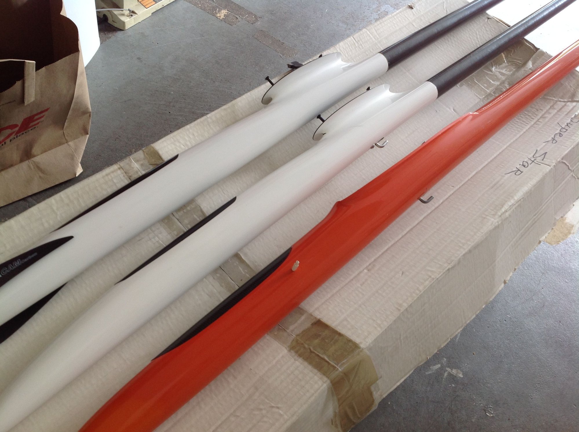

https://cimg9.ibsrv.net/gimg/www.rcu...2e6a5dba90.jpg
Note the short stub antenna on the Orange fuselage
Absolutely correct, as I said in my previous post it should be more of a concern with 2.4ghz due to the fact that the higher frequency does not " penetrate " as well as lower frequencies. Yet in spite of that the standard install is to have 2.4ghz antennas internal. A good example is this lineup of my contest sailplanes. Note that the two white sailplanes have Kevlar construction and the antennas are internal. The Orange sailplane is CF construction and has its antenna ( just the last 1/2" ) external. All 3 sailplanes have topped 1,500 ft in multiple locations. Like I said to Appowner. Keep in mind that when it comes to the hobby I have more experience and at more then just an armature level!

A 1/4 wave antenna for 2.4 is just shy of 5 inches long. All of which should ideally be outside any carbon. Unless there's something else at work here. Please enlighten us with your expertise and explain WHY you have only 1/2 inch of antenna outside the fuse?
