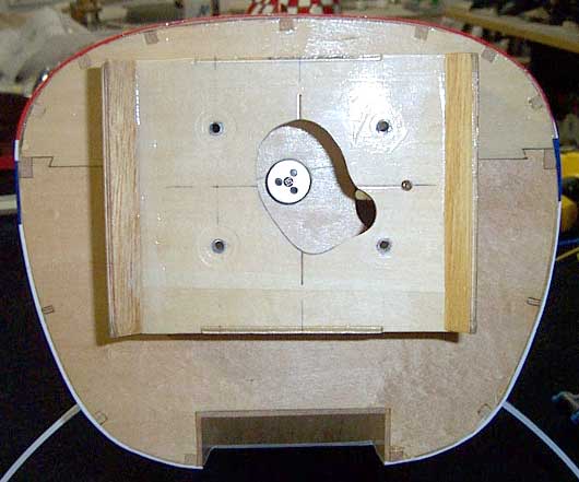

I chsoe a ZDZ 50 because of my good experience with my first gas engine... a ZDZ 80.
Some people ask about the rear carb design (which also is used on the DA 50... It;s not much more difficult to setup, once you now how.
here a re a couple pics showing the firewall cutout and the pushrod routing.

Pic #2

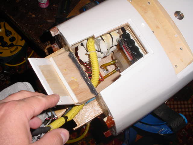

Hatch is hinged in the front and screwed shut. While I was at it , I moved the ignition and it's batt. into this newly available compartment to redistribute some weight and move the ign. box into a safer environment.

Ram - great job on those hatches but .... why did you need that battery so far back? Thats a BME 50 isn't it? I was planning to use a single rudder servo on pull pull with my DA 50 - am I gonna need tail weight?
Old 08-05-2003, 09:50 PM
ram3500-RCU
My Feedback: (221)
ram3500-RCU's Avatar
Join Date: Aug 2002
Location: n. canton, OH
Posts: 9,735
Received 12 Likes on 6 Posts
Default RE: GP Patty Wagstaff - Building & Flying
The engine is a F.P.E. 3.2. Bumped my head on the way to buy my tank and got a 32 oz. I fly twice between fillups and still have a reserve ( 15 min. flights) but needed to move the batt. back about 4 in. from where it was. Couldn't get the tank on the CG.
