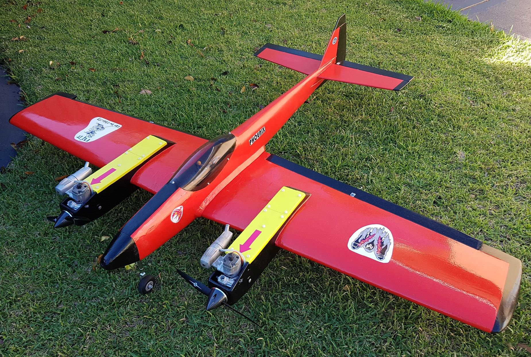

.........After REALLY regretting my decision to sell the 337 I have posted above this I have now organized an O2 to come all the way from the states to Australia!!
With the help of Model Flight, a shipping container and the ship (!!) it has arrived on our shores and is currently on it's way to me. I must have a weird thing with twins. I not so long ago scratch built a Pica Duelist with x2 OS 55AX's and it flies exactly how I wanted it to which is pretty damn well!! I think this forum will be slapped back into action once again when I start rambling on with the progress of the new 33(7).......STAY TUNED!
Pica Duelist
Pica Duelist

And yes it is heavy.....similar to a scratch built Pica Duelist twin I built with x2 55AX's in it......same motors as I am going to have in this one so it will go quick!!

(I have electron retracts in a scratch built Pica Duelist pictured above but this one is not worth it IMO...)
