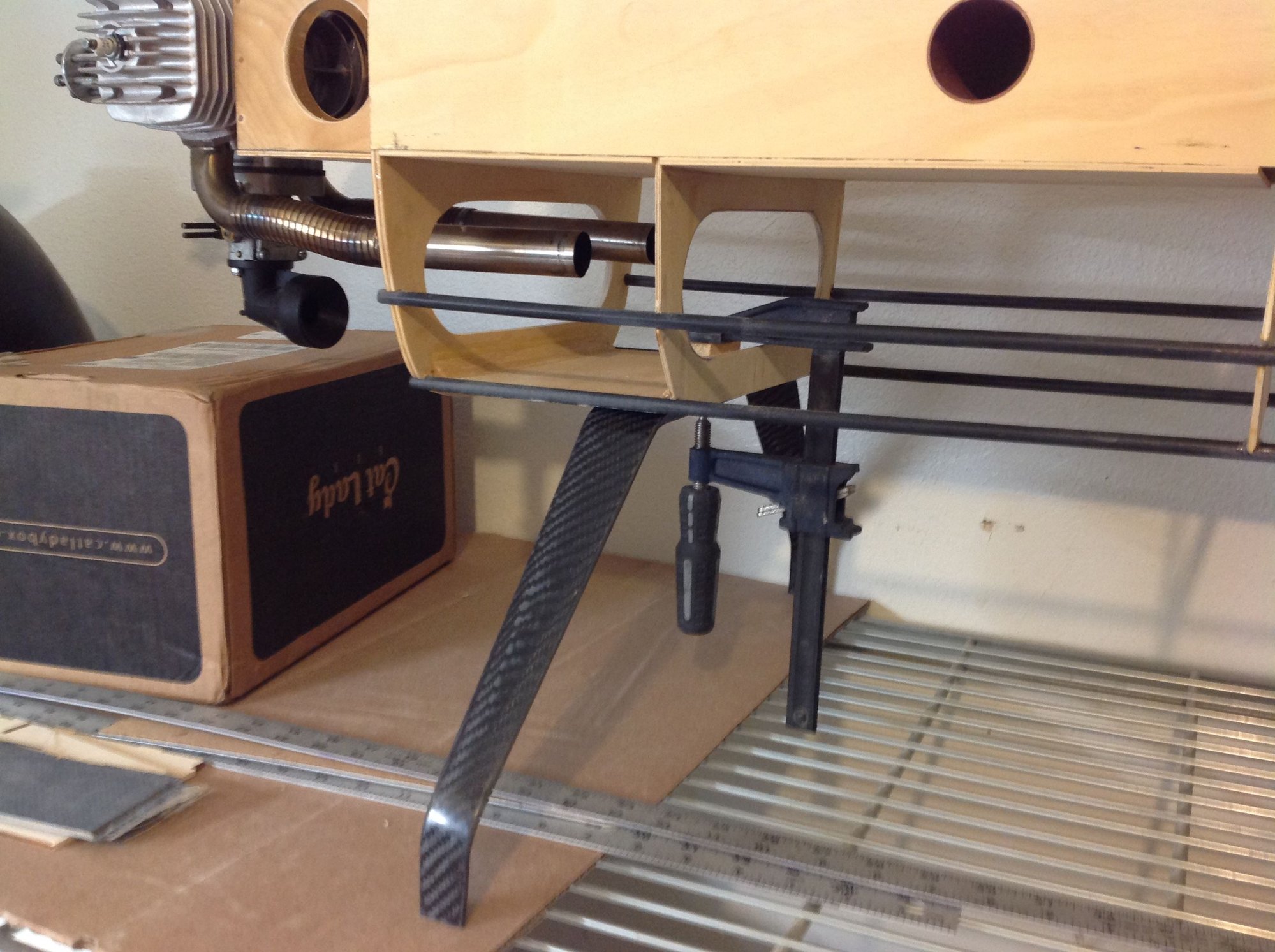

Just started assembly of 540 with Saito 82. What final weight are you folks seeing. - especially the one using Saito 82. Also it was stated on the one with the 82 that the cg was estimated at 95mm! Seemed like a pretty far aft cg so was wondering if that had been verified. Thanks for any help you can give me. Sure looks like a well made plane. I mostly build scratch designs and would struggle to buy the materials for what this ARF cost. Bryan - Columbus IN

[QUOTE=warhwk;12662895] "I'm the one with the Saito 82. It flew at the recommended CG, but it landed a little hot and did not want to flair. Inverted flight took a lot of down trim.
I relocated the battery moving the CG approximately 10mm. It flew inverted completely hands off. Landing was now a dream with the ability to drag the tailwheel on landing. However... the elevator became MUCH more sensitive. Low rate became my high rate.
My advice is to fly it at the rear of the recommended CG, then adjust 5mm at a time until it will just fly inverted hands-off. If the elevator gets touchy, reduce throws or add expo as necessary.
She's been a favorite of mine for many year" I am making some progress. My estimate is that the final weight will be around 90 oz so wing loading would be 23 oz/square foot if you include fuselage area between the wing which is how I usually calculate it. If you just consider just the wing area it is anout 26 oz/square foot. However, I feel that the plane is "tippy" more because there is no washout in the wing rather than the relatively high wing loading. Couple that with the tapered wing and it is pretty predictable that the wing tips will stall first. For packaging reasons plus improved cooling I am mounting the Saito 82 inverted so the valve covers and cylinder head will protrude from the bottom of the cowl. With a 90 degree adapter the muffler wll remain inside the cowl with a silicone discharge tube. While laying all of this out it does appear the striping on the cowl is about 1/2 inch low. Ugh! This is too bad since they did a really nice job painting and triming the cowl. Anyway I remain impressed with the overall quality of this ARF. Dont know how they do it for price - seems imposible.

In my last post I had a big error in my caculation -- forgot to include weight of servos/battery/rec. Sorry. So the wing loading as I calculate it is about 26.5 oz/ square foot. So, yes pretty high wing loading. Definitely won't be a floater like my other planes that are in the 17-20 oz/square foot range.

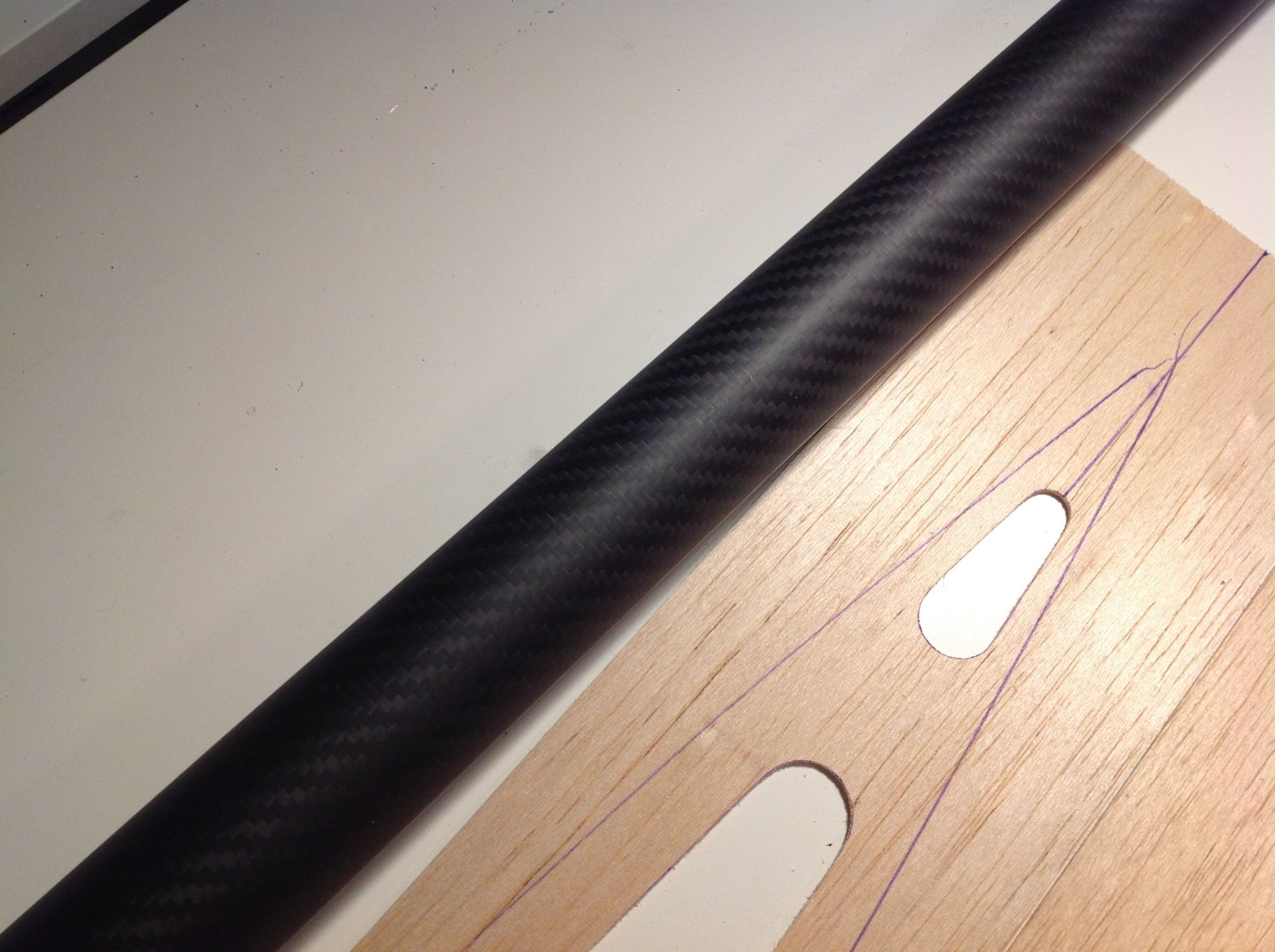

Thanks for the response. My ears were burning. I was just starting to search for a carbon fiber wing tubes and landing gear. Any advice on sources would be appreciated. Like you suggested I am exploring every area to remove weight -- like 4.8 volt receiver pack vs 6 volt, material removal in engine mount structure, built in wooden motor mount to eliminate blind nuts and bolts, mini servo for throttle, locking prop nut so can eliminate double nuts, carbon fiber push rods/landing gear/wing tube. On the planes I have designed and built through the years light weight has always been the goal and the reductions are usually in small amounts in a lot of places. Yes the washout is not a thing you want if you are looking for snappy performance. I doubt that the full size 540s had any washout but not sure. Your comment on a sharper leading edge was interesting. Is the difference in sharpness noticeable or does a little difference go a long way? In my files I found an old article that suggested on a finished wing you could add a narrow sharp triangular "stall strip" extension, a few inches long, to the leading edge near the root to to make the root stall first. Or you can add it to the leading edge near the wing tip to make it more snappy. Wouldn't look good but I may experiment with the concept to see what I learn. I sounds like it is using the same principal as sharpening the leading edge. On cg location the information in this forum, and others as well, suggest that it needs to be pretty far aft. 87-95 mm from leading edge. The manual calls for 80-85 but folks say it is noticeably nose heavy and doggy in that range. I will probably start at 87 and work my way up. Since this design sounds like it is inherently nose heavy I am hopeful that I can adjust the cg by moving stuff around and not adding any weight. Thanks again for your advice and help.

Posts: 8,150
Received 69 Likes on 66 Posts
ZY hobby for the landing gear.
https://www.zyhobby.com/products/3k-...xtra-260-100cc
Ebay vendor for the wing tubes.
https://www.ebay.com/itm/25mm-3K-Car...Cclp%3A2334524
I just ordered from both these places to get CF parts for my 35% Edge.

Have about completed the build and waiting on good weather to fly. I did several things to reduce weight -- smaller servos, carbon fiber landing gear and wing tube, removed a lot of wood from fuselage and motor mount area. Overall I saved about 8.5 oz and the plane ended up weighing 5 1/2 pounds. The wing loading end up being about 22.7 oz per square foot. Should be a good flier with the Saito 82. I plan to do the first flight with CG at 90 mm. Will post results after initial flight.
