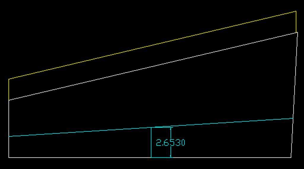

Let me start by saying that my Phoenix 55” edge 540 is still in the box. But your situation got my curiosity up so I grabbed the box and pulled out the parts and did some measuring.
I have done a bit of experimenting with “balance points” on a few planes and have learned a few things both from reading and experimentation. Anyway, for the sake of conversation and thought, I will throw in my two cents.
I think the general consensus for a starting point, for the balance, is around 27% mean aerodynamic cord. Or would it be safe to say average cord? A couple of things that I have learned that will allow you to move the balance point more reward are; light wing loading and a large horizontal tail surface area. Also a flying stab (airfoiled stab) will also make a difference. Not to mention wing attributes can also play an effect on moving the balance point. The shape, airfoil thickness and so on.
I just realized, that as far as wing loading goes this thing is a PIG! So, I drew up the wing on my computer and calculating wing area including the area occupied by the fuse this airplane comes out to just over 557sq in. Using only the wing surface there is almost 485 sq in.

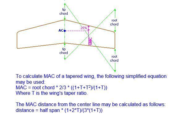

Taking what I now know about this plane I would start the balance point somewhere really close to 26% - 27%. At 27% I come up with 2.653” from leading edge shown in the first picture below. Using the second method that I have a picture of suggest 2.725” from leading edge
I know these are way off from what the manual says? None the less, when mine goes together I will use these numbers as a starting point and fine tune based on flight performance.
Here are pictures to support where I came up with the distance:
My initial calculation
This calculation is from some documentation that I have from way back when

Thanks for your thoughts. Yes, the number I came up with using the "on line" c.g. calculator was 560.16 square inches including the fuselage area which was pretty close to what you calculated. The MAC was 10.45 inches and it was 12.42 inches out from the center of the fuselage. I have used this calculator on several scratch designs and it has seemed pretty accurate. This program suggests 3.82 inches behind the leading edge with a 5% safety margin which is quite a bit further aft than your numbers or the recommended numbers in the kit. My first flight , however, suggests your numbers may be more correct! All the planes I fly are in the 18-20 oz per square foot. This plane, if I had built it without any changes would have been 96 oz which would be 24.68 oz per ft squared which made me uncomfortable. By using small servos, carbon fiber landing gear and wing tube plus a few other odds and ends I was able to get the plane down to 90 oz. So as I am testing it now it is 23.13 oz per square foot. Better but still a little higher than I would like. The latest article I read about this Phoenix plane (although it looks like a prior design with servos in the rear and a different color scheme) came out to be 129.6 oz which would be 33.32 oz per square foot!! The article said it was a highly loaded wing but said it flew okay which was a real surprise to me. Anyway, I will keep you posted on what I learn in the next several weeks.
