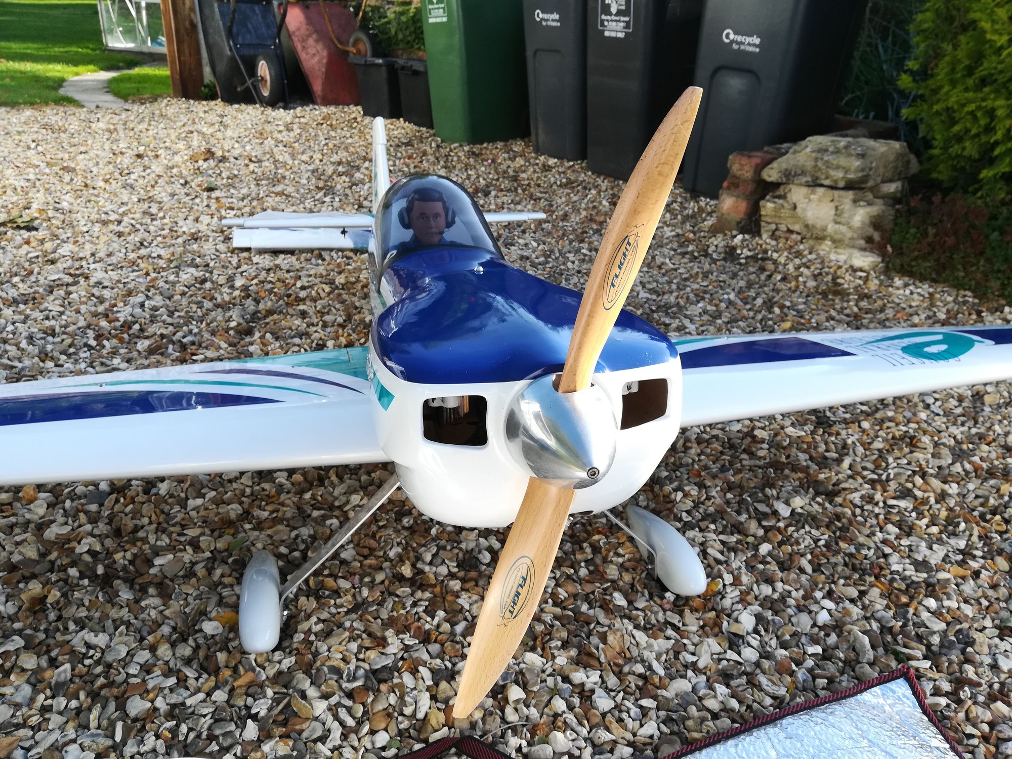

Glens Models 30% Cap232
Just bought a 30% Glens Cap232. CG is 121mm back from LE, that’s about 1” in form of the centre of the wing tube. Got a DLE55 with a canister.
Absolutely rock solid airframe. Rolls axial, no stip stall and very stable. Love it
