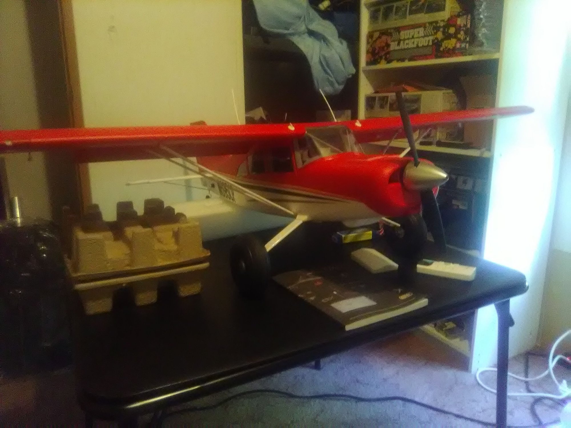

Finally got around to getting my Maule together, unboxed everything and two issues. Can't find the screws or binding plug, anyplace is there a secret location I'm not seeing? Other issue is the motor. The shaft has an obvious cock to the right when looking above the cowl. I've always know the shaft to be straight ahead and 90 degrees from the cowl. Is it suppose to be like that?
Something tells me this kit was ravaged for parts, the box was obviously opened up before and now missing screws... Man, what a let-down.

The firewal/motorl is offset for torque (p-factor)
Check the packaging carefully, or call horizon and they will replace them

1. You can use any bind plug, it just shorts the signal line to ground line. Since every plane or receiver comes with one, you probably have some spare laying around? I have one or two in my flight box, I don't bother to keep every one that came with every plane, I just toss them.
2. Pretty much every plane has motor shaft facing down and to the right. Otherwise the plane climbs and turns left with throttle. The amount depends on the plane and the motor.

I did the bind last night and I now have control, but I see my flaps do not go all the way up. I adjusted the flaps according to the manual for switch D and it says 0 position 100% 1 position 4% and 3 position 100% It's a DX6e radio. I'm not sure if the manual is correct or not so I don't know what is going on. All the rest of the controls work however SAFE select doesn't seem to be on, even though I bound the reciever with the SAFE ON method. I assume if you tip the plane side to side, SAFE should move the surfaces to compensate? It does nothing. Please excuse me I'm new to these modern computer radios....it's been a long while.

I looked up Maule manual....it suggested flap position 1 should be 0% flap and 4% elevator, and position 2 should be 100% flap and 10% elevator. It is normal to mix some down elevator with the flaps, because deploying flaps will cause the plane to climb otherwise. If it is set up right, you should be able to see the elevator go down just a mm or less when flaps go down. If the flaps don't go all the way up when Switch D is selecting 0% flaps, then I wonder if you can fix that with "subtrim" menu on the DX6e. It does have subtrim, right? I never had a DX6e.
I think you are right that if SAFE is on, then holding the plane at a tilt should result in some control surface deflection. I notice in the manual the following indication also: "Every time the receiver is powered ON the surfaces will cycle back and forth twice with a slight pause at neutral position to indicate that SAFE Select is switched ON." If SAFE is off the surfaces will only cycle once instead of twice.
Mine says position zero is minus 100% flaps the 1 is 0% and 2 is plus 100% picture included. I figured it out though...it says MINUS 100% I didn't see that and put in plus 100% works perfect now, but when flaps are full up, servos are buzzing. I don't like that, might burn them out . I didn't assign a switch for safe select last night, but did today and now SAFE works great. I flipped the little plane over and it immediately deployed full surface deflections. I never had a radio system this advanced so it's a bit "wah" for me, but I'm getting the hang of it.

it says MINUS 100%
Oh that totally makes sense now - I missed that also. I was wondering why it went 100,0,100, that makes no sense. OK, so they suggest 0 = no flaps, 1 = takeoff flaps, 2 = landing flap. That is very normal.
If the servos are buzzing with full up, you should be able to click on the -100 and back it off until it stops buzzing, like perhaps -95 or something. I agree, it is burning current and wearing the servo if it is constantly pushing hard against a dead end.

AS3x does't arm until the throttle is advanced past 25% the first time after connecting the battery.

Im going to disconnect the flap rods and then deploy flaps via transmitter and see if servos still buzz. If they don't them might be the flaps are just bottomed out. I'd like to try and fix it mechanically first by twisting the clevis in a bit and see if that works. Thanks for the help...really thanks

Yepp I just figured that out like an hour ago. I also learned you have to assign a switch before SAFE works too. I thought SAFE just worked no matter if you had a switch or not. I like the switch.... I guess SAFE won't let you do rolls and things, but I don't plan to use it for long...just until I get the hang of all the systems and flying of the plane. I never had a computer radio like this with all these functions....so I'm learning.

I ended up disconnecting all the control rods from the control surfaces and putting all the trims and subs to zero. Then taped the surfaces perfect centered and adjusted everything to fit the horns. All hooked back up and surfaces still centered level. The buzzing in the flap servos are gone, so I'm satisfied. Now a prop balance and get cg right. I'm just going to do the finger tests for cg, at around 63 mm(half way between the suggested measurements and see how that turns out. Hopefully just have to move the battery back or forwards. Other than that, I think I'm a day from maiden.
