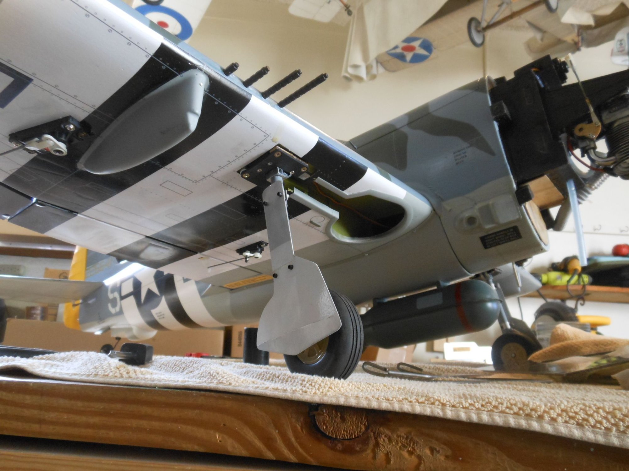

Another problem is the landing gear doors which stand so far off the wing as to be unusable in my opinon. I elected to make new gear doors out of .05 aluminum. The struts seem kind of flimsy but I won't know until I get it to the field.

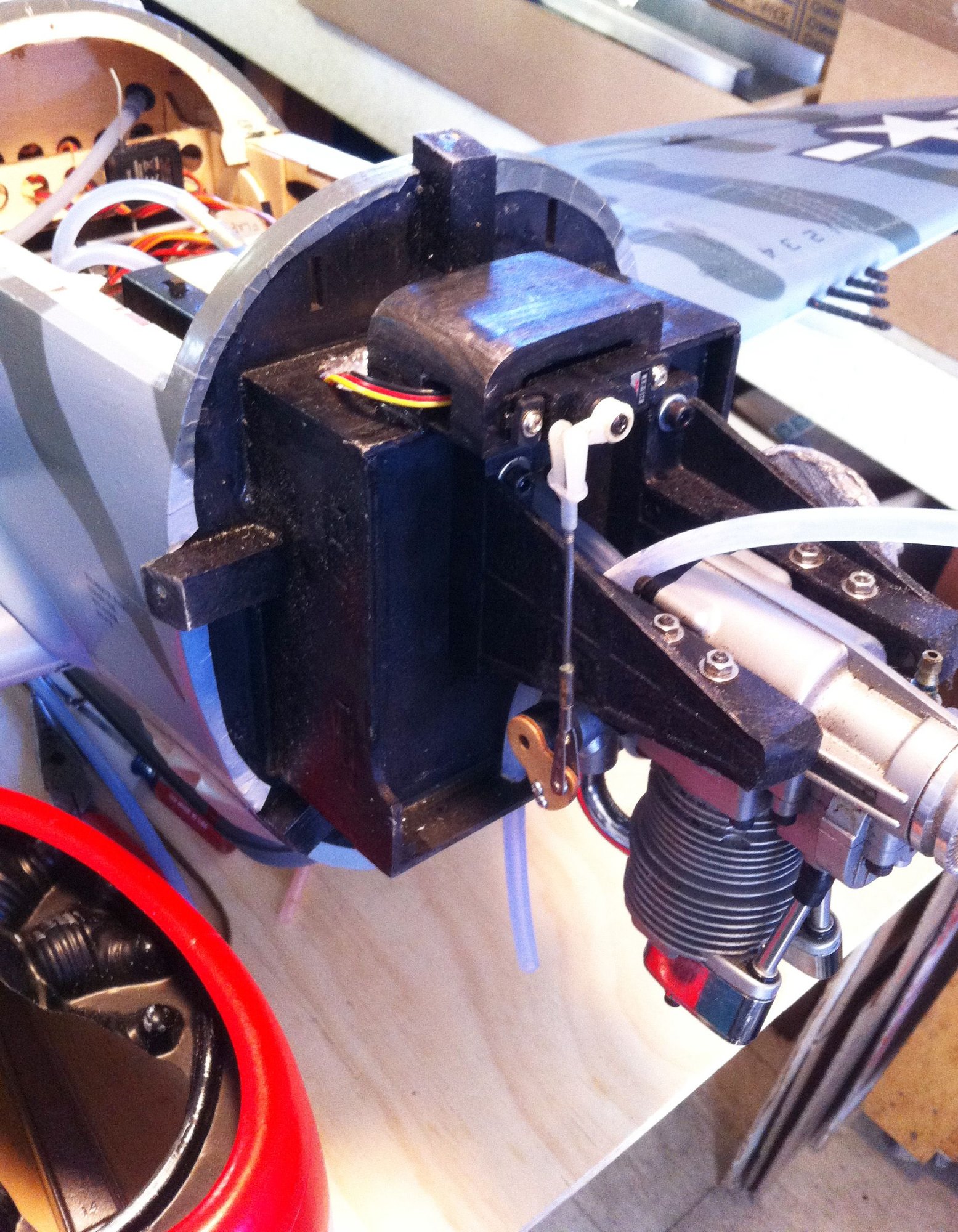

One of the first things I did was to reconsider the throttle servo location which is called out to be in the area above the wing with the rudder and elevator servos. The model from which I took the engine and servos from had the throttle servo in the engine bay, above the engine. I made a mount to do that on this plane and was able to utilize the linkage without modification. More importantly, this opened up the main tank area since there was no linkage passing through it.
With more models than I have easy storage for, I have to hang my planes from the ceiling. This means placing a tube through the fuselage at the balance point for hanging up the model.
Since I also reclaimed an on-board glow system from the old project, I needed a place to put it - along with the Rx and the charge plugs. A plywood shelf covers the batteries (Rx and on-board glow) and provides the surface for the other functions.

The landing gear doors were flat wood and stood off the surface about 3/8” which looked terrible as well as being bad aerodynamically. My workout uses aluminum and, with a bit of crown to the surface, fits better to the wing. I made U-shaped brackets to hold the door to the strut. I left them in metal finish which is actually what I have seen on photos of the real aircraft.

Here is more on the lateral tube on the fuselage which serves a dual purpose, hanging the plane from the ceiling and checking the CG. Like many people, space in my workshop is very limited so hanging is a great way to store models. On electric planes, the hanging system is placed at the storage CG (no battery) so it can't serve to check the flying balance point.

Impressive door brackets. I have studied your picture, but cannot figure out how you attached the alum tube to the mounting surface?

The bracket was made by bending aluminum sheet around a drill bit of the right size in a vise. This needed a spacer to fit right so I attached that to the hat shaped part, marked,
drilled and bolted it all together - before slicing off the individual parts like baloney. With a little fitting, it did the job.
