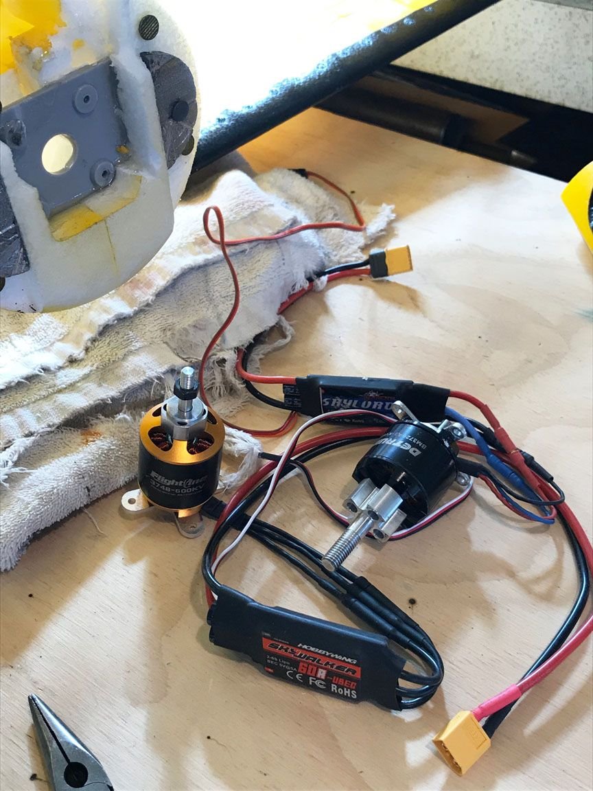

I have been struggling with this model, to get it to fly well. The provided power system just doesn't give even marginal performance. So I ordered a new motor and speed control, installed in the plane and flew it today.
Power is much better, the loops are large and graceful and the plane can be flow slow too. The quality is still lacking and, after almost every flight, I am tightening up screws and bolts. The latest on that score is the fact that the landing gear comes loose, just flying around. I will break out the locktite
this afternoon.

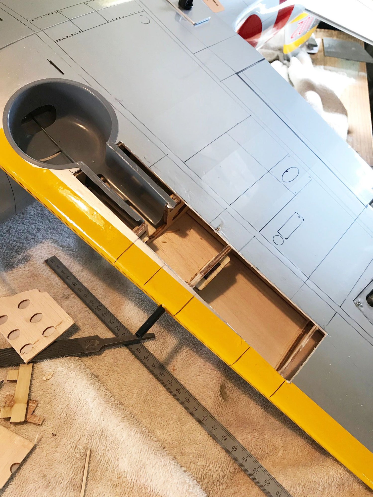

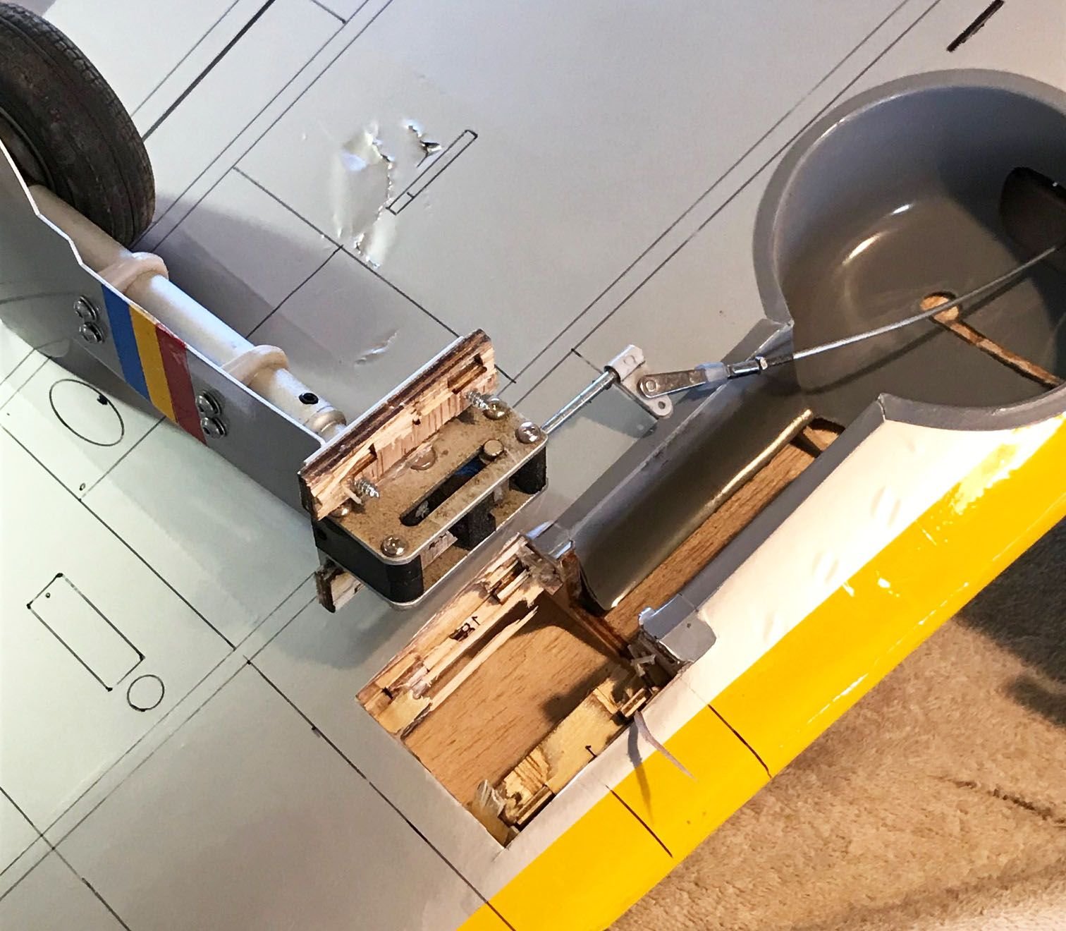

Update on these two models:
The Dynam Waco continues to disappoint with regard to quality issues. The canopy keeps flying up and nearly off, forcing me to land. I need to put a bunch of pins into the sides to keep this stupid part in place. The four magnets should do the job. They don't.
The flight today on the Zero was going well until I tried to land. At the electric field in San Diego near Sea World it is kind of a zoo, with dumb flyers never following the most basic rules. Today, after I yelled 'landing" and was coming out of the last turn, I see some other guy landing in front of me (NO announcement of landing). This forces me to deviate and try to land on the far side of the runway. I end up in the weeds, with my prop broke and one of the landing gear torn out. I do not know if this is repairable at all. I am REALLY angry, having been forced into this situation because some A##### didn't call out like the rules require. There are times when I break something on my own but this really fries me.
IF repairable, it will be a major tear up of the wing, and will never look right again. Maybe I can buy a whole new wing from Tower but that is its own nasty project since there was a lot of work to get the kit part to work in the first place.

it's fixable. epoxy thne put pieces back together like a jig saw puzzel with maybe bracing from wood match stick or wood from a popcicle stick. slow cure epoxy is very strong. prolly be stronger than new.
the landing gear, not the prop

That will never work in this situation. Take a better look at the pix. End grain gluing is weak and there is no point in a bad repair that won't make it past the next landing. I will have to make hardwood rails that extend a rib in each direction, which will require removing a significant amount of wing sheeting.

That's awful AllanBut gear tear out in arfs is one of the reasons I don't mess with airframes with retracts. Just such a weak point on these lightly built things as nice as they are. I have gone the route you lay out many times. Also just epoxy back the prices and chunk's like the other suggestion. I have had decent success with both methods. A weird thought on the subject....
Having a wing section made of printed plastic or sheet aluminum with hardwood ribs and formed in tracks for the retract rails it mount to. Then the outer and inner conventional wing sections carbon dowelled.
I always felt a " wing section" better built would transfer the unwanted upward energy of a hard landing or bounce and absorb it with out failing. And the more solid mount would take the reverse torque without pulling the forward mount rail out of it's reciept if we stub our toes of get forced ito land in the rough. Another problem with me. ( Heck I can miss the runway when I am all alone at our field lol..You seem like a better tinker than I am. I just moved on to biplanes with fixed gear and all my retract problems left the repair shop and never came back.
Just a thought x2Aaron-

Believe me, I have been seriously thinking about getting models that don't have retracts. Ironically, that is all I used to fly, until the foamies and ARFs tempted me into the WW-I scene. They offered the entertainment of flaps and retracts, neither of which I had wanted to try previously. Of course they also handled takeoffs and landings better than my WW-I planes which had their own set of repair issues.
I will be looking into my stock of basswood and spruce (and sheet aluminum).

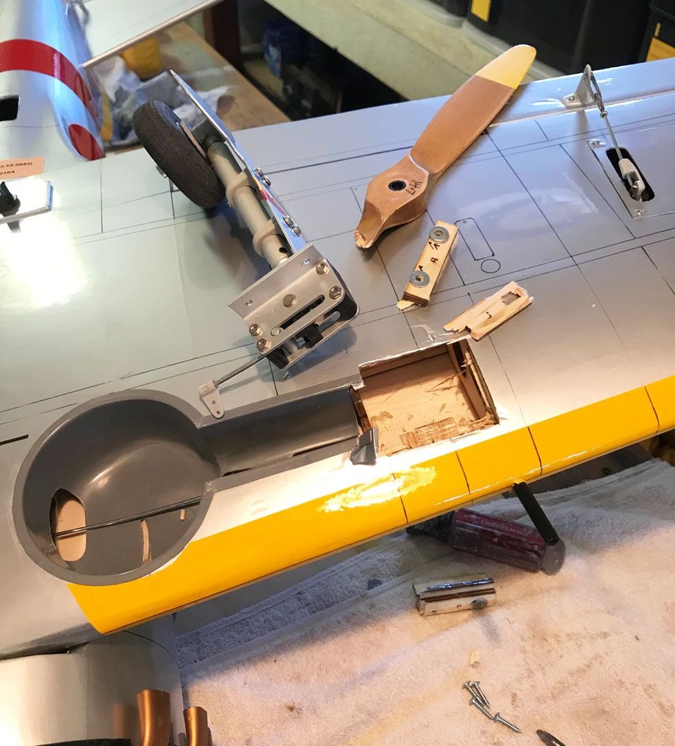

Today, after dental surgery, I am tearing into the Zero's wing for a retract repair. I opened it up through 3 bays (just like the original kit designers SHOULD have). Tomorrow I will inventory my wood supply for the new rails to hold the retract unit. I will also have to fill in the outboard wing rib which has NO meat on it at all.

The repairs are complete and I have new propellers (14x7E and a wood 14x6 for backup). I had to open up the wing and the fix is marginal. Later this week, we will see if it holds up.

The repair held up fine. However, the OTHER side broke out, and it wasn't even a hard landing. After looking at the mess, I can see why. This was engineered with several small parts glued together - except the gluing wasn't done well (typical ARF construction I guess). This optimistic engineering did not work out for me.
I have the template for the part from the previous side so it won't be too bad - a few days nonetheless.

The repair is done, other than prettying it up, which I am afraid to do lest it becomes jinxed. Tomorrow I will test it out at the field.

Four tries with the repaired gear on the Zero yesterday. The first flight was good (five minutes) but the left gear collapsed on the landing, which was not THAT bad. The unit did not pull out of the wood but the clevis popped off the retract tang and the gear folded over.
After adjustments, I tried it again - same result. More adjustment and the gear folded even before takeoff. Finally the last adjustment and I got a complete takeoff and landing, including a taxi back!
The Zero is rather twitchy right after takeoff - at low speed with the gear down. Otherwise it flies quite nicely. I am considering using less throw on ail and ele.

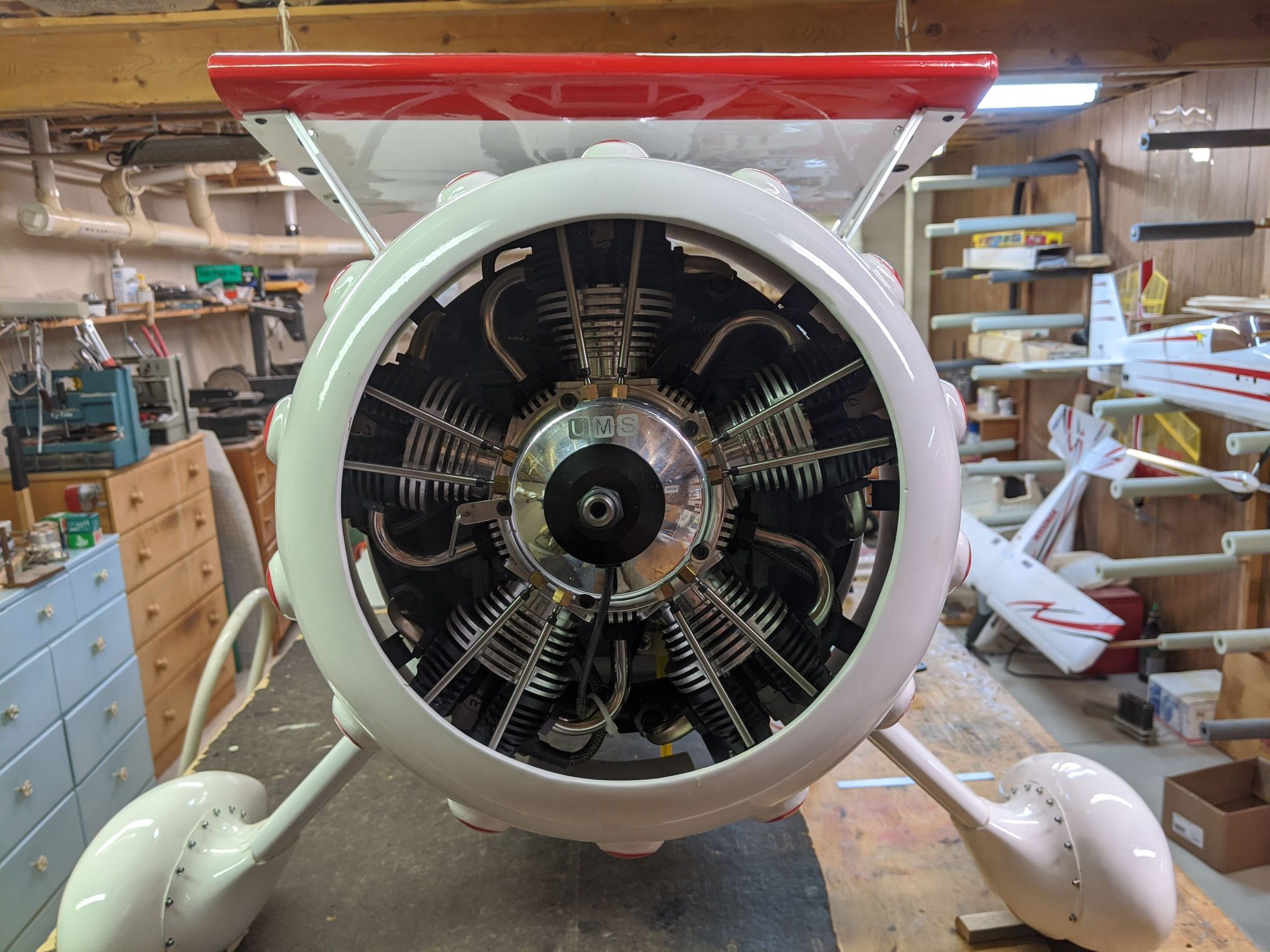

Hi Allan
What about assembling a Phoenix 60 Waco. I just bought one and mounted a new UMS 115 gas radial. My brother in law owns one with a 90 cc twin gas two stroke. He has flown his about five flights. I have just gotten mine back from a trusted full scale aircraft builder who also builds RC airplanes. I bought mine assembled and flown with an electric motor by the previous owner and assembler.
The plane has had some issues as referenced on an RCU forum. A small representative number of these Phoenix arfs have allegedly failed in flight. Un happy owners have indicated poor glue ups at the factory have lead to the failures they experienced.
I have followed your threads on the Waco and zero you have assembled
