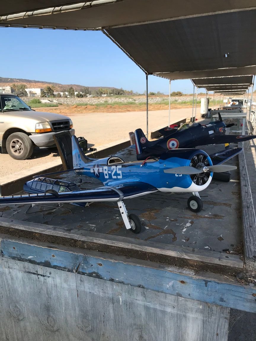

I want to open a new thread about some ARF’s I have experienced. I will start with the Phoenix Dauntless, a 59” arf which is truly appealing and very beautiful.
Reduced to one comment – DON’T.
This horrible RC plane is very attractive and quite unflyable. If you DARE get the airspeed down too much, you will be very sorry – as the pretty thing snaps violently into the ground. I do not know whether it is a wing stall, an elevator stall or a tip stall – it really doesn’t matter. The black garbage bag is due for use.
I deeply resent the four or five weeks I had wasted on this flawed piece of crap. Built completely according to the book, it comes out well over 8 pounds with battery. This wing loading is untenable – end of story.
Maybe some building genius will be able to dump a couple of pounds from the thing and make it viable. Please tell us all how you managed to do this.

I have flown other highly loaded planes over the years. Many of my own designs, especially scale, have been overweight (guess I have trouble lifting the brush when it comes to scale detail. Nonetheless, this model was very bad in the suddenness and unpredictability of its control loss. Perhaps it is the small tail surfaces combined with the tapered wings (and high loading). When it went down, the airspeed was still pretty high and the maneuver mild. Maybe with more altitude it could have been saved. Still, I want nothing to do with such a finicky model and I think people might want to know about this model's nasty tendency.
While on the subject, I would also report that the retracts are a real pain and very sloppy. The model's general fit and finish is excellent.

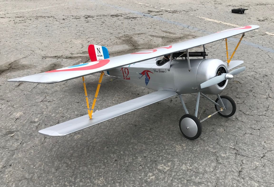

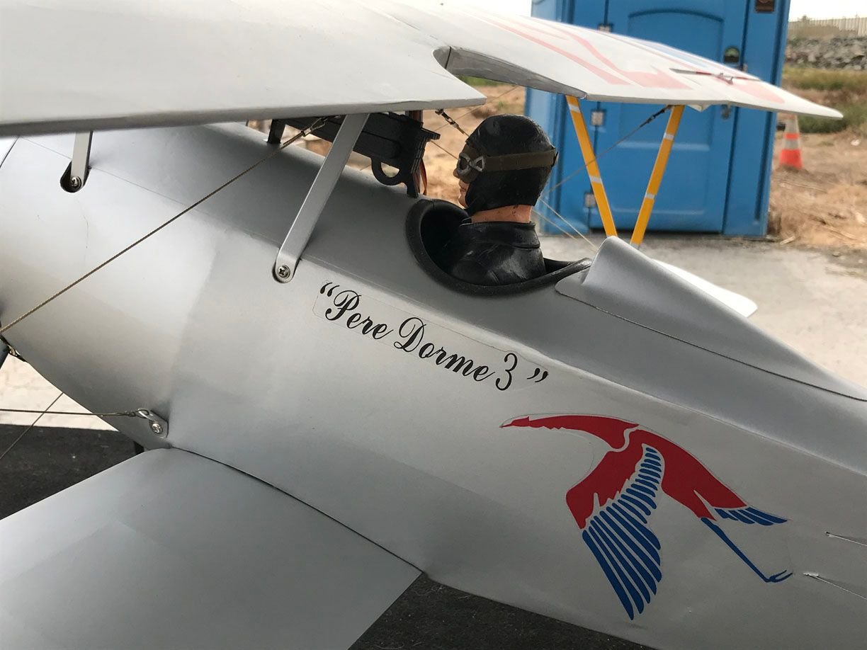

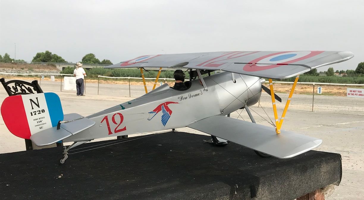

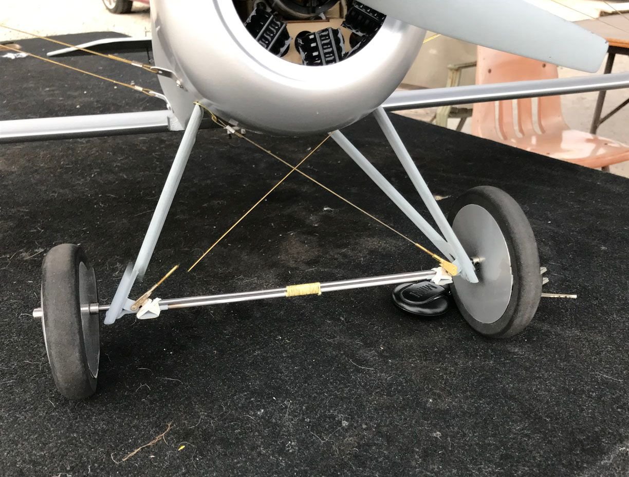

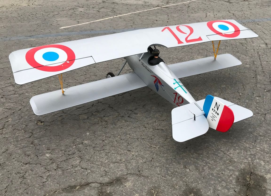

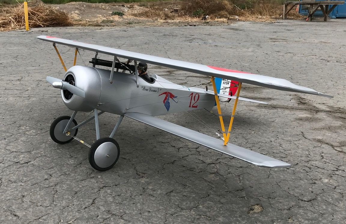

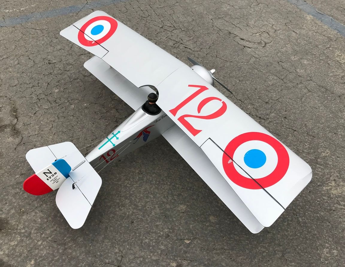

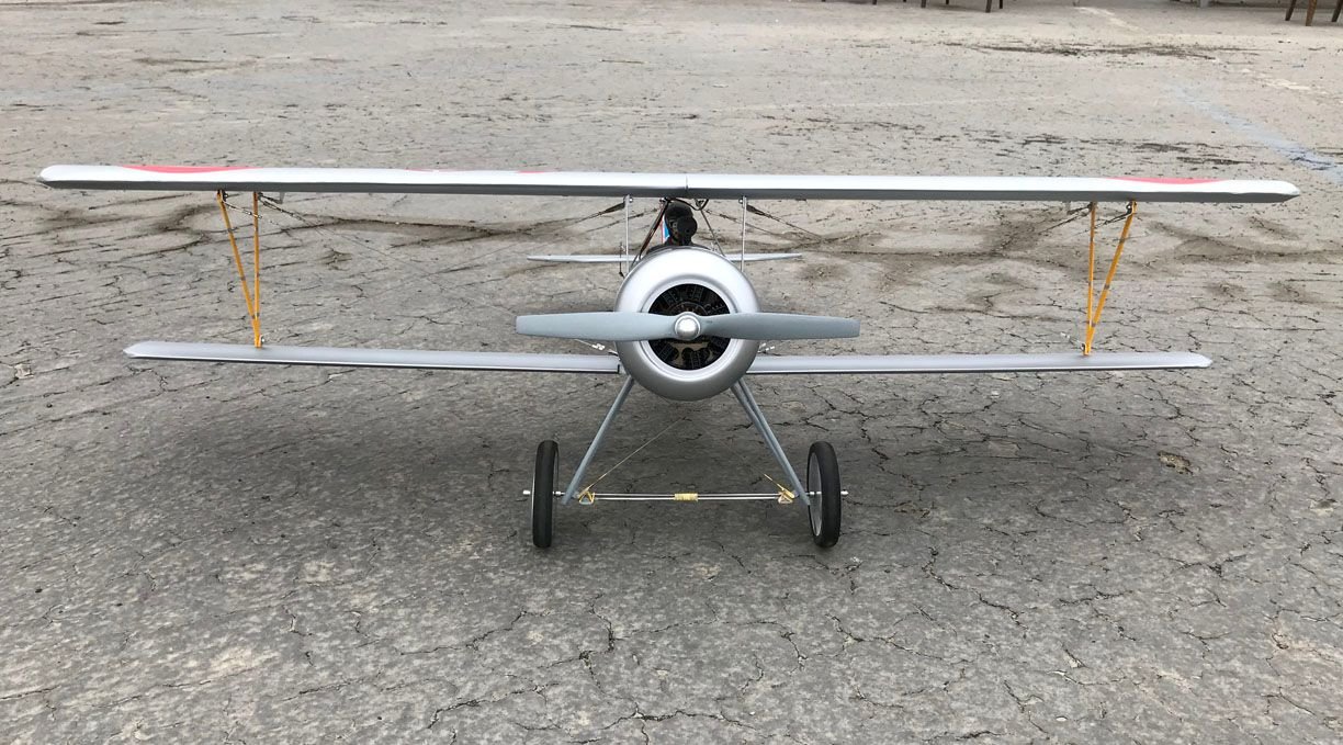

Next are some comments on the Maxford 60” Nieuport 17 - another frustrating experience, (but keep reading).
I used some old parts from a very tired and recently retired 1400mm FMS T-28. The motor, speed control and most of the servos from this post WWII plane were pressed into action for this early WW-I model. This should not have worked, at least not very well.
The frustration came from the building (“assembly” to be more correct). Fishing the rudder and elevator pull-pulls through the fuselage is extremely difficult. Anything that can be done to expedite this effort is worth the trouble. I don’t know why the designers can’t take this into account by planning a little longer plastic tubing for the lines. Also the huge, overly-sticky decals are not easy - will leave you angry and ready to trash the whole effort. If you survive these steps, you may have a chance at a good RC model.
That is if you discard all of the flawed rigging hardware provided in the box. PLEASE start over with some good Dubro/Sullivan or GreatPlanes clevises. The Chinese kit-provided items will not HOLD, even with a full 1/4” of thread engagement, which is hardly acceptable for the rigging of a biplane. This is proof of criminal culpability in my mind – although, in the end, the thing flys rather well with decent hardware - partly due to its under five pound weight (even with a 4s4000 Lipo).

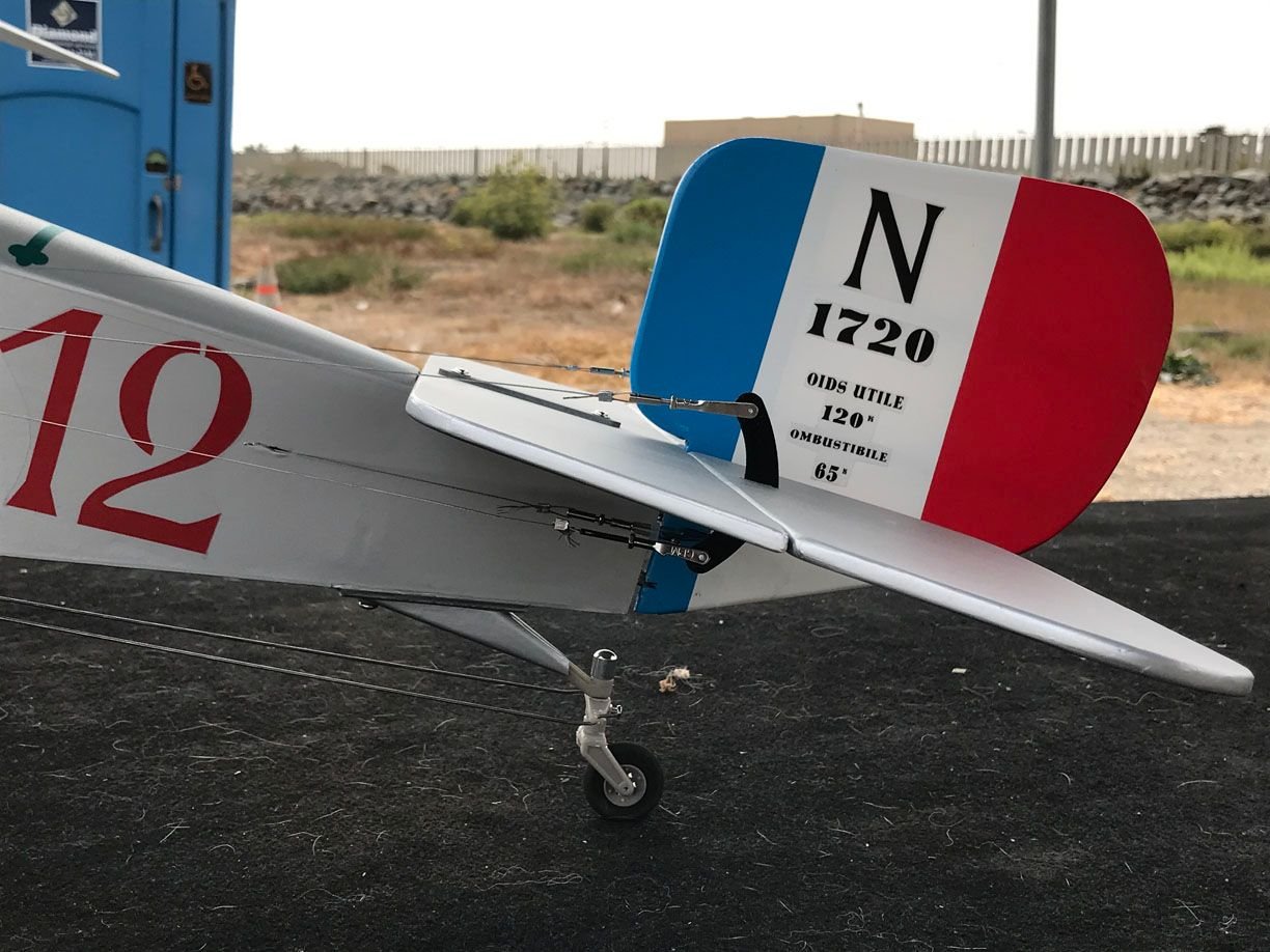

These first photos show undercarriage mods but the kit-provided tail skid.

I should correct the last post: the prop is a Master Airscrew 14-6, not an APC. Also, the plane as photographed, was before any flights and still with the flawed rigging clevises. At one embarrassing point, the model was blown off the bench by an unexpected gust, doing a little damage but, fortunately, exposing the below standard clevises.

The other thing you may want to do is deal with the WW-I scale-correct tail skid. If you are flying off dirt or grass it may work out but, if you are like me and dealing with a paved strip, you may want to bite the bullet and go for a steerable tail wheel. That is what I came to do and it is a miracle compared to the miserable wire skid. I skipped incremental steps and went straight to a separate mini-servo driven pull-pull set up using a 40 size steerable tail wheel from the local hobby store. Even with the unfavorable link setups due to having to deal with the long Maxford supplied rudder arms, using the shortest arms on the servo and the longest on the tail wheel – it steers pretty good. I would have liked less movement on the wheel (vs the rudder) but the ground handling is okay nonetheless.
The provided wire landing gear looks bad and lacks suspension. Since the wheels are way forward, a landing bounce is hard to avoid with an unyielding gear. I added wood sections on the wire for more of a scale look. The added suspension is very basic. A new axle (a little heavier) was attached at the center with some kevlar cord wrapped and CA’d to the existing wire. Some small brass plates near the ends were soldered on for rubber bands. This suspension works well and is about right in terms of “give”. I tend to go stiffer rather than too soft and this works well. I also installed some diagonal bracing wires for function and scale appearance.
Aside from the tail wheel, the plane looks good and seems fairly scale accurate. I love the size of the model (large and easy to see) and the size of the historic plane (tiny and personal, even intimate). Not being a very skilled pilot when it comes to using the rudder, I programmed in about 20% rudder-aileron mixing and this helps. Being a bigger model than I am accustomed to, it needs a bit of space to make the turns. The motor and speed control from the T-28 (a 56” foamie monoplane) is plenty strong and gives reasonable confidence with a two blade Master Airscrew 14-6 prop. I haven’t seen any tendencies toward tip stall but, at this light wing loading and with the wing configuration, it would not be expected. Nor is any Dutch Roll evident which is good because I am using an old Rx and aileron differential is not so easy.
Initially I passed on the Maxford product because the price gets up there fast with any options. Using parts I already have for major components made it more palatable for me. I did get the optional machine gun. With about six flights on it, things look good for the Maxford N-17.

One further note: The wheels and tires provided are nice looking but may not hold up. On the first taxi test, one tire started coming off. I redid them with some epoxy to keep the foam in place. There is no rim on the wheel to help keep things in place.
Since then, they have functioned okay but I will be holding my breath. Wheels this size are hard to find.

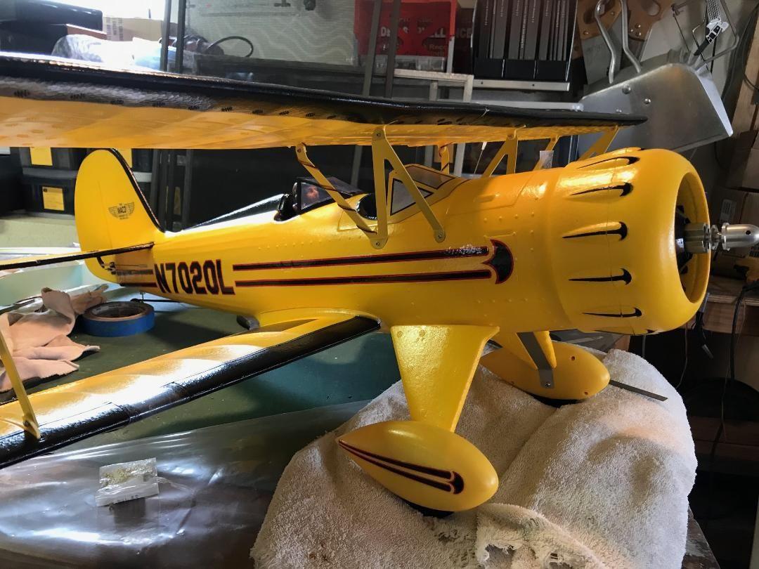

I have got more into this project, after repairing the tail section which was distorted.
The cabanes were raw metal and the wing struts were black. I painted them yellow which I think will look better and more to scale. Also, I painted everything with Pledge Acrylic Floor Finish (same as "Future") and it makes the color much richer and now has a bit of a sheen. This also helps seal down any tapes or decals.
I also made a Waco sticker for the wing rather than use the Dynam one. It is just printed on label paper and is a bit wrinkly.

Here are two progress photos of the Waco. I won't drag everybody through the obvious build traumas (struggles with hardware, lack of decent instructions, etc.). So far, however, I like this model. Hopefully when the battery gets here late this week and I can balance the plane and go for a maiden.
